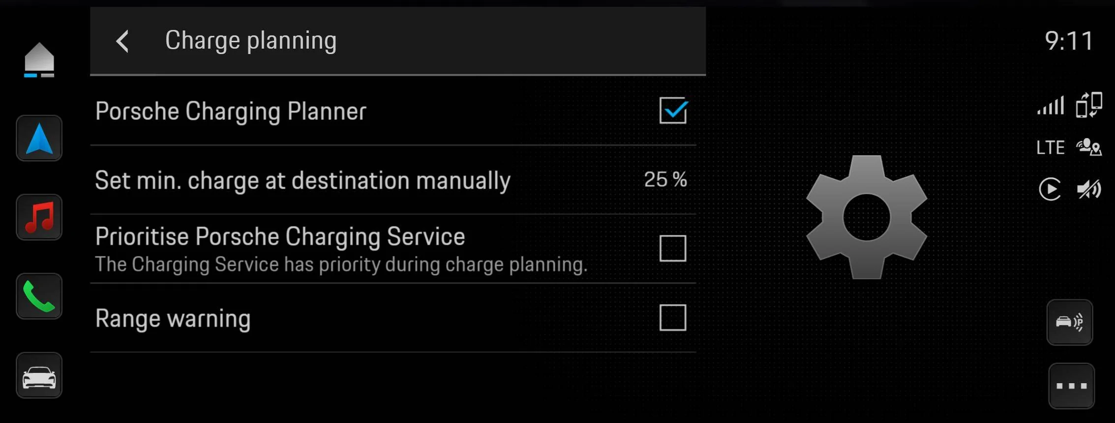

The My Porsche App does this for departing state of charge and the PCM lets you set the minimum arrival charge at destination.
Porsche Taycan Charging route planner advice 1663927221723
HPC chargers are then identified along your route as needed OR you can add your own stopovers (charging stops) and filter the type and speed of charger you want.

It doesn't offer all possible options but will offer those which have a contractual relationship with Porsche - Ionity, Porsche Marketplace (dealerships), Osprey, others. By no means perfect (yet) but the functionality is there.
Much better to plan the route on the PCM and add your own stopovers where you can choose (and easily filter) pretty much any and all providers. This will also incorporate pre-conditioning (less relevant now I think with uPdate). Selecting a listed DC EVSE on the app would also provide pre-conditioning (of course).

Simply select an EVSE which is DC and 50kW or greater (no pre-conditioning for AC charging) and and add as a 'Stopover' in NAV - the rest is automatic and will pre-condition as needed (heat to 32C) for arrival.
Details for EVSEs (AC & DC) will be listed in NAV or you can search - the software will provide details of any selected and the title generally gives you the rated capacity etc.
Really simple and no drama.
