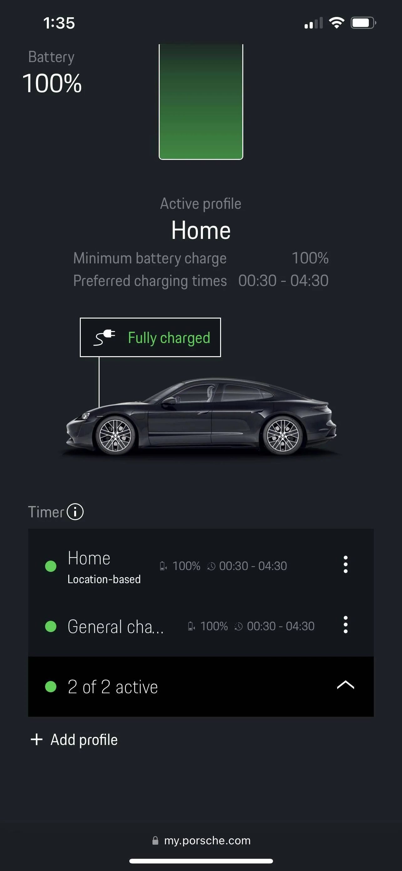

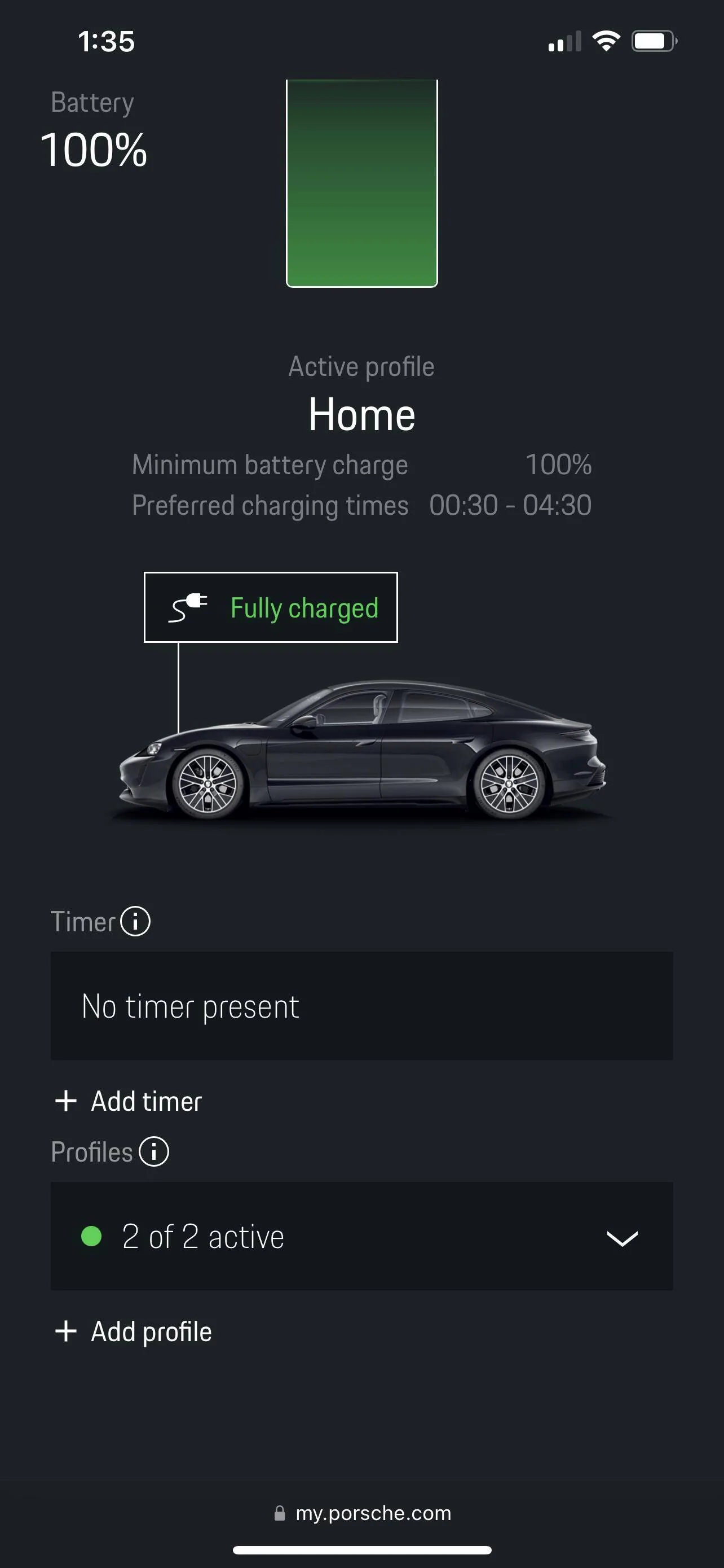

Hello
Thanks for the reply - Sorry i didn’t
fully understand ?
yes I have set a preferred time
I have a cheaper night time tariff from 12.30am -430am and would like to only charge in these times.
You said switch to a time
However The timer option doesn’t allow a “range” of time slots for charging but only a destination time - so that wouldn’t work ?
Also on the profile section what is “general charging “ home charging I understand
I have attached as you have my current profile
thanks in advance

timers take priority over profiles
Timers don’t take priority. They are additional, separate instructions that can be used with or without profiles.
Min charge in the profile charges to that value immediately.
You should delete the profile and set a timer to whatever you want your max SoC to be (e.g. 85%) and set the departure time to 4:30am. It was start charging relative to the 4:30am.
You might be able to also set a 2nd timer to 12:30am @ 25% SoC to limit the charging start window. I'm going to test that later today.

It's really quite simple
Set a daily timer for the main time slot and a minimum charge level in a profile of 25%. Activate both the timer and profile.
To add additional time slots add further timers and activate.
Read the owner's manual and / Porsche Good To Know App or search this forum as we have discussed this topic to death over the last 2 years.
