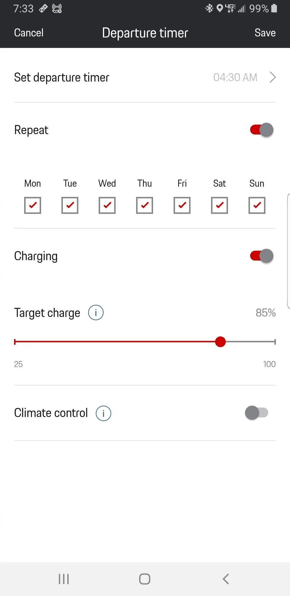

For the first 9 months that I owned my car I used a Timer profile. I had it set to be charged to 85% everyday for a departure time at 4:30 am. When set this way it did not exceed 85% and usually started to charge late at night since it calculates the time required backwards from 4:30 am.
Here is a screen shot of the Timer profile.
Porsche Taycan Charging to 85% Regularly between 00:30 & 04:30 Screenshot_20210304-193357_Connect

Don’t set minimum charge to 85% as that means you want the car to have a minimum of 85% charge before taking into account any profile or timer you have set (which is not what you want). So if you connect the charger to the car when it has 50% charge it will immediately start charging until 85% was reached regardless.
To achieve what you want use the Timer as (shown above) which works 100%. You can go further and pre-heat / cool the car if you want but sometimes better to programme this separately if you know you are going to use the car at a certain time (this uses the climate control in conjunction with heated seats to achieve the desired temperature).
I use a Profile (Location set to home address, Minimum Charge 25%, Preferred Charging Times (your off peak / cheap period) and a Timer (Days of week, Charge, 85%, no precool/heat)
