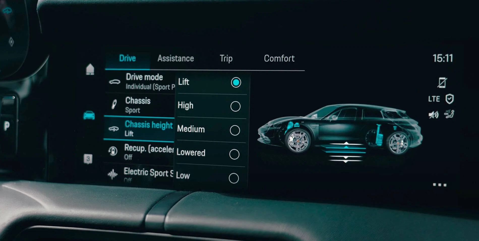

What is “lowered” in the diagrams? I don’t recall there being four different air suspension settings when driving the sedan.
There are four different settings. In Sport you are in lowered, in Normal you are in medium and in range mode you are in lowest. High mode is only used to clear obstacles up to 30 km/h. Over 30 km/h, it lowers down to original setting automatically.
