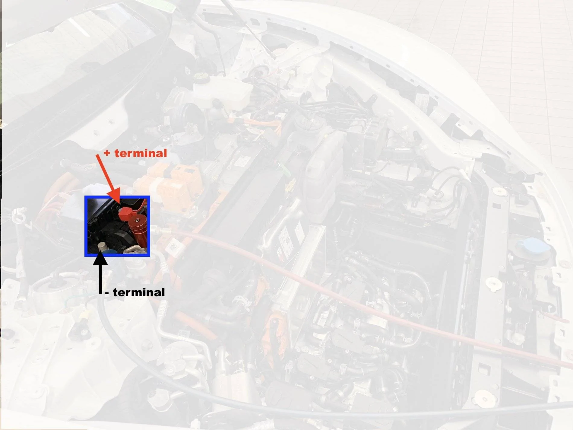

And those are where exactly?
Both are under the cover in the frunk. Page 287 in owner's manual. The positive jump terminal is nearby the battery with a cover on it. The negative is further towards the passenger side of the car away from the battery.

thanks to another thread we have a great photo of a "bare" Taycan front end (wow it's soooo complex) - I've modified that photo and highlighted just the "jumper posts" as requested by some on this thread…
see photo below - the blue highlighted box is the location of the two posts you would use to "power" the 12V system for the vehicle - red = positive, bare-silver-metal = negative
