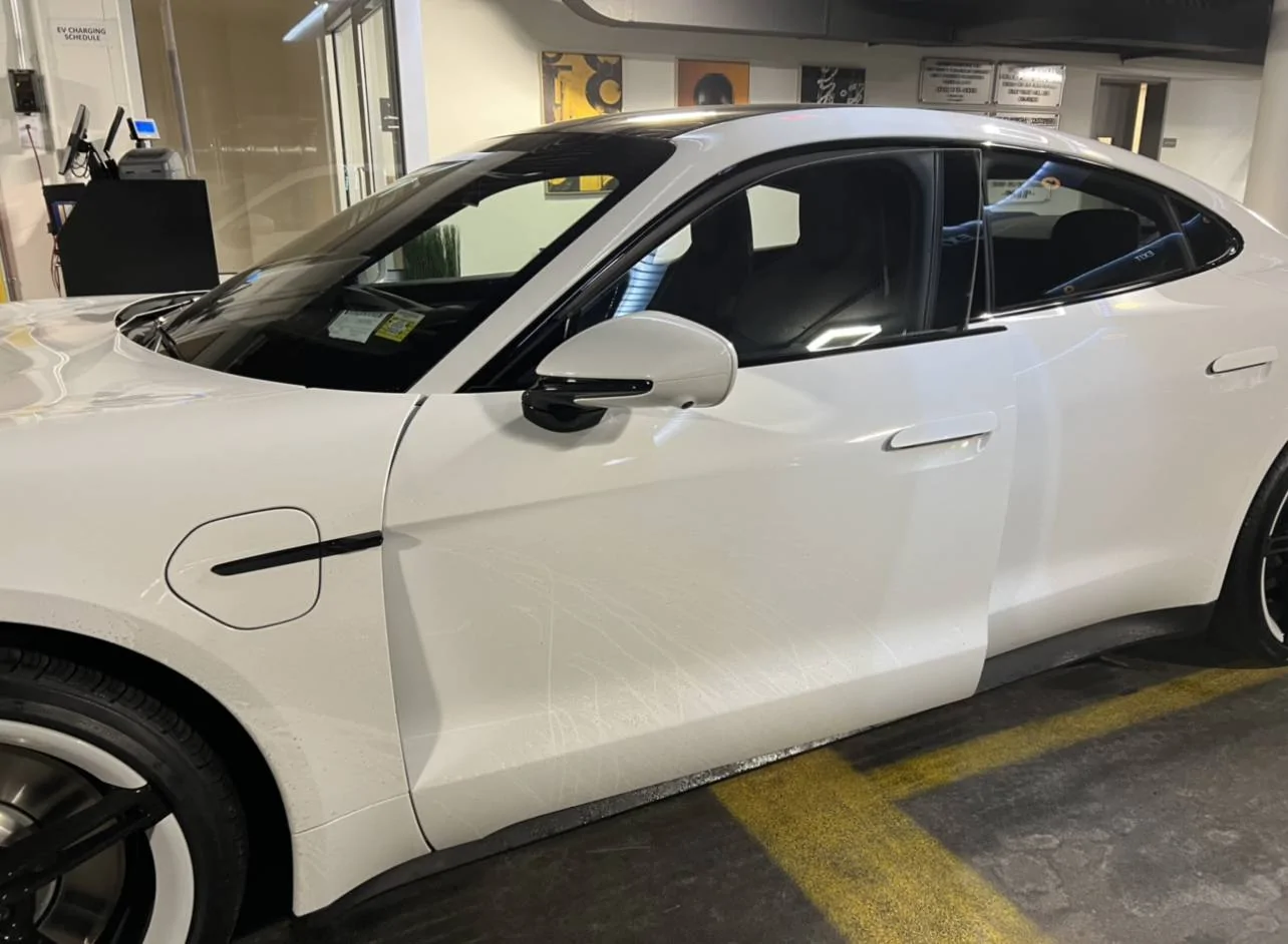

I’ve never cleaned cars and haven’t owned one for a decade, since I moved to NYC. So I feel I have a lot of anxiety regarding it - more than ev charging! So sorry for the barrage of Q’s but I see a lot of enthusiasts here who go the extra miles to maintain their cars. The people i know either go through drive through - auto wash or just don’t mind water spots.
White carrera white with mission e : It has full PPF & Ceramic coating (Xpel Fusion)
1- My car has a bit of dirt on it, since I brought it back form the PPF service. There’s snow here - so you can imagine. Ceramic was done on friday and I brought the car on Tuesday. Do I hand wash (full wash on sunday), or should I try to atleast rinse to get the mud off ?
I was told it’s better to leave it dirty and do a full hand wash than just rinse as it would leave water spots.
2- Pressure washer or 2 buckets ? what does everyone suggest. what is better for the car ? for rinse and for shampoo ?
3- I won’t take it to an automatic car wash. My choices, hand wash myself at a friend’s place using the 2 bucket system or pressure washer, sonax soap and mitt and drying cloth from (chemical guys). then put the xpel spray over. Or get it hand washed from one of the detailing places ? Ask them to use my supplies ?
4- The company that did the PPF suggested not to use the rinseless stuff, which many on this forum suggested, if living in urban areas.
Many thanks !
this is the current state :

My car is also full ceramic. Unless there are bird droppings, leave the dirt and do a two bucket wash or a foam application of soap and single additional bucket. Any car soap will do, you can check out www.griotsgarage.com they have an excellent lineup. If the Ceramic manufacturer has soap, you may want to use it, I have Feynlab ceramic, so I use their soap, works great.
If you have bird dropping, buy some Speed Shine and use a bit to just get off the bird dropping in between washes, so it doesn't etch the ceramic or paint.
Beautiful car, use it well.

That’s it - you’ve triggered the detailing enthusiast inside me!
Here’s a video I did a couple of years back when guys asked me about the benefits of a car dryer. Key steps are here - I would only change a couple of products to care for your ceramic coating (I applied Gtechniq to my other car and use the refs below)
1. Pre-wash with pressure washer (just to remove salt / dirt etc)
2. Foam lance - I use either Gyeon or Gtechniq (needs to be pH neutral for your coating)
3. 2 buckets with NXT or Gtechniq shampoo and microfiber mitt - one with soapy warm (loosen up / dissolves dirt better) water and other with clean warm water to rinse the mitt off between panels
4. Rinse with pressure washer (don’t need full power if 120+ Bar)
5. I now use spray on wax to boost protection - Autoglym or any other is fine, very diluted in foam lance)
6. Final rinse
7. Drying - I’m using a blaster to avoid swirls but 2-3 large fluffy towels work too (I have a Water Magnet but found it a bit harsh so only using for roof / glass)
Given your level of dirt I would wait for full wash
I only rinse when I have lots of corrosive salt in winter and only at a petrol station where they have “finishing” rinse with deionised water to avoid spots.

Regarding when to wash, a new coat of ceramics should get some time to harden. Let it be dirty, don’t wash for a couple of weeks. What you do for the rest of the cars lifetime is more important than these two couple of weeks.
