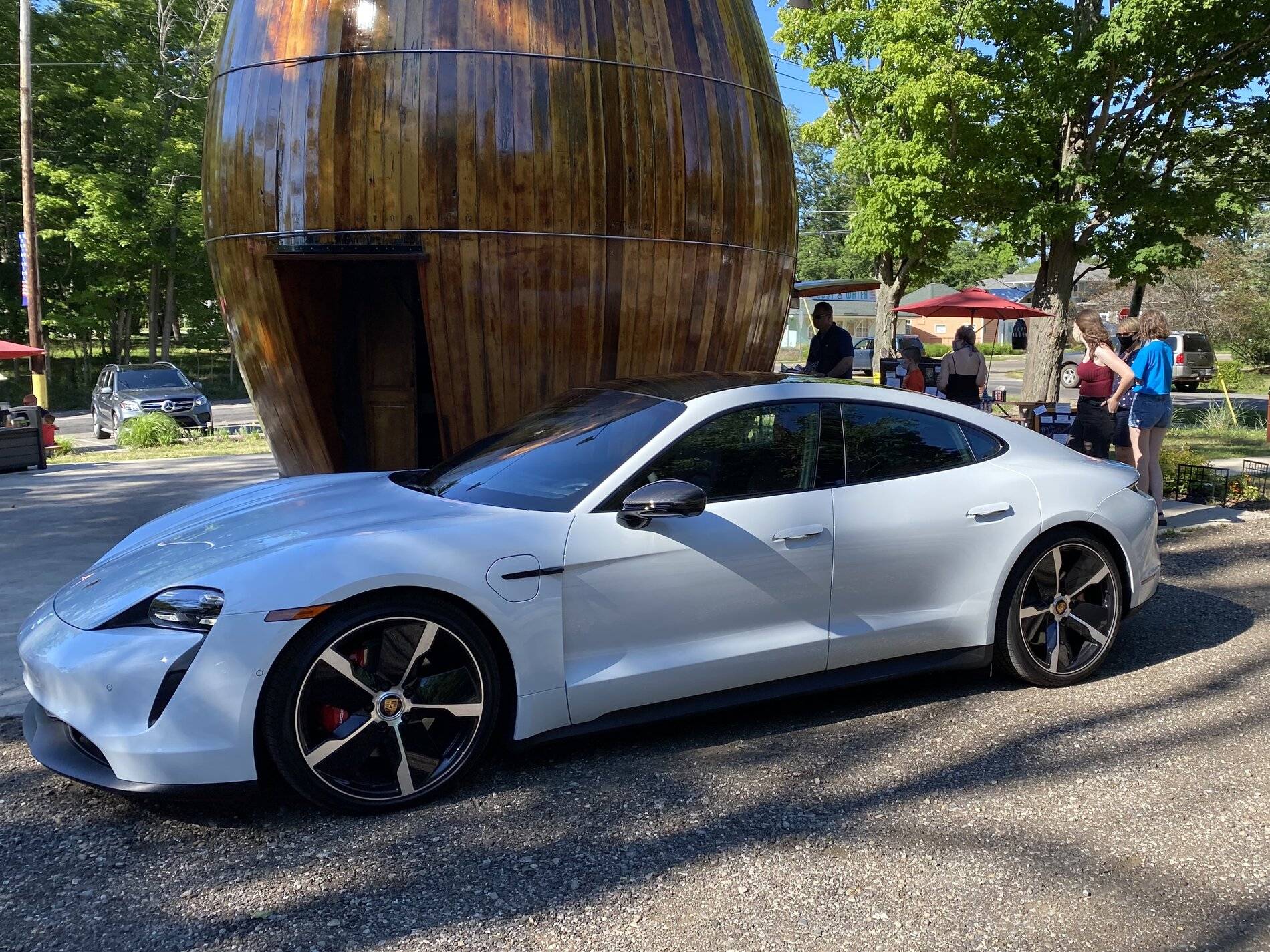

I am thinking of doing the whole car. Not sure I like the idea of doing it half way. I've done ceramic coating before, not PPF, so I don't necessarily know what I am doing ;)
I did the whole car and it’s great! Cleaning is so much easier too...

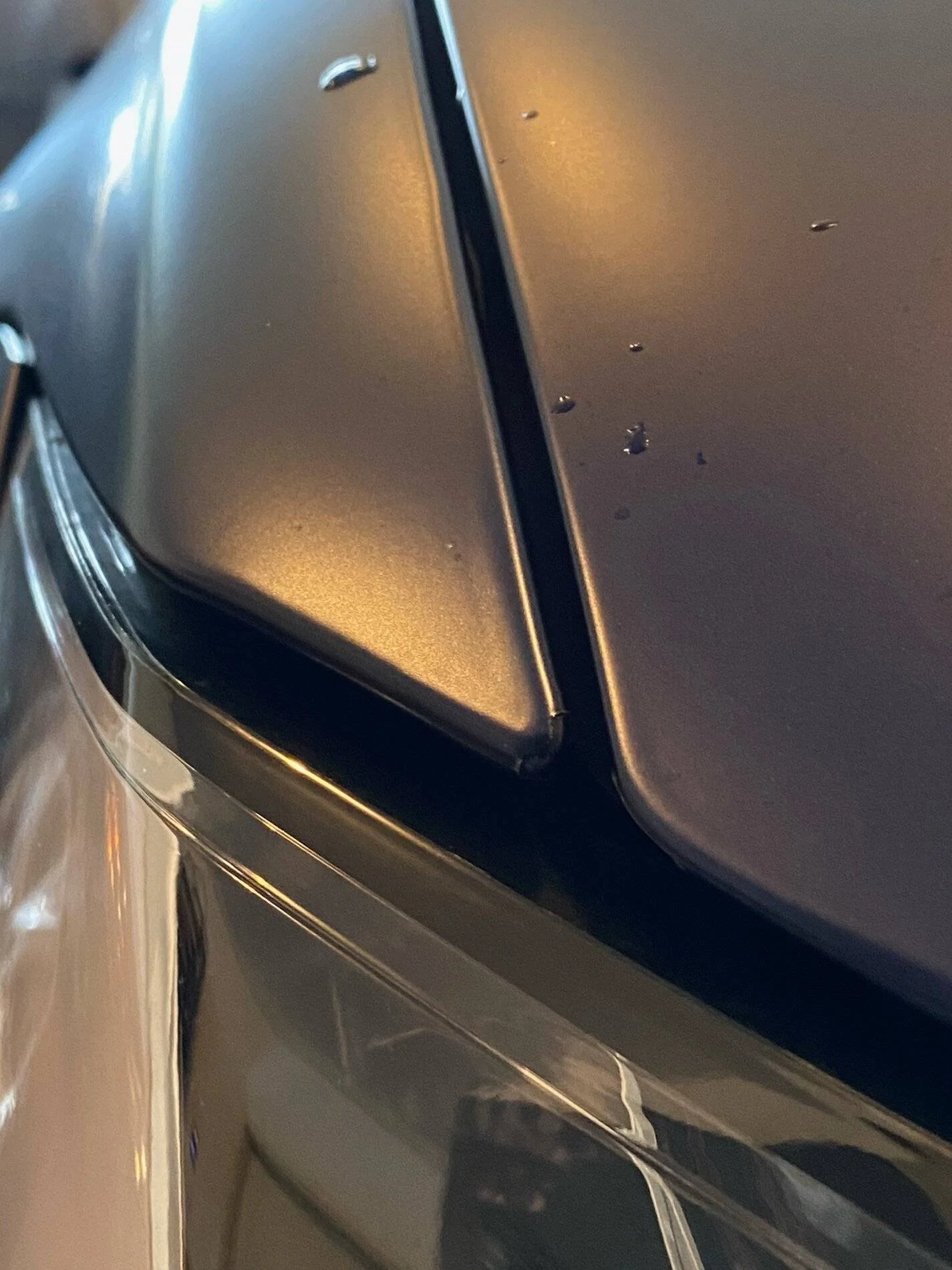

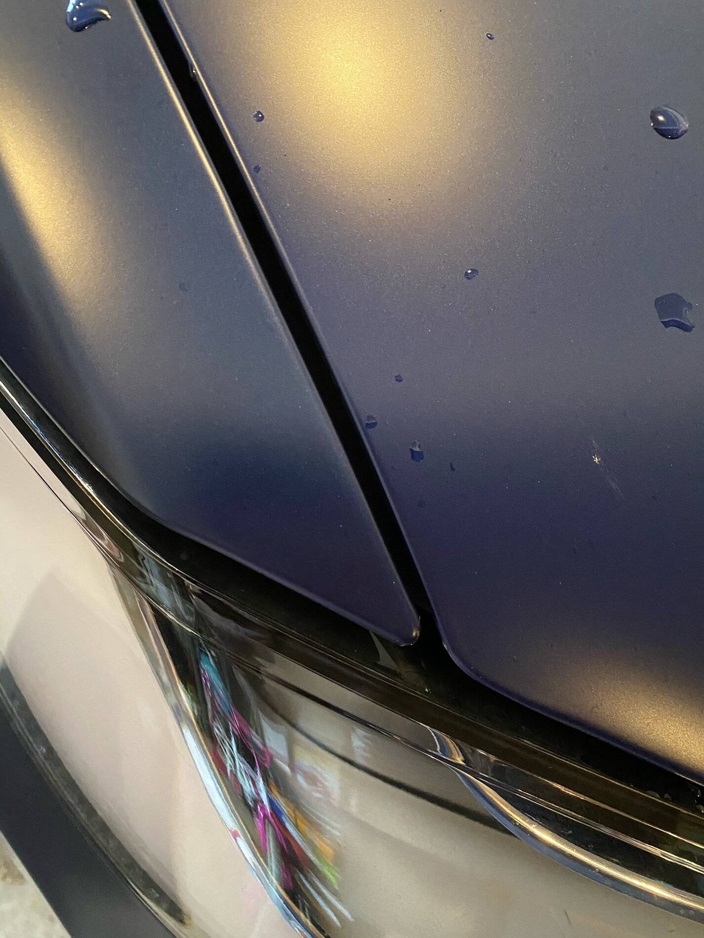

I just did xpel PPF on full front, mirrors, and doors... and full ceramic on car and wheel faces. Looks amazing, and I know it will stay protected for the most part. I've done this with most of my cars and don't regret the investment to ensure my vehicles always look great.

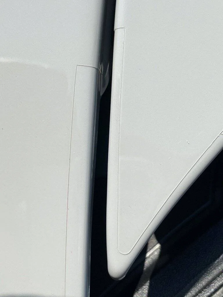

I would also like to get full PPF. I stopped by the local dealer to look at a 911 they had with full PPF. I noticed that the film did wrap around the straight edges but the corners did not. I can understand why that is but I thought I would just check with those here that that is a normal limitation of PPF. Included is a photo of some corners.
I suppose the other options is PPS, has anyone here done that?
Thanks

That really looks like it could have been done better.

PPF doesn’t ever wrap around the sides - and that makes it much easier to install and to replace. No panels have to be taken off, etc. In reality...from a few feet away, you cannot really see the PPF edge unless it catches the light just right. Even then, it’s not a big deal. But...a good installer will get the PPF closer to the edges. I really like the results of mine and the fact that it is sooo easy to clean let alone protect against chips.

I think this is going to be specific to the installer... I agree that it could have been done more completely. Some installers will be much more skilled at this than others.

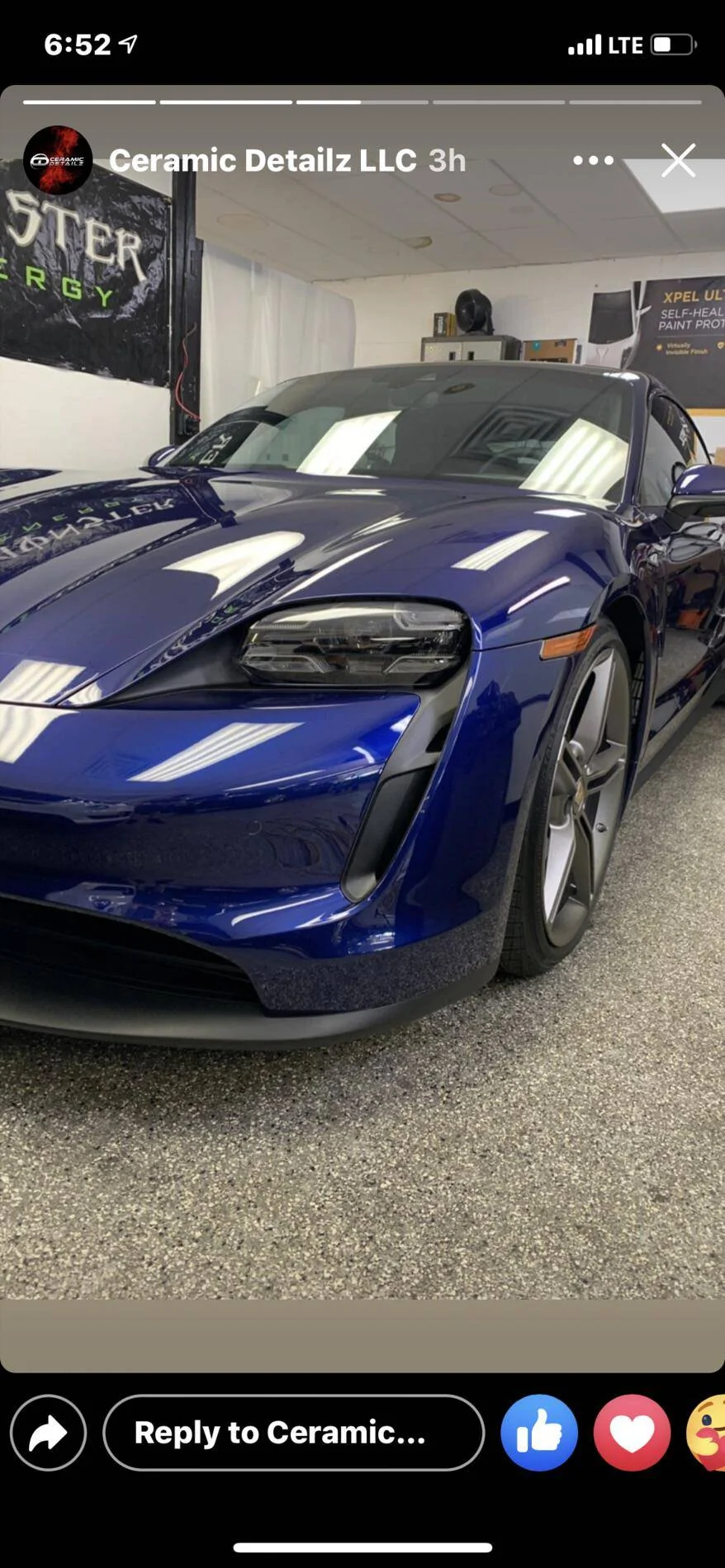

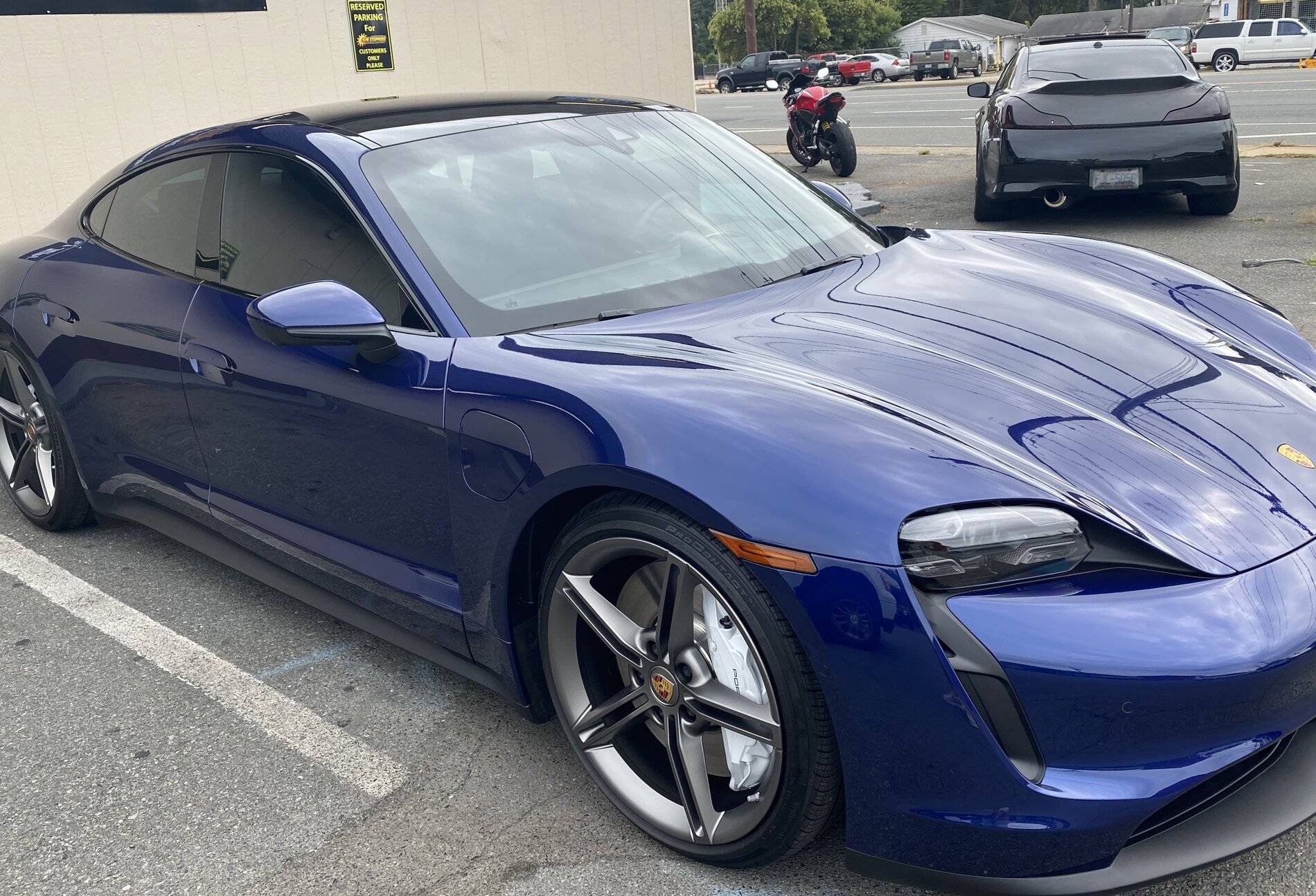

For reference, since my Taycan PPF is in progress, here is an example from my Model X... you don't see the PPF stop short on any of the straight edges. Only on some sharp corner points, if you look very closely, do you see how the corner was not wrapped 'on' but 'around', likely because the PPF would form a folded point of material if you didn't.

I have had PPF on the majority of my cars. I would not be happy with the example in your post. Most installers use precut, computer generated templates that the installer can tweak a bit to allow them to either wrap around the edges on areas like the hood, doors, trunk or to get right up to the edges on the other panels. If done correctly, it should be very difficult to see any of the edges. You should not be able to see the edge before you can feel it by touch. The job in the photo looks like a get in/out fast job. I really want to try the Paint Protection Spray, but currently in the US there are only a handful of installers. There are two forum members who have had PPS and it looks great (including the ability to cover the plastic bits that will not accept PPF or a wrap).
