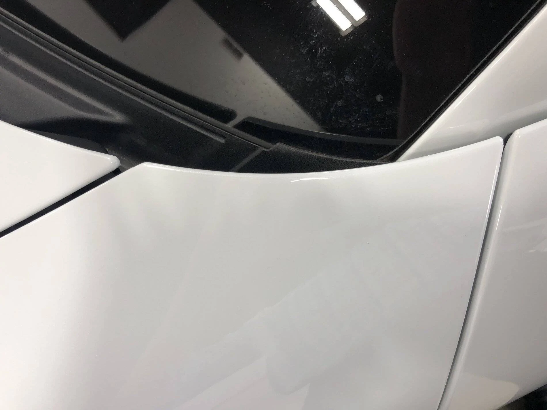

Just a preliminary shot during the work of some of the seams using Xpel on the front hood and fenders. The whole body will be wrapped with Xpel, and the mirrors taken off and wrapped with a more flexible gloss black vinyl with a bead of gloss black silicone in the mirror 'channel'. I'll post pics when I get these back. You can see that at the very apex of some panels there is a slight mismatch where the film is precut and cannot wrap around the severe angles. Otherwise the seams are very close.
