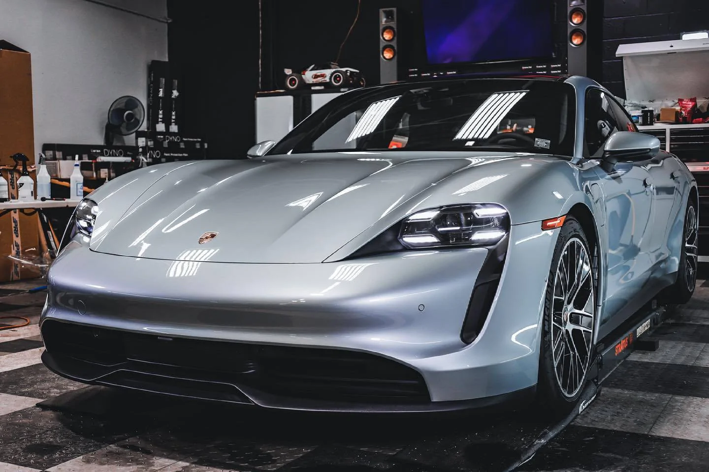

Xpel Ultimate full body coverage with Gtechniq HALO and STEK windshield film.
How much did you pay for the full body coverage PPF if you don't mind me asking?
Car looks stunning!
Car looks stunning!
Thanks! 5K - included ceramic coating and windshield film. Wrapped edge bulk install.

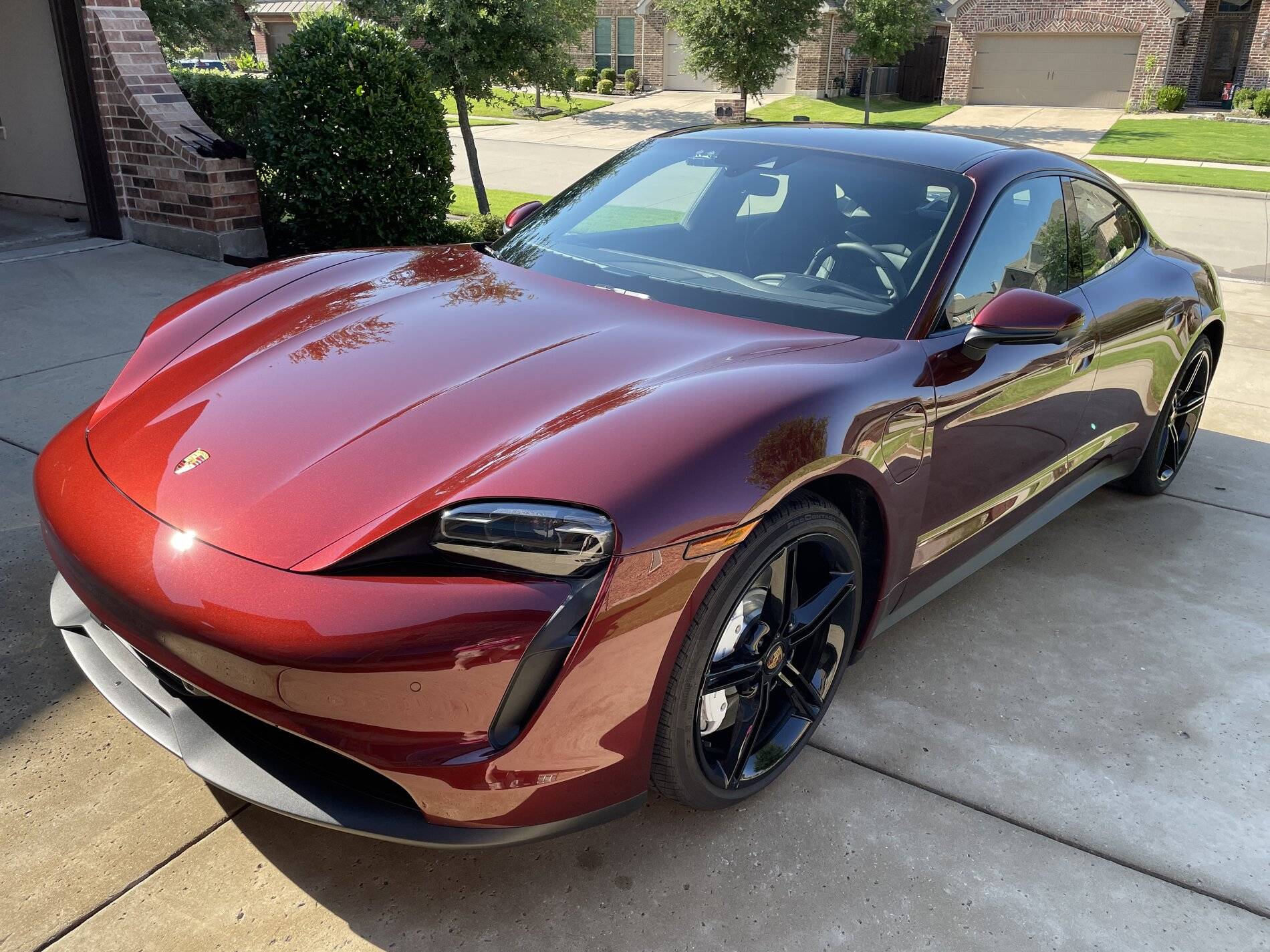

I did PPF on '21 Taycan Turbo S and also ceramic.
https://www.autopaintguard.com/gallery/
Also tinted....if anyone in Tampa Bay Area highly recommended. Not affiliated other than a customer...Top notch but expensive but worth every penny with quality and professionalism...Taking my 911 Turbo S there in few weeks also...
