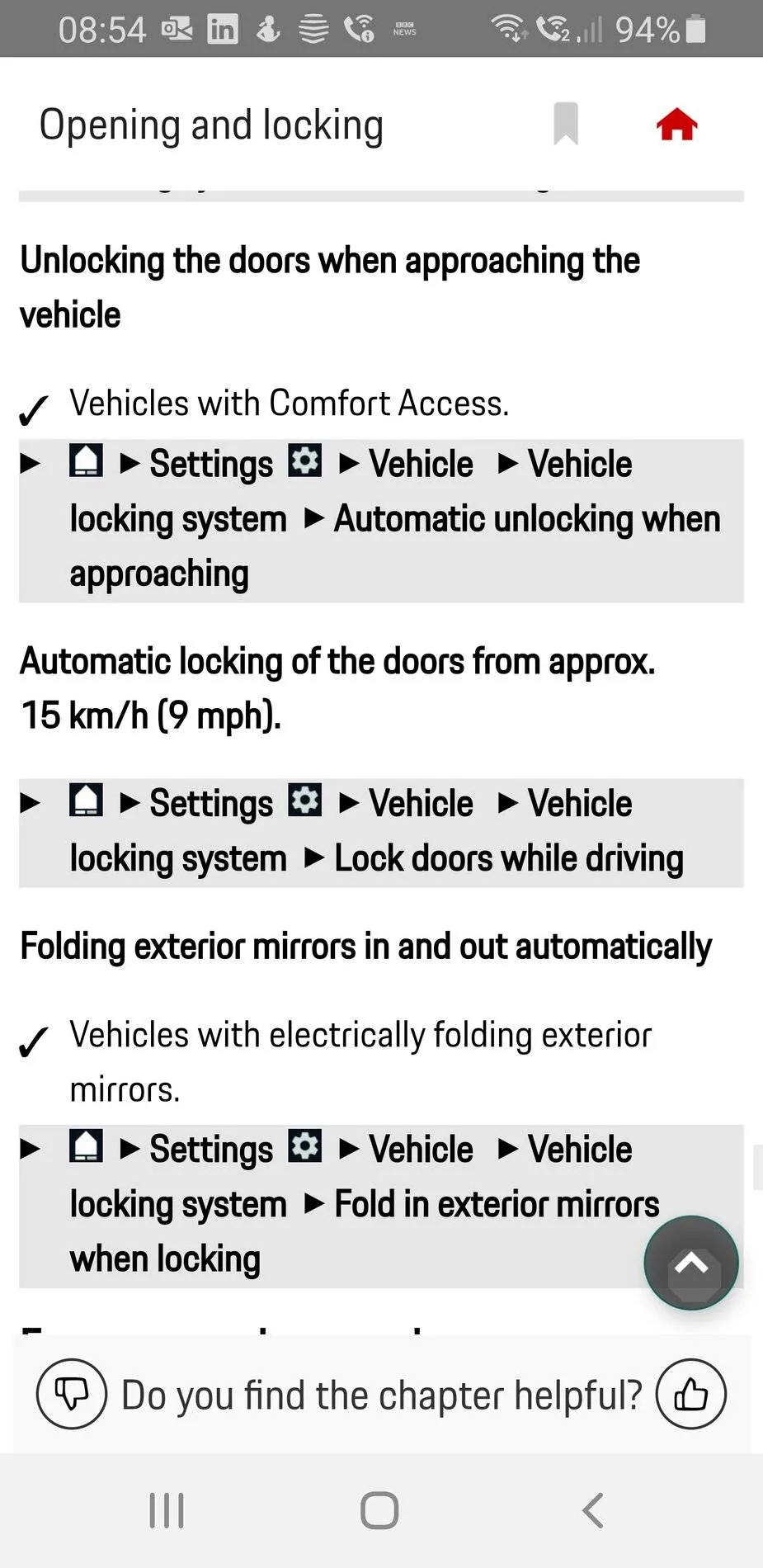

Have you completed your Porsche Connect ID setup and logged into the car via PCM (this is a one time task). Comfort settings are stored with your Porsche Connect ID. If you are relying on the Guest account then likely the comfort features are disabled.
From the Porsche Good To Know app:
Porsche Taycan Comfort access not working Screenshot_20210222-085425_Porsche Good to know
