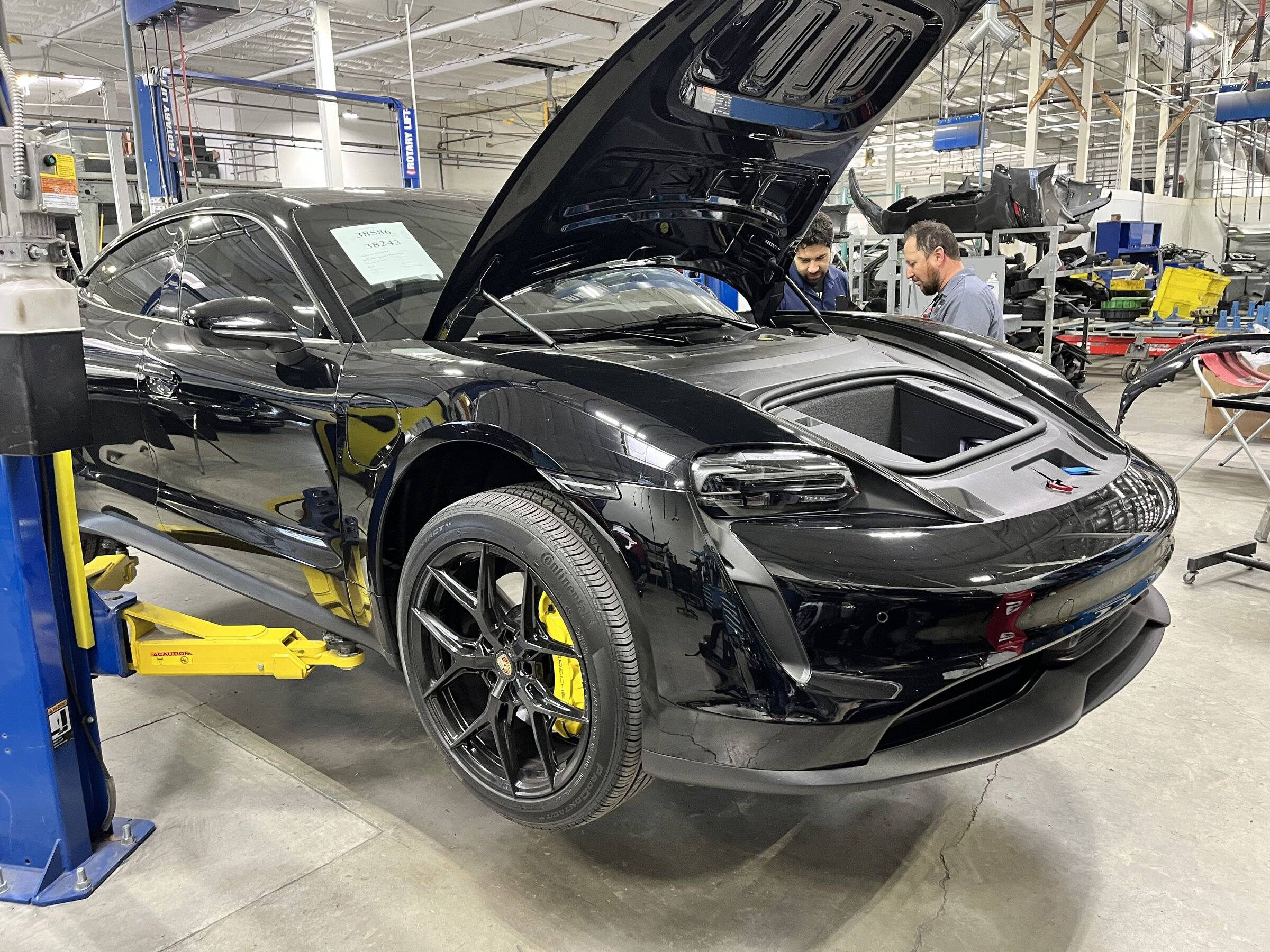

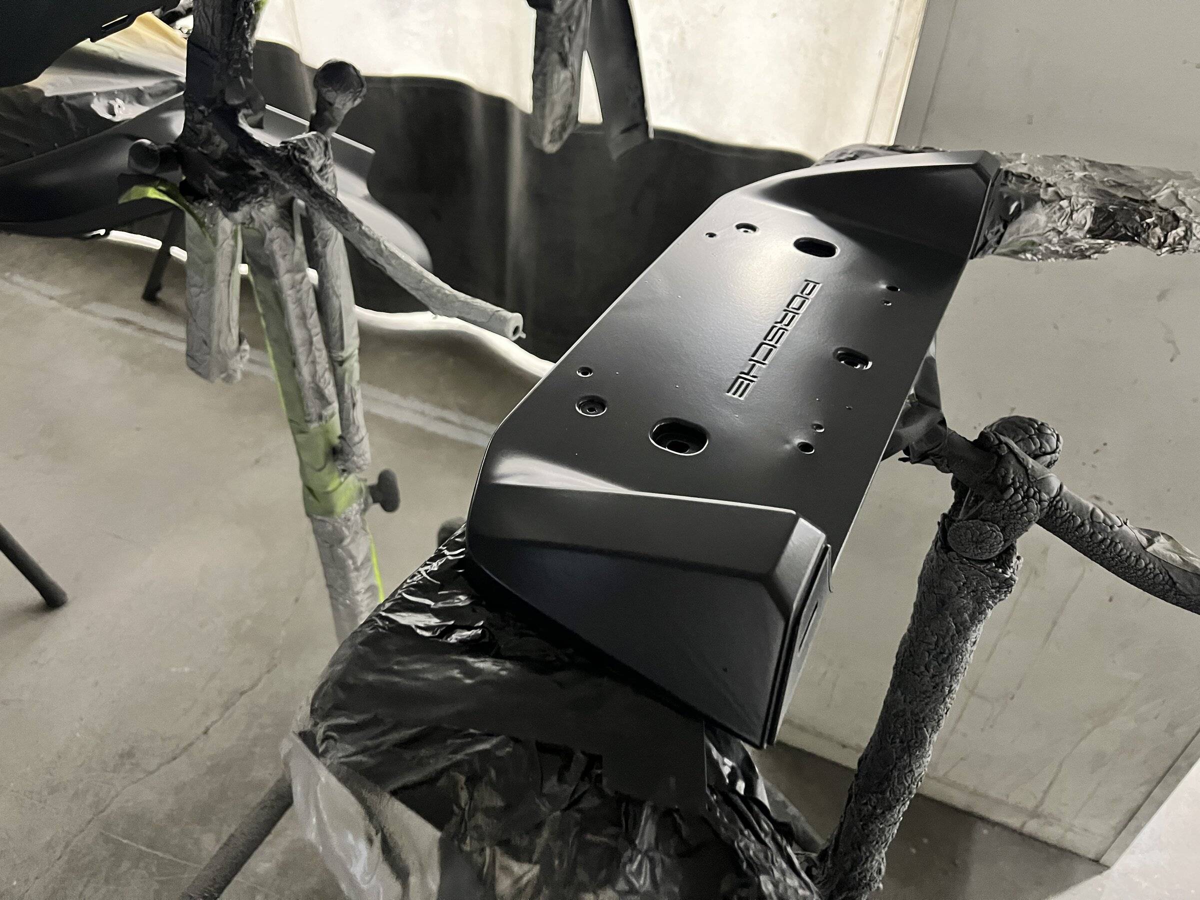

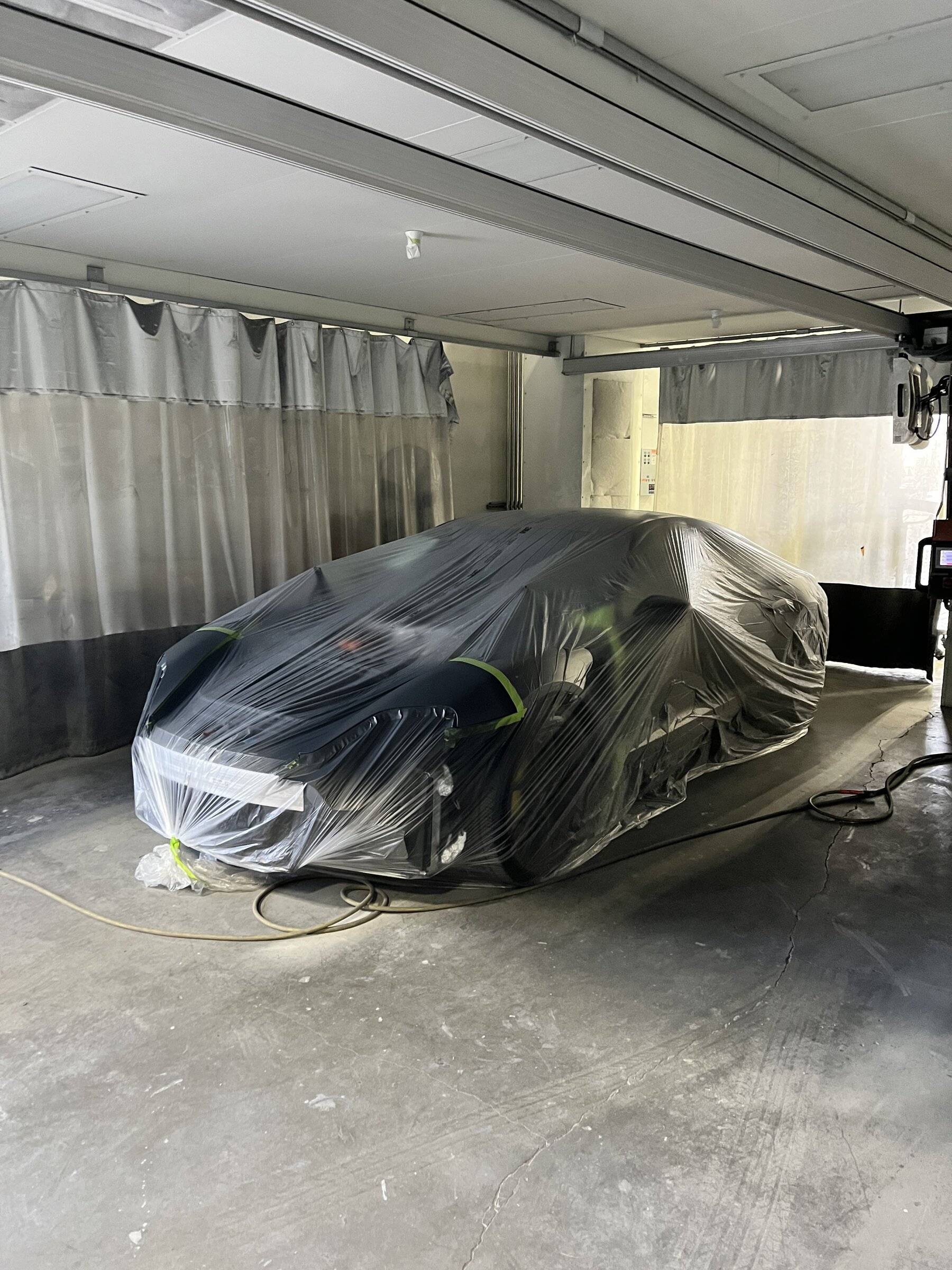

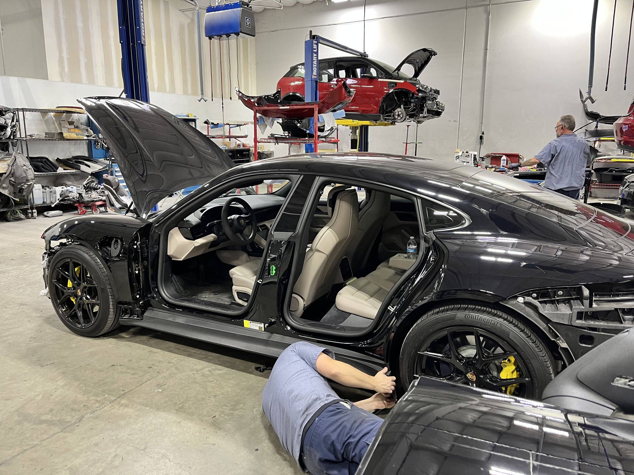

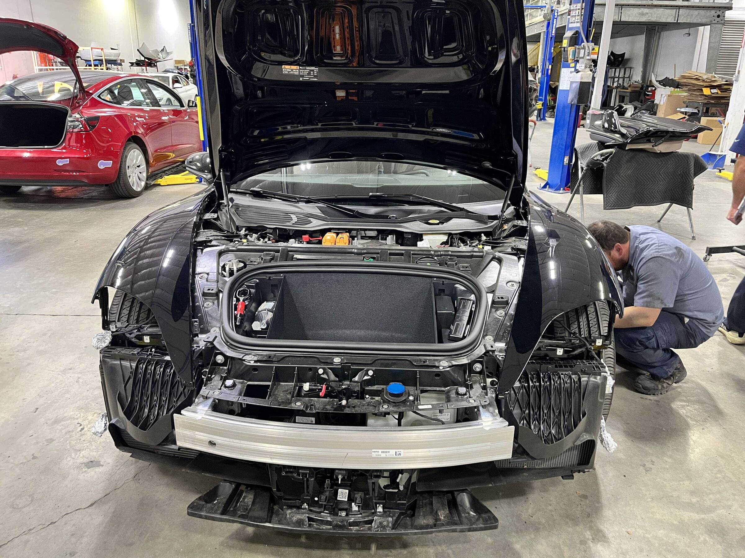

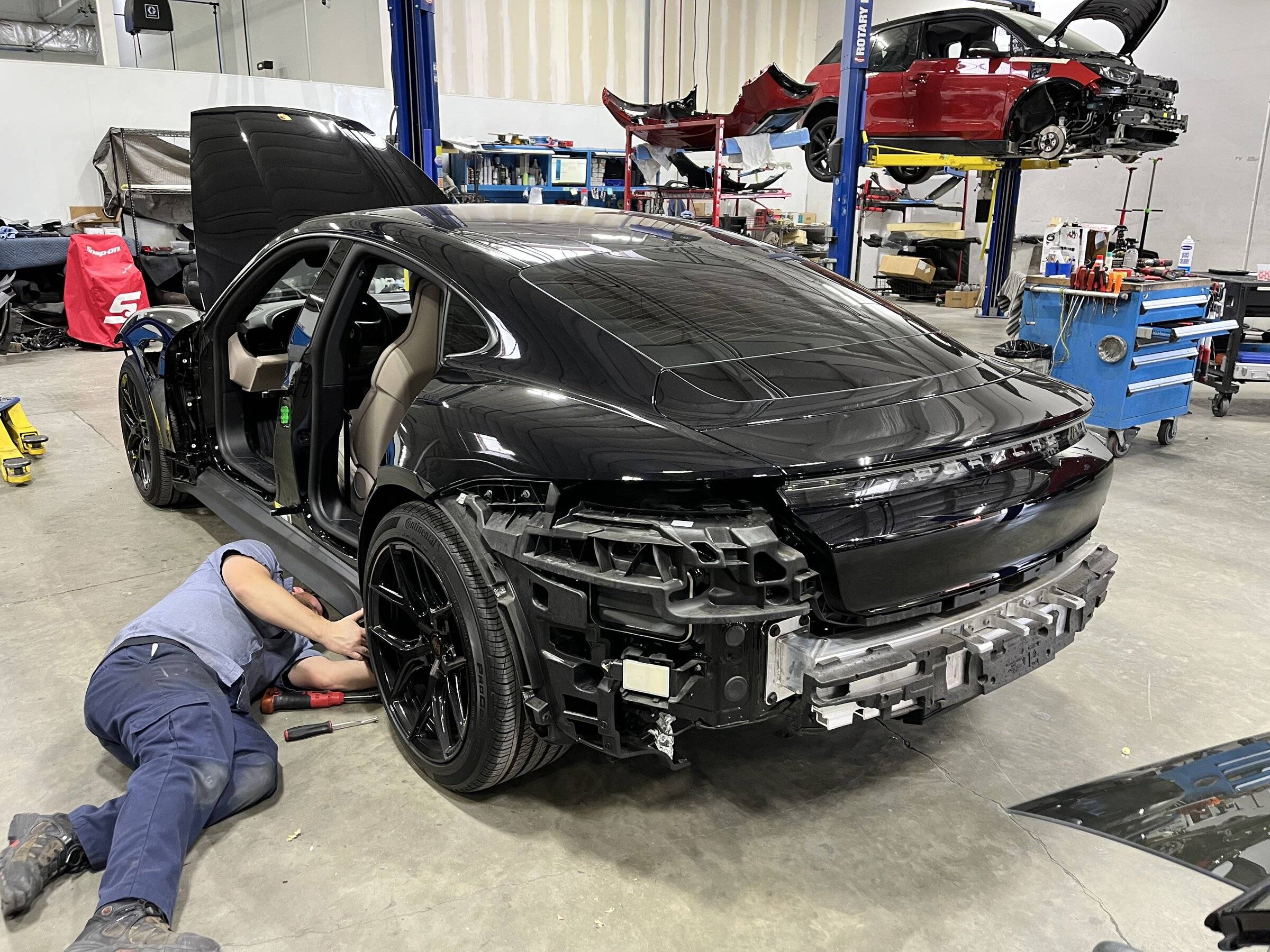

Disassemble, as a quality place, vehicle must always be disassembled. And any one-time use component must be replaced. Here my co-worker removing all parts that will get some love.
Doors need to me removed to be able to remove rocker moldings.
Charging port on the driver side is a one time use, so I order the part. $67.09.
Ordered all parts needed, such as the emblem, nuts for the emblem, rear seal clip for fender, rocker panel molding clips, and fender liner rivets.

So we're not a Porsche certified shop, we're an Audi, BMW, and Tesla certified collision center.
Tech is Audi certified, basically he confirms etron GT and Taycan are very similar in their disassemble process, but thankfully Porsche uses less adhesives. Audi loves double sided tape making most of their parts one time use.
Disassemble for HV components, very similar to Tesla and etrons.

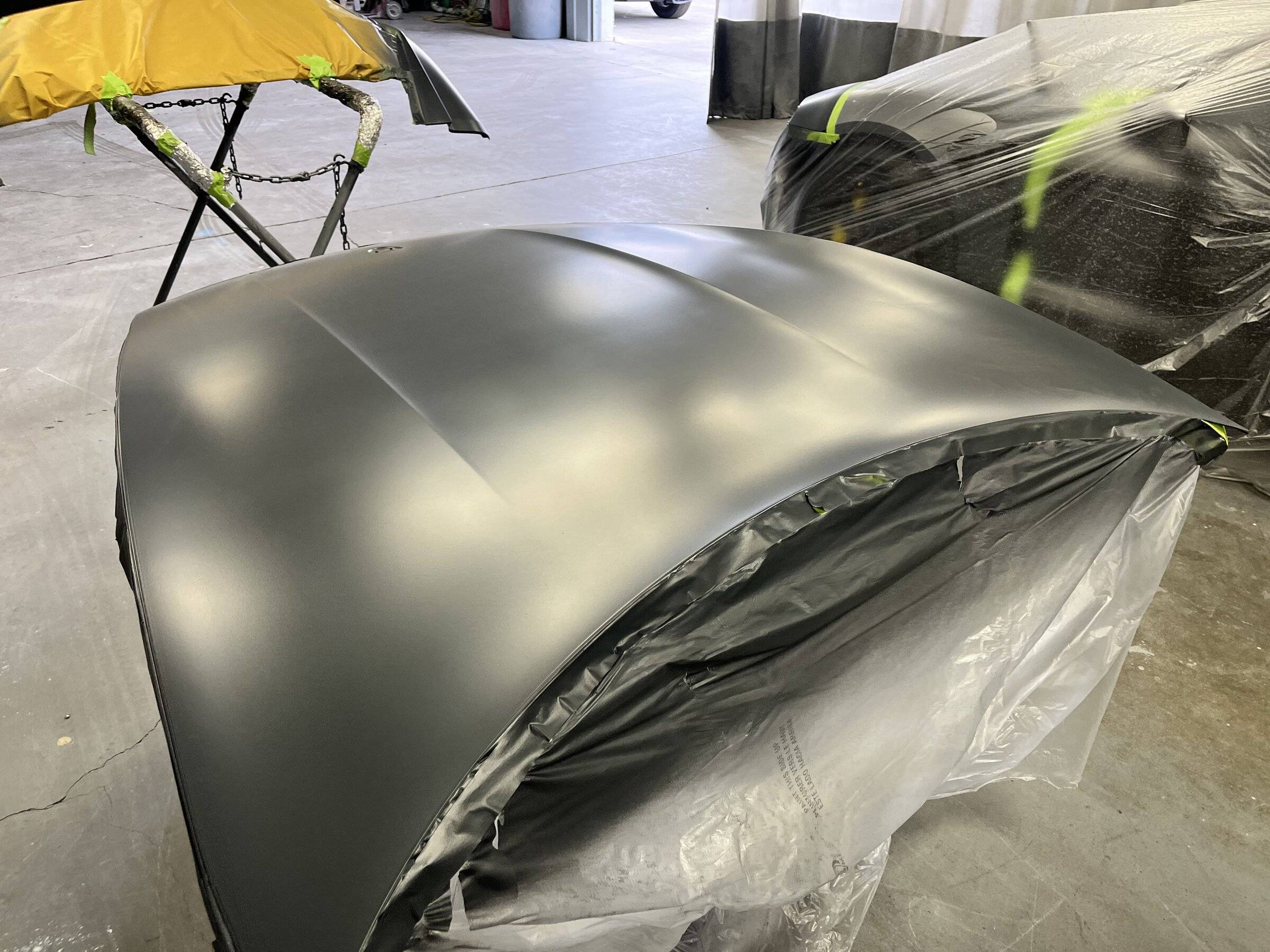

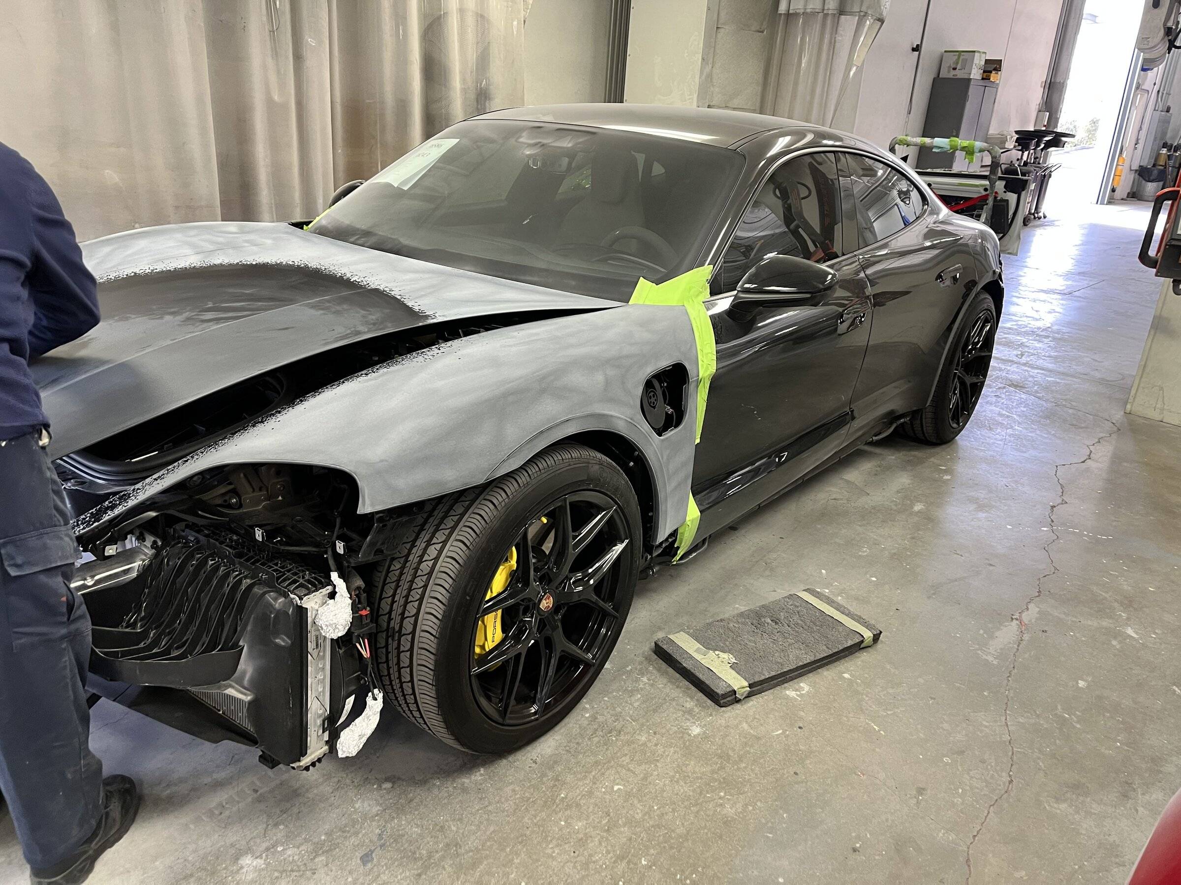

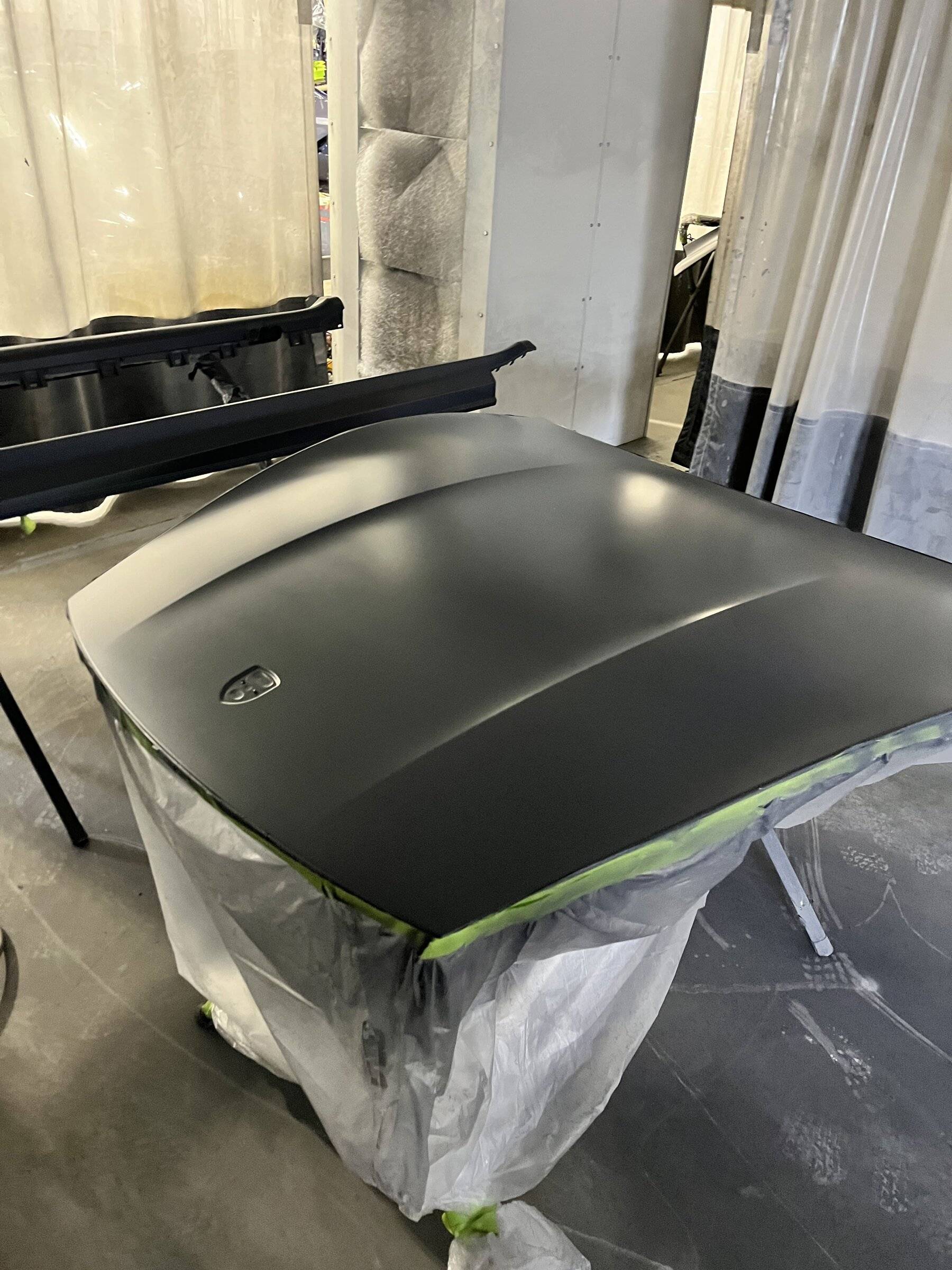

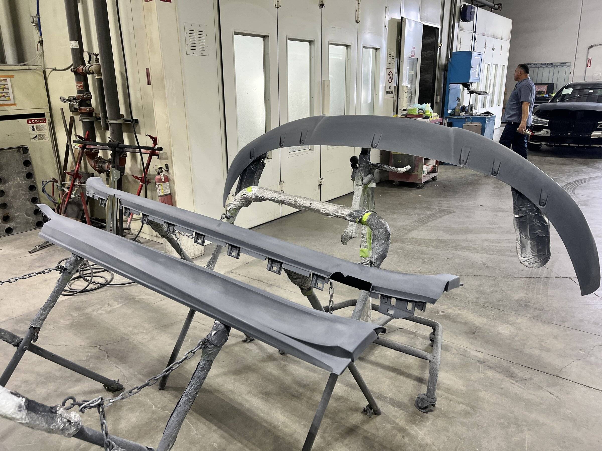

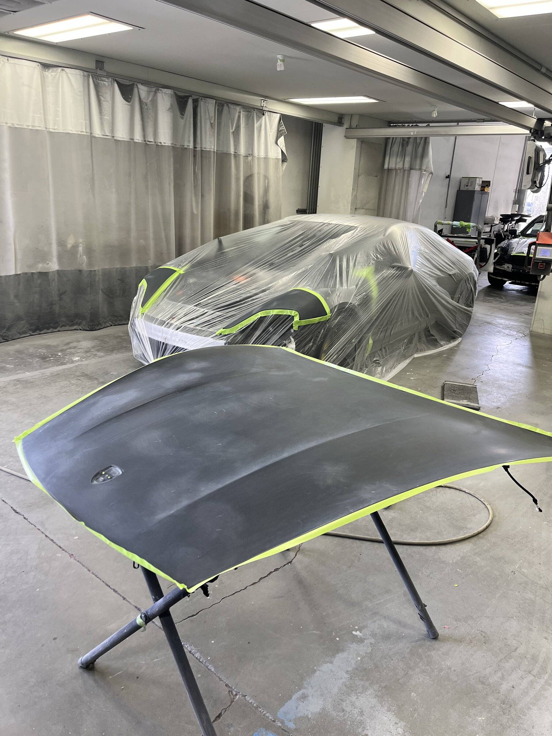

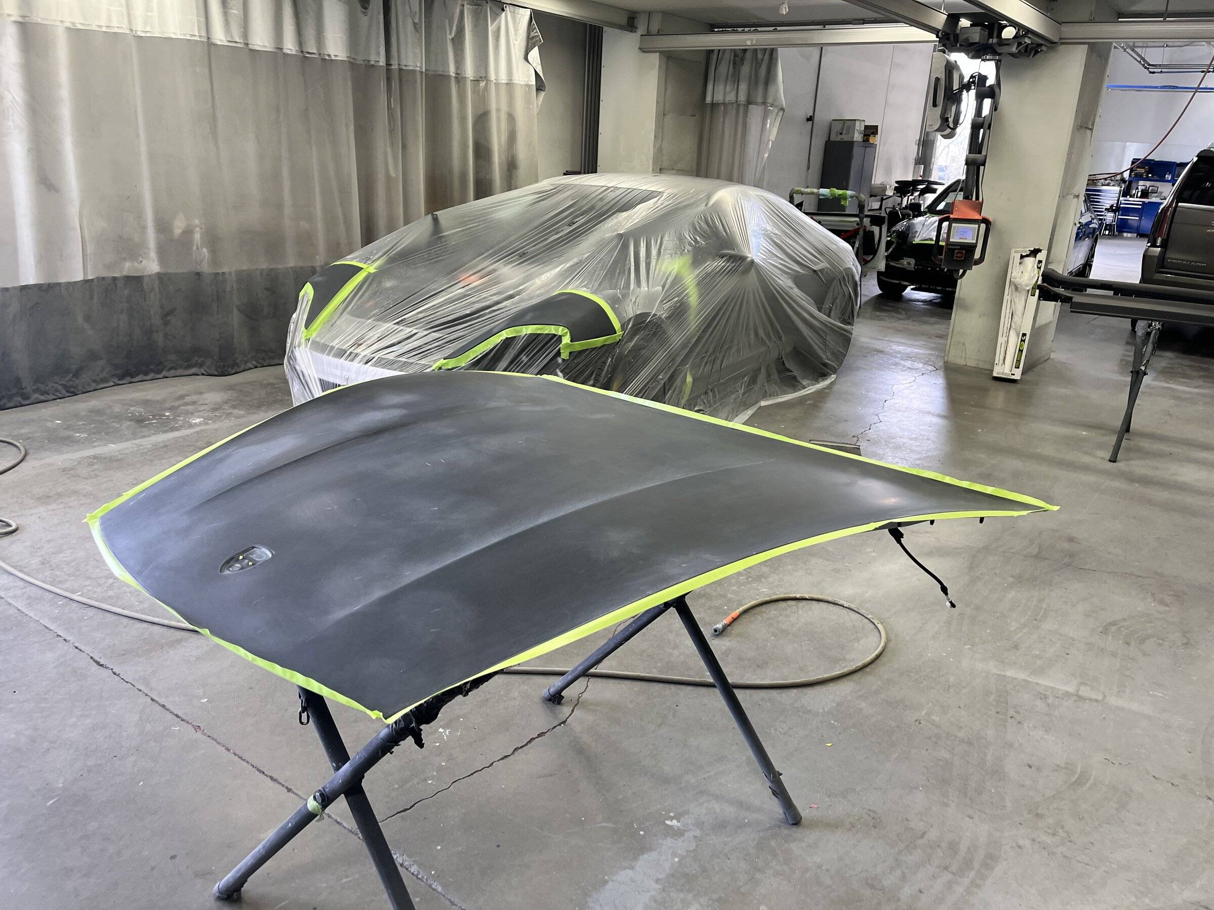

Disassemble is easy. Paint is when it becomes tricky, especially because the hard texturized panels need to be sanded down to a fine texture, and then primed.
Rock chip repairs are easy, just need some feather, block and prime.
So my colleagues from paint department don't like me too much lol, don't worry, they're getting paid several hours for their work. It's just a pain in the ass to sand down to a fine surface.

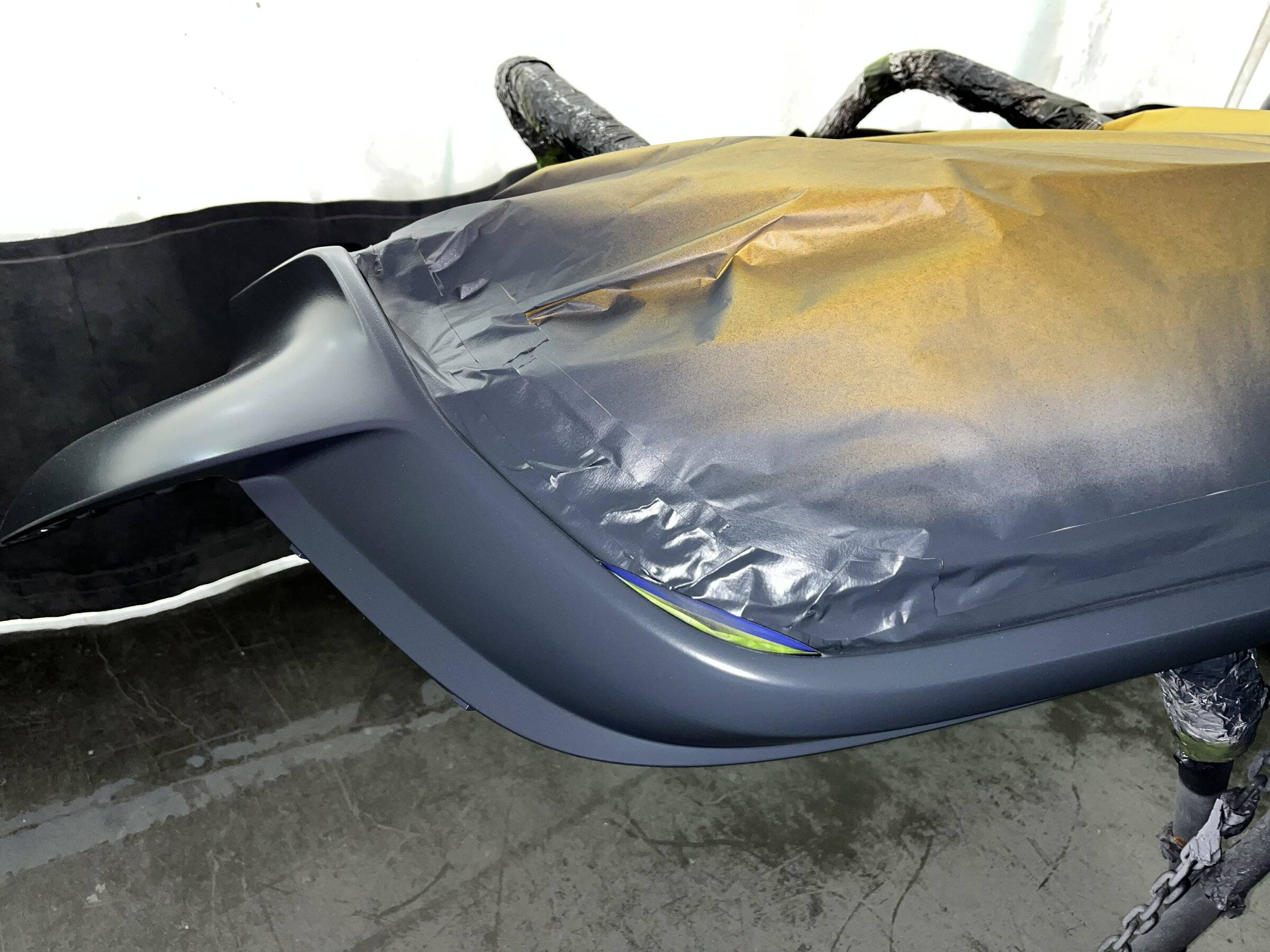

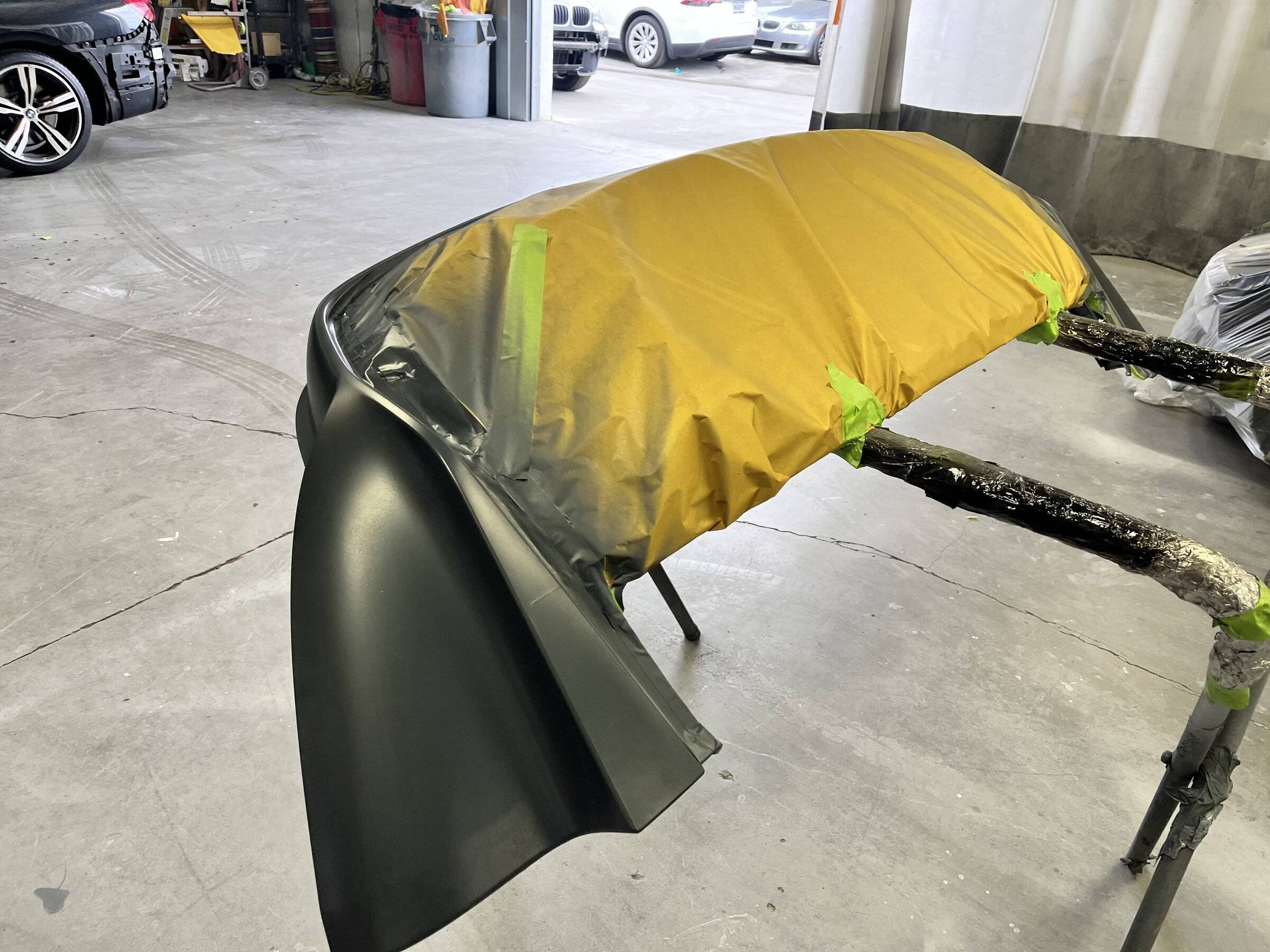

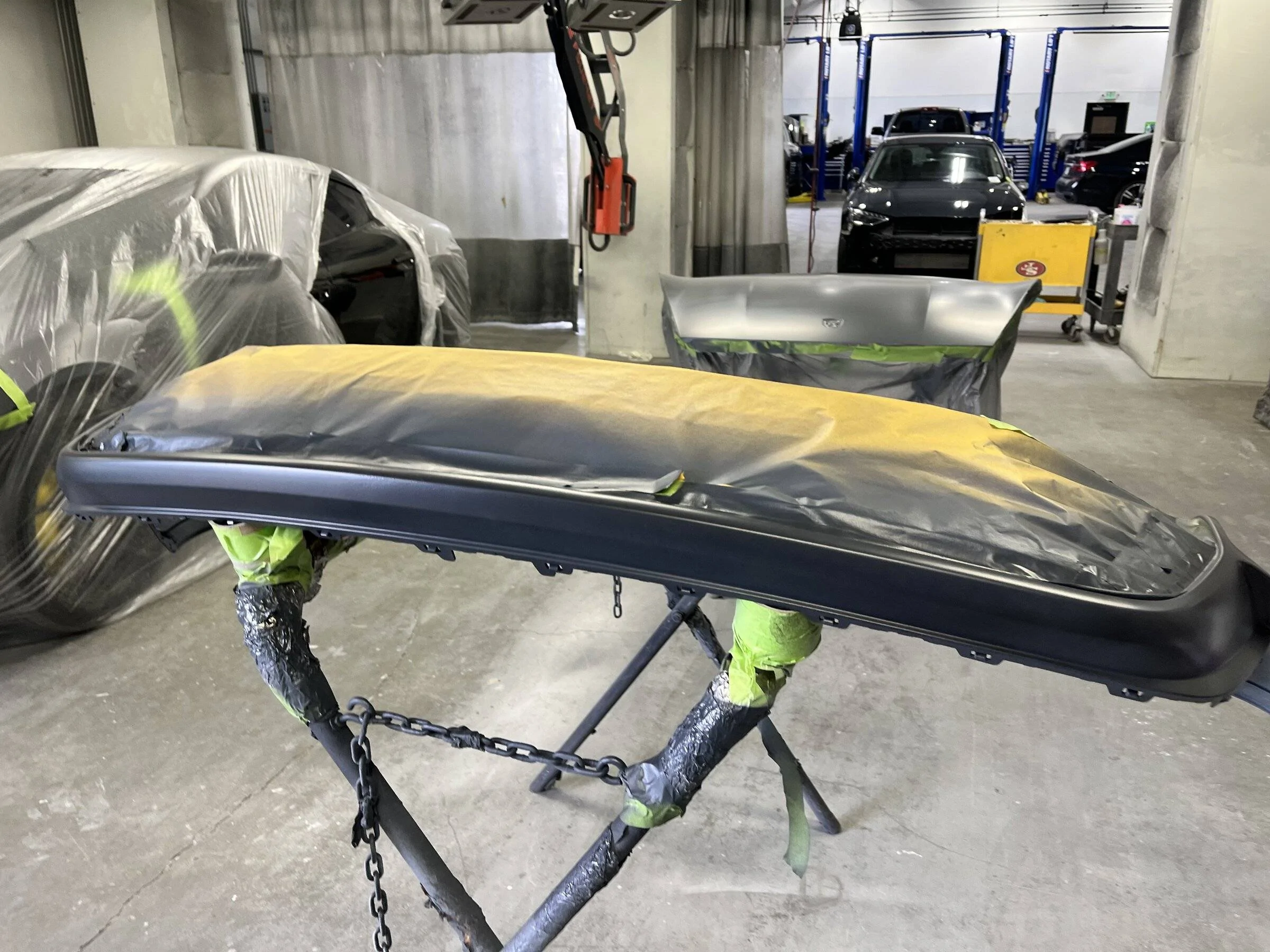

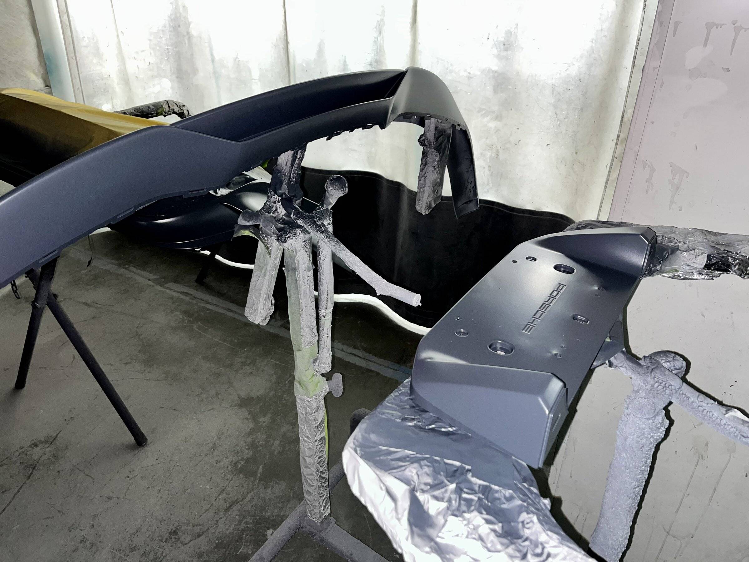

Parts are now in primer. Notice that in the rear bumper, we're painting the top textured part but not the middle. I hope you guys can notice that.
If not, I'll just create a scribble to point out what we're painting.
