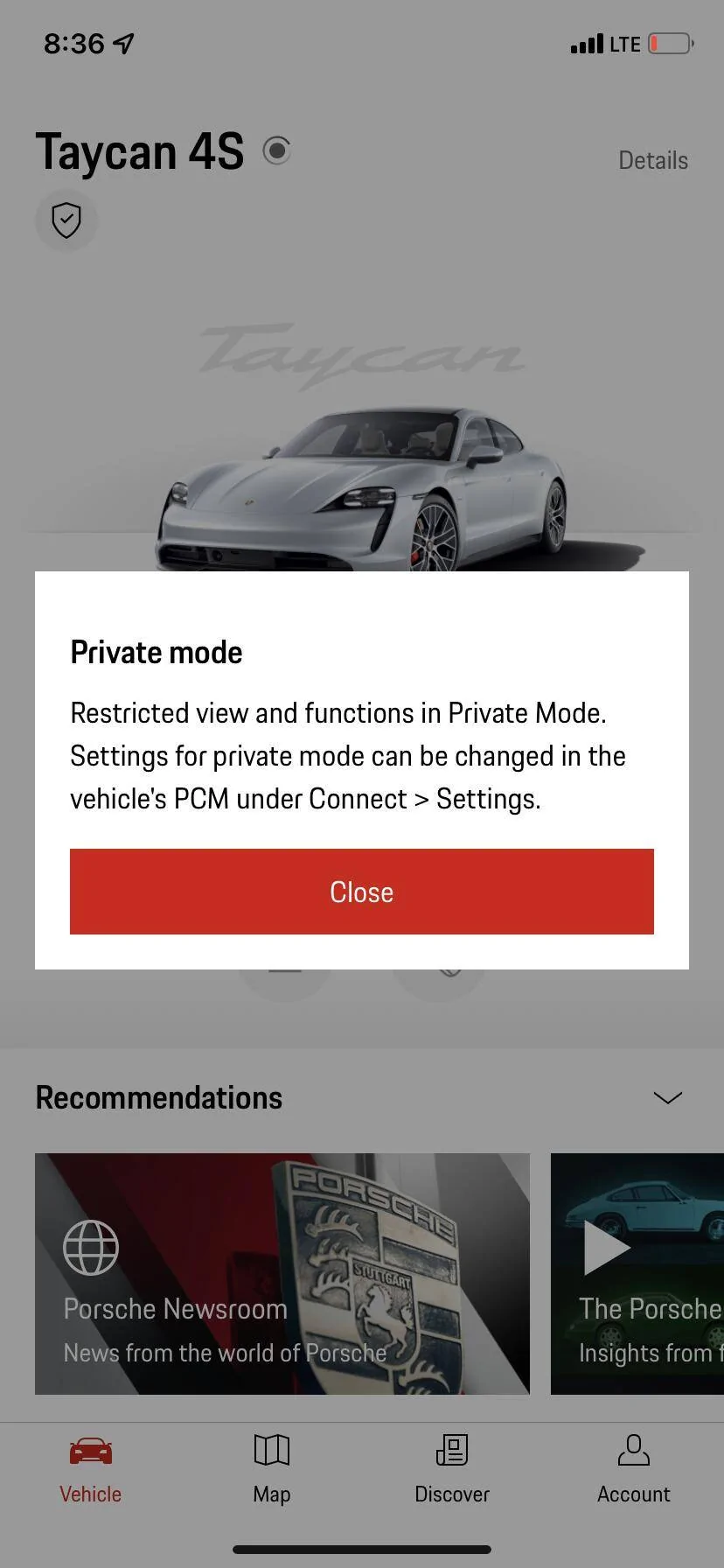

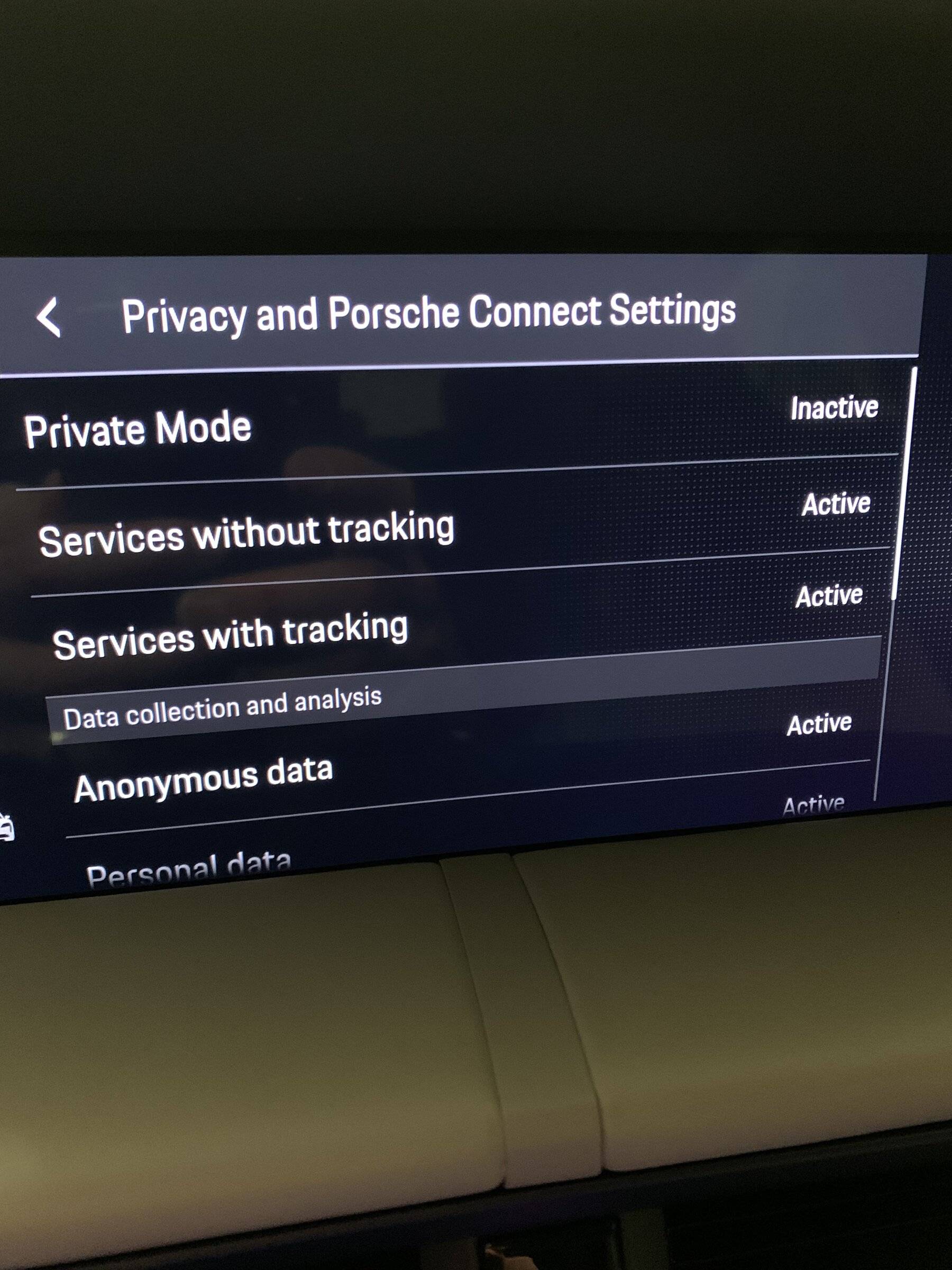

Sadly, they haven’t fixed it yet. My 2022 Taycan doesn’t connect to P Connect or My Porsche. Apps shows that I’m in private mode but car shows that I’m not. Does anyone else have this issue?
