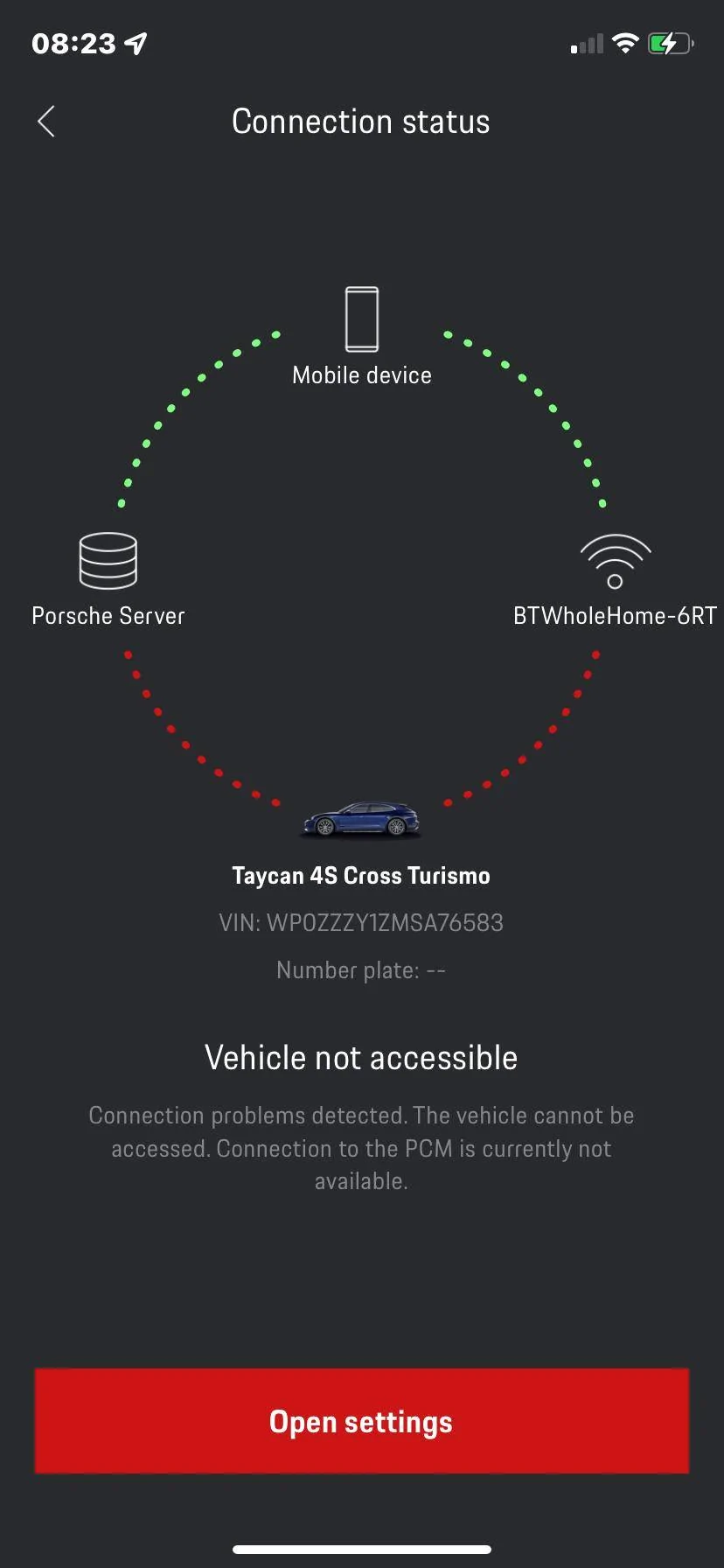

Hi 2x morning running now with a hard frost and wanting to set climate/warm car and no connectivity from Porsche server to car (UK) is it just me or current
network issue? thanks

In my opinion there is a fundamental issue with the way the server communicates with the car. Often the car just will not wake up and listen for commands. Anecdotally, this tends to be more common on cold mornings. The only solution I have found is to go and unlock the car. Once you unlock the car, it wakes up and is normally able to communicate with the app after a few minutes. It kind of defeats the purpose of the app but after numerous visits to the dealership and countless support calls to Porsche connect, I am under the impression that they know of the issue and cannot resolve it so fob you off with lame excuses. I am used to it now and resigned to the level of support you get from Porsche.

You can ignore the bottom right quadrant as its not needed unless you want to sync calendar appointments when in the car BUT the bottom left quadrant is key.
Your experience is my norm - I cannot rely on the car waking up and connecting (MY21) and so features like this become useless.
It may be the car's LTE is in a deep sleep, LTE signal is weak, connectivity to the Porsche service is down for whatever reason or some other random fault. If you regularly get a connection from the same location then it could be that the issue is cloud related.
PITA for sure.

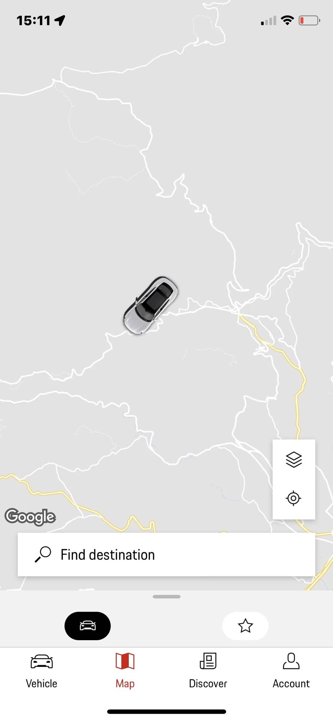

It doesn't work on my UK version (Android) in that it doesn't show any chargers at all (and I know they exist) whereas in the old app it did (perhaps I need to re-install).
I reloaded the Porsche Connect app on iPad OS and all charging stations are available to see. If I do the same on My Porsche they don't display plus I can't navigate anywhere as it thinks a theft is in progress (!!!). Total pile of sh1te IMHO and should not be on release (UK at least).
