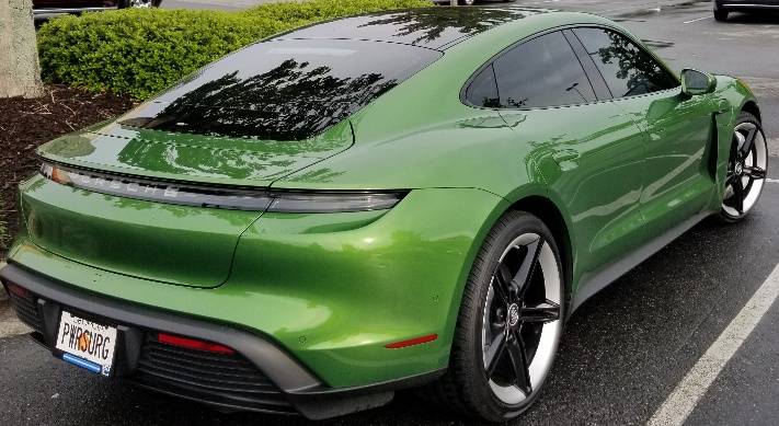

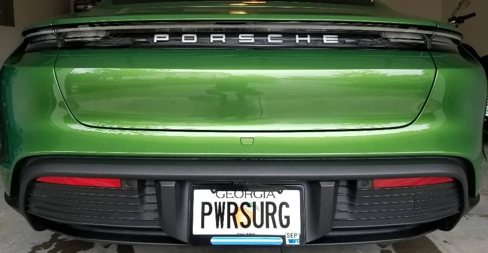

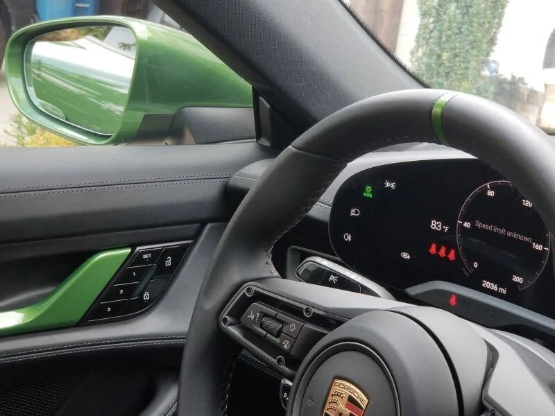

Also Mamba Green, the race stripe on the steering wheel, and the message on the vanity plate probably add another 30 miles of range.
Porsche Taycan Consumption and full battery charge level PSX_20200810_200511_resized
Porsche Taycan Consumption and full battery charge level PSX_20200810_200843_resized
Porsche Taycan Consumption and full battery charge level 1609629607933
