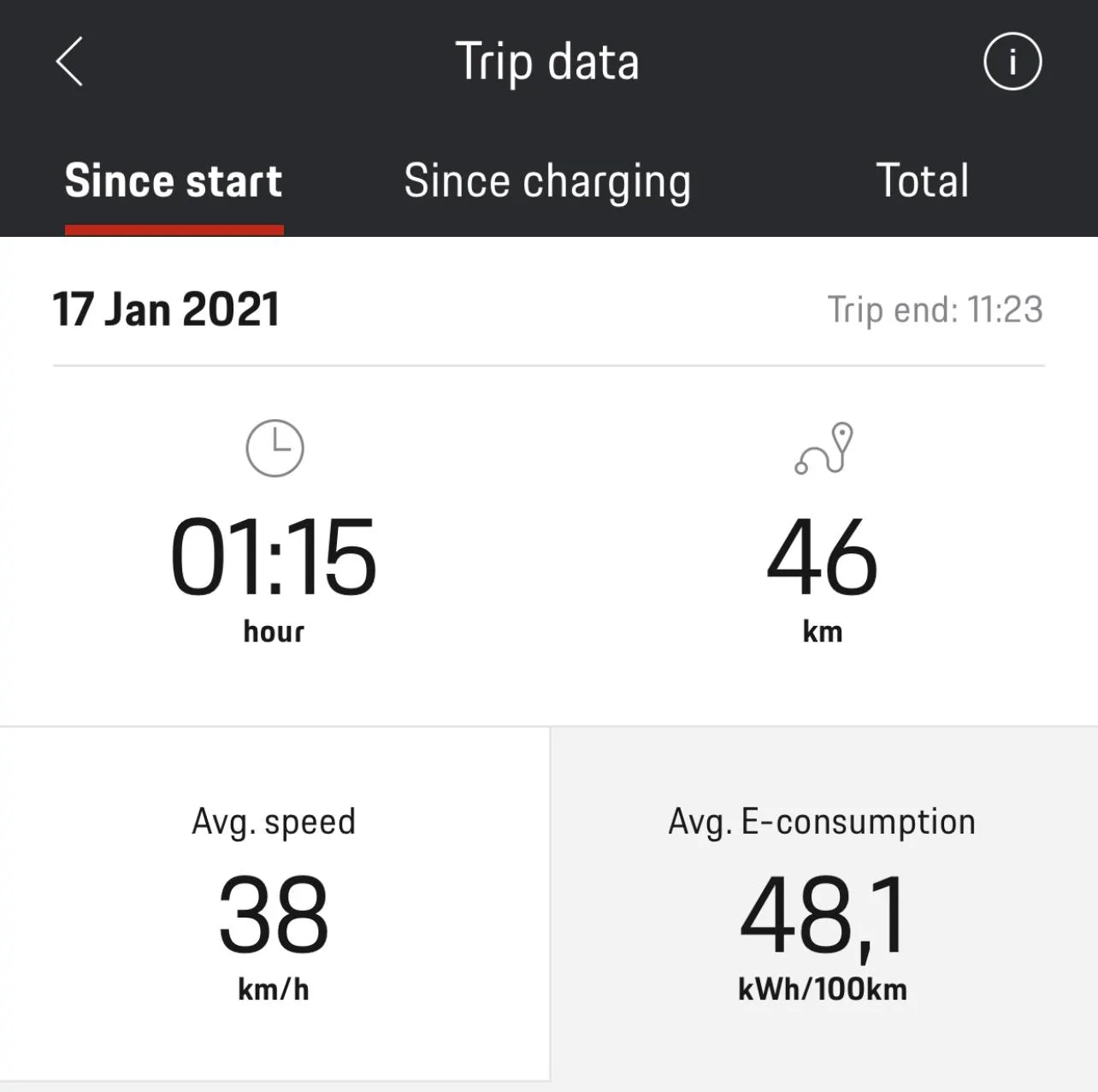

Hi guys,
I’ve covered approx 650km so far but the range so far has been appalling. Temperature is about -12C to -20C. When I got in the car and took a 25km drive (battery temp at -10 on start, outside temp -22C) I averaged 48.8kwh/100km. I had a preheat for about 10min and about 10min wait during the trip. So:
1) is the heating really making so much big difference? This is MY2021 with the heat pump.
2) is there so “drive-in” distance that has to be performed until the car gets a proper range?
3) I speced Performance Battery plus (4s), is there a way to actually check if that has been installed?
car has 19”, winter tyres, insulated windows.

The consumption is so dependent on the battery temperature. If you only drive for 25 km it is not getting much heat into the battery. Remember that the battery has a mass of some 700 kg or thereabouts. It will require a lot of energy to heat that mass. Not sure how much heat can be generated for the battery but my guess is between 5 to 7 kW.
Try a much longer trip if you can say 150 km and see how the consumption develops. And also look at the battery temperature during that drive.
If you have the possibility to plug in the car and charge it and also preheat the car with a good charger say 7 to 11 kW try that. However I believe the battery preheat only works when you set a timer for charging and pre heating. So you must feel confident about doing that, with all the discussions on the 12 volt issues?? I have not been successful in pre heating the battery in any other manner.
Then drive the same route as above and see the difference.
Good luck and keep us informed about progress.

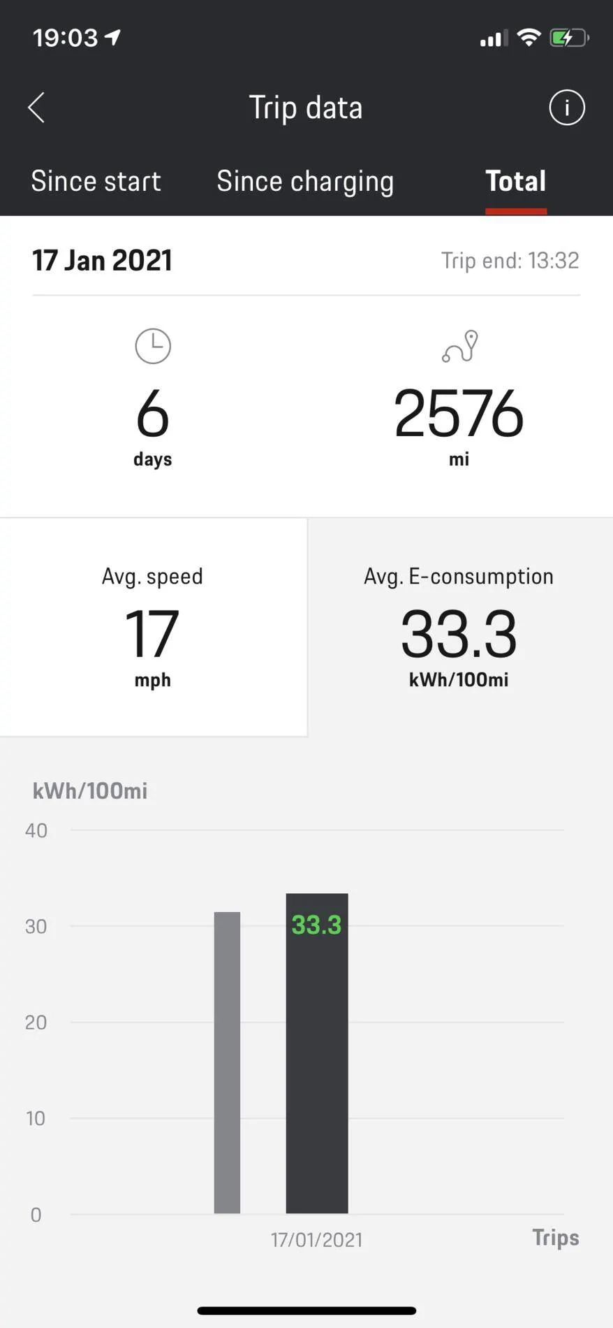

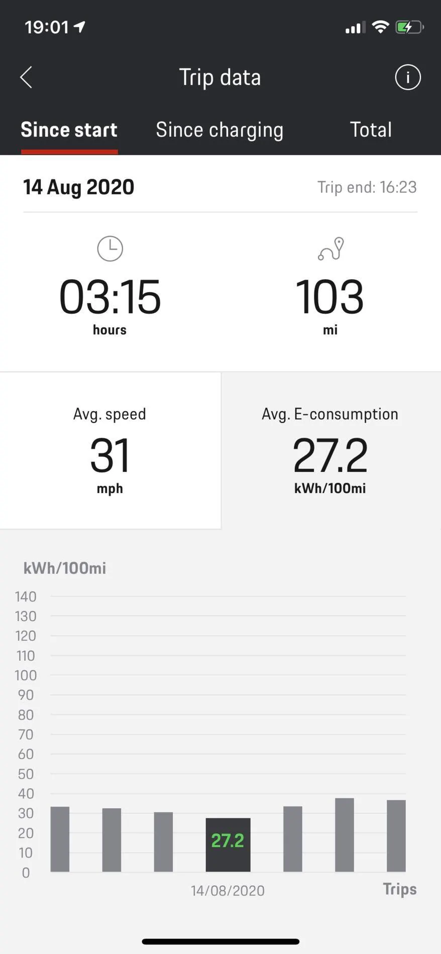

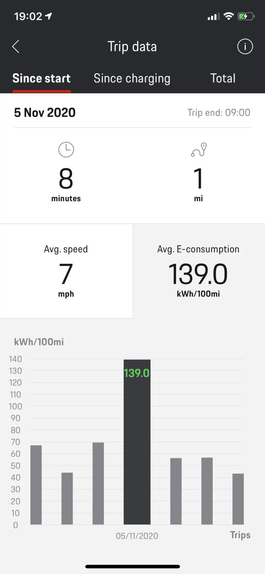

The variance in consumption, similar to ICE, can vary significantly depending upon outside temperature, internal battery temperature, internal load ( air con, heated seats etc.), drive mode/style and length of journey.
Below are my best case, worse case and average over 2500 miles, covering both summer and winter driving from July 2020 to today.
Note this is for a 4s with performance plus battery and as a side note charge to 80% currently shows around 200 miles with summer generally showing around 250 miles.
Porsche Taycan Consumption worst - Copy
Porsche Taycan Consumption best - Copy
Porsche Taycan Consumption average - Copy

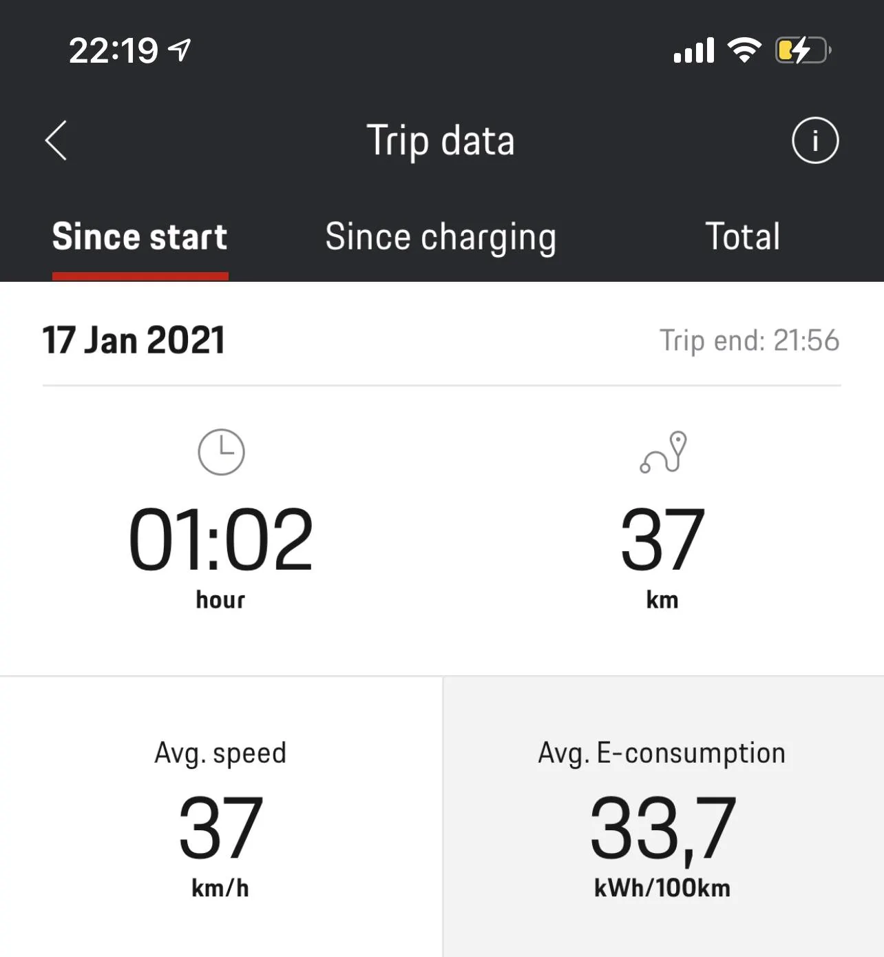

Did another run today, currently -12c outside, but the battery was still warm at about 10c.
Reset the trip metrics right before the departure (to exclude initial cabin heating). Now the result was 33.7kwh/100km (some highway driving, some city driving)
apparently the battery temperature must be it. Will have the garage setup done next week with PMCC, will do more tests with really warm battery.
Will keep posting as the situation develops.
