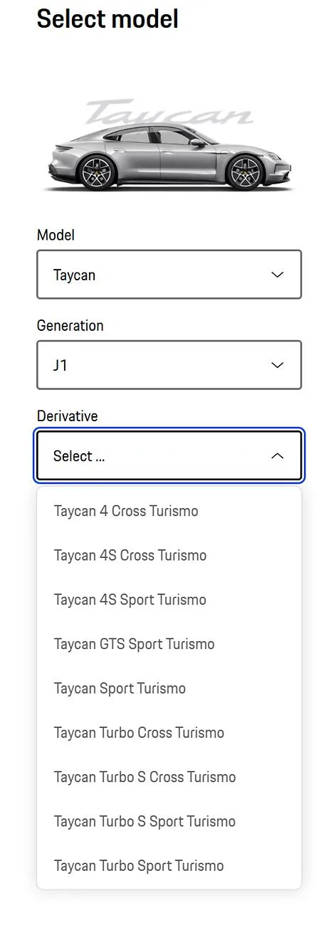

According to the UK parts site the bike carrier is compatible with these models:
Porsche Taycan CT bike trailer to ST 1749463374046-ri
I know the non-GTS ST models aren't available in US but you might have more luck searching for Turbo or Turbo-S parts (on European websites?) as they have the same mechanicals as the GTS.
