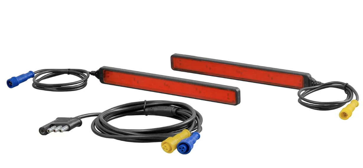

We had a discussion about lights on my other thread here. There are some kits that can be bought if you need that such as this one https://www.amazon.com/Lets-Go-Aero-Universal-Trailers/dp/B079M9L7RF
There are indeed quite a few options including deceleration lights etc but all those I've reviewed need to be powered by the car in some way - with the plug you are providing access to any 'hitch' power would be negated, no? I'm not clear as yet exactly how we could power these light solutions other than find battery operated versions etc.

You can still power any lights with the hitch plug. If you're running lights, then you don't need to run a resistor on that circuit. The resistor just simulates a light in the circuit.
Whilst quite capable in all things mechanical, I have VERY basic skills when it comes to auto electronics - just don't enjoy that aspect - and the idea of me mucking up here on such an expensive car is very real:)!
I suspect (as we sort of know already from multiple queries here) there would be HUGE interest in modifying your plug with an option to have a (weather proof) light power connection somehow integrated - again this would only effect the price of the plug you offer and keep the main unit as listed - just a thought and I would certainly be 100% willing to pay whatever addl. cost that might involve - no pressure :)

No problem. There isn't much damage you could possibly do. If you want wire leads it wouldn't be a problem to add them before I ship to you.

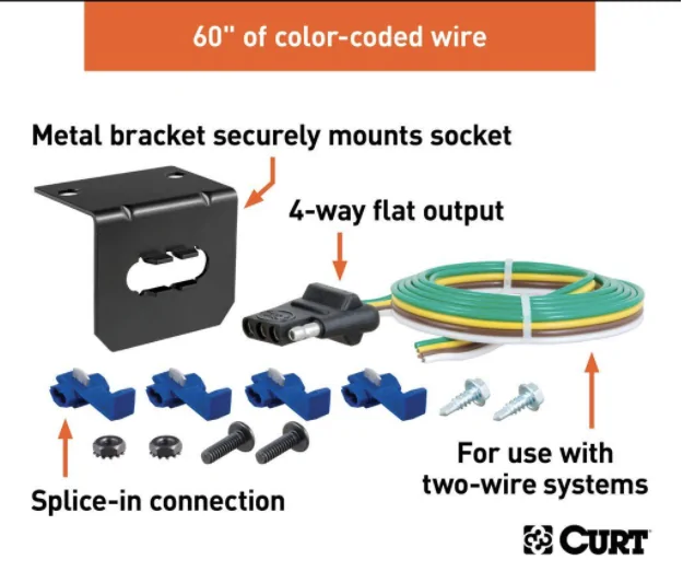

Can take this offline to not distract from the thread but was looking at something like these Curt LED lights but of course the 4 pin plug they use may not be very std. (although they suggest it is) - according to the description, on std hitch hook-ups they'd link to the car's brake, tail and indicator/turn lights which would make for a great solution, nice and simple/clean, however I suspect the pin layout in the Taycan plug prob not that simple to engage/link to?
https://www.amazon.com/CURT-53201-A...8FHX/ref=dp_prsubs_1?pd_rd_i=B07YXH8FHX&psc=1

Guessing you'd need to have this female receptor dialed into the car's relevant pins? Have no idea if our CT's use a 2 wire system or something different?
https://www.curtmfg.com/part/58345
