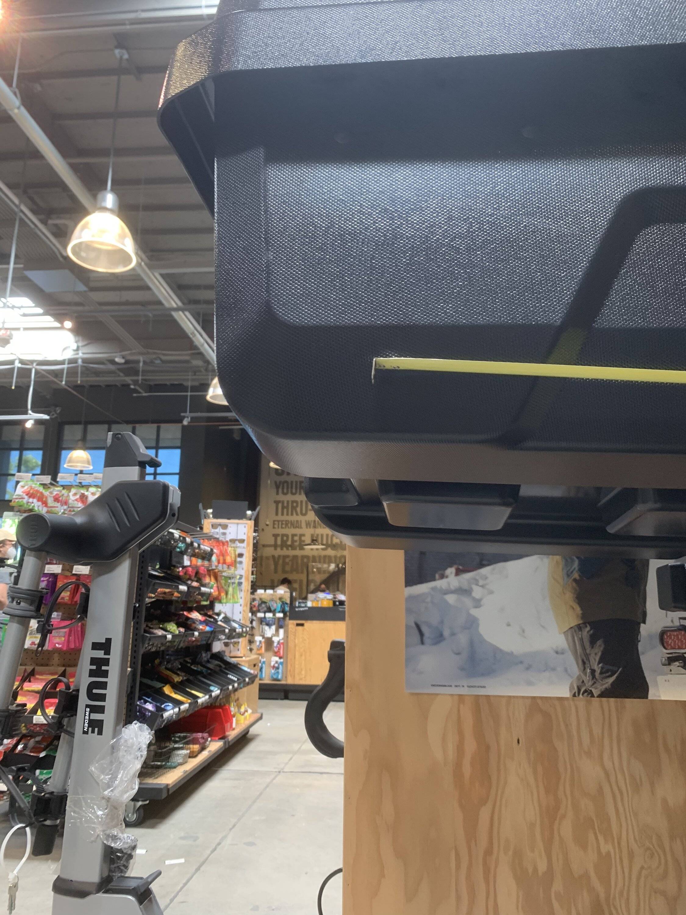

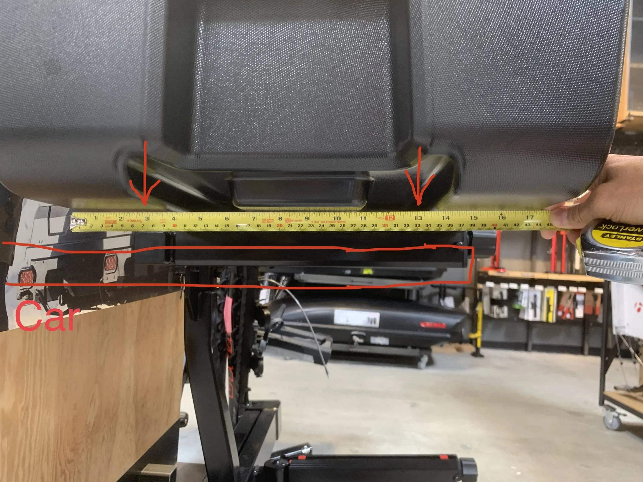

Measured a Yakima EXO gearbox today. It’ll need an adapter to fit the bars. To clear the tailgate opening the mounting points in the bars (10”, 255mm spacing) would be where the arrows are below and the end of the box would overhang by a few inches.

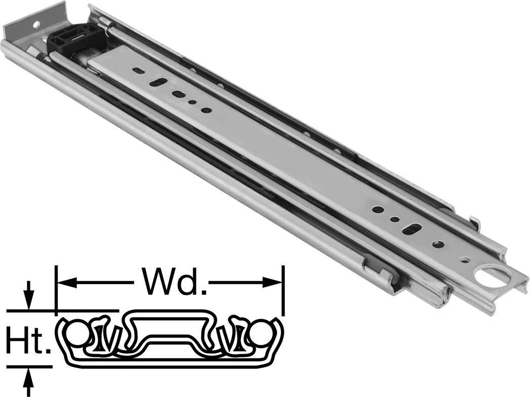

One idea is to use some bottom mount drawer slides. This would allow you to get access between the trunk and box. But adds complexity as you’ll need to lock the position somehow. 150lb capacity in these ones but dirt and such might be a problem over time.
