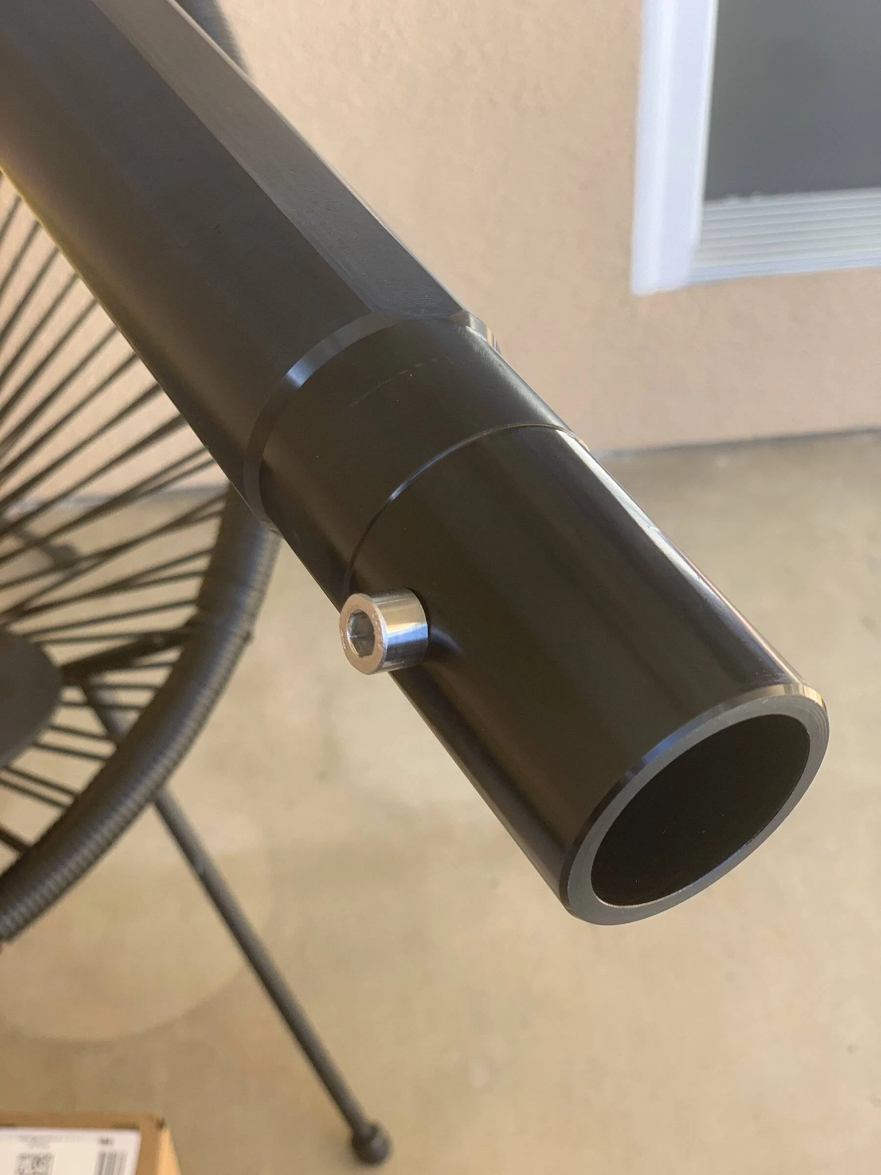

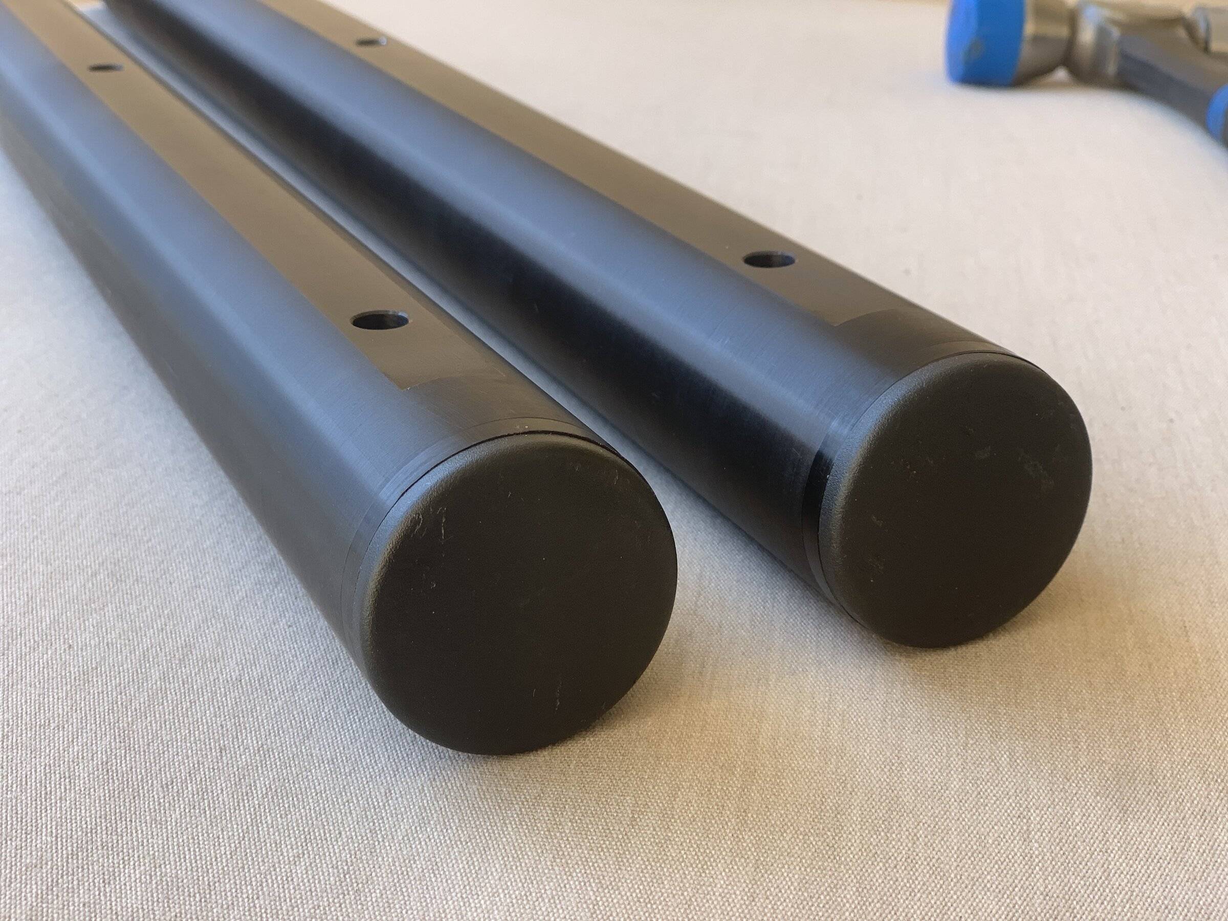

The sockets in the car are 48mm diameter and about 90mm deep and the pins are 12mm diameter and 46mm from the end. I machined them out of 30” long, 2”ODx1.5”ID 6061AL tubes. @Bry5on The pins are M8 cap screws with their heads turned down to 12mm.
Thank you so much for posting these details. I am going to make my own just like this - maybe make the tubes 6" longer.

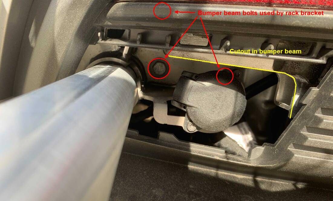

They aren’t available as an option for the sedans. But the brackets that hold the rear rack are just bolted on top of the bumper beam attachment points and share the same bolts. The bumper beam also has some notches cut out for clearance. I could imagine if you could get the brackets and bumper beam, that one could also install them on the sedan.
Do you have a picture of these bumper beam attachment points ?
I am considering trying to make bike rack solution for a sedan. It would be interesting to see how they attached the weight to the frame in the CT.
There's 3 bolts. My previous post said you might need a CT bumper beam but I think those cutouts are probably the same for sedan and CT and needed to access the bolts.
Porsche Taycan Custom Rear Bike Rack Installed with 1up Trays 1643661135500
You can take a look yourself pretty easily if you pull off the cover to access the tow hook attachment point on the right rear. There is even a handy tool in your frunk tool box made specifically for removing the cover. From the pics I've seen though, the sedan access cover doesn't seem to be as large as the CT cover so there is also that to consider if you get the brackets installed.

The sedan doesn’t have a removable cover on the left side unfortunately. Wagon only! This is actually what locked in my decision to not get the sedan after inspecting at the dealer.

Got my rack anodized and fully assembled. Looking very pro if I may say.
Porsche Taycan Custom Rear Bike Rack Installed with 1up Trays 8F0A09BE-3192-4D04-A4FA-111420F94508
Porsche Taycan Custom Rear Bike Rack Installed with 1up Trays C02386DC-376B-4DFB-82E6-7921ADE75985

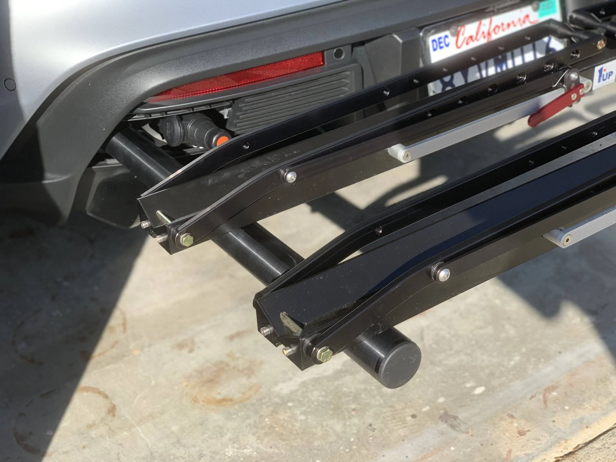

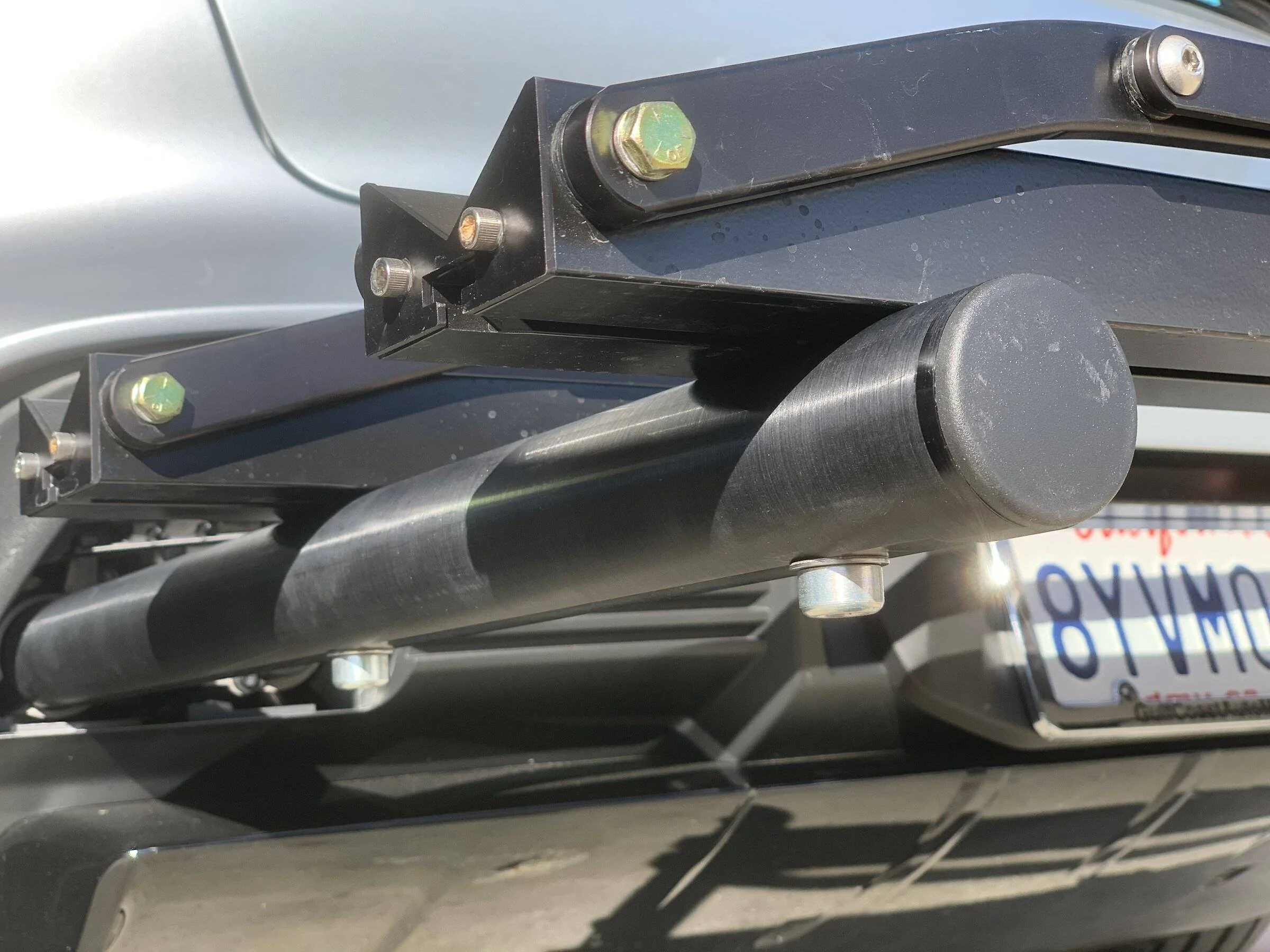

Converted to flush mount bolts for a cleaner look and it now just takes two bolts and about 30s to remove or install the rack. Trays are in fixed positions though but if I wanted more flexibility I could still go back to the sandwich style clamps seen in the original post.
Porsche Taycan Custom Rear Bike Rack Installed with 1up Trays 6EEF3471-E14E-4160-98BA-17AE22A8AC7F
Porsche Taycan Custom Rear Bike Rack Installed with 1up Trays 4F530CAE-D27A-4BA7-A2D2-72BD2079471A
And the tailgate does clear one road/ gravel bike. Pardon my partially gutted garage. In the middle of a reno…
