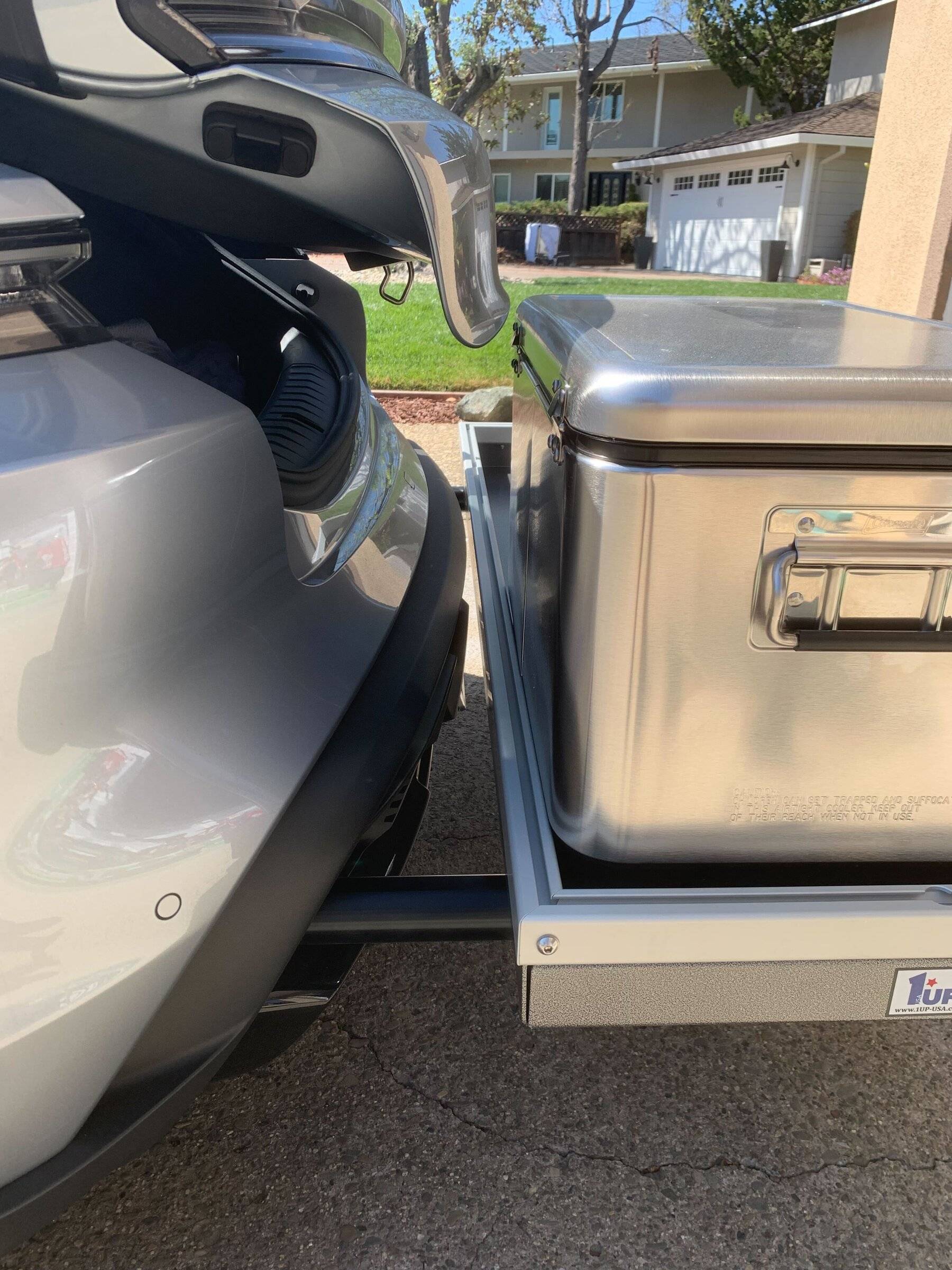

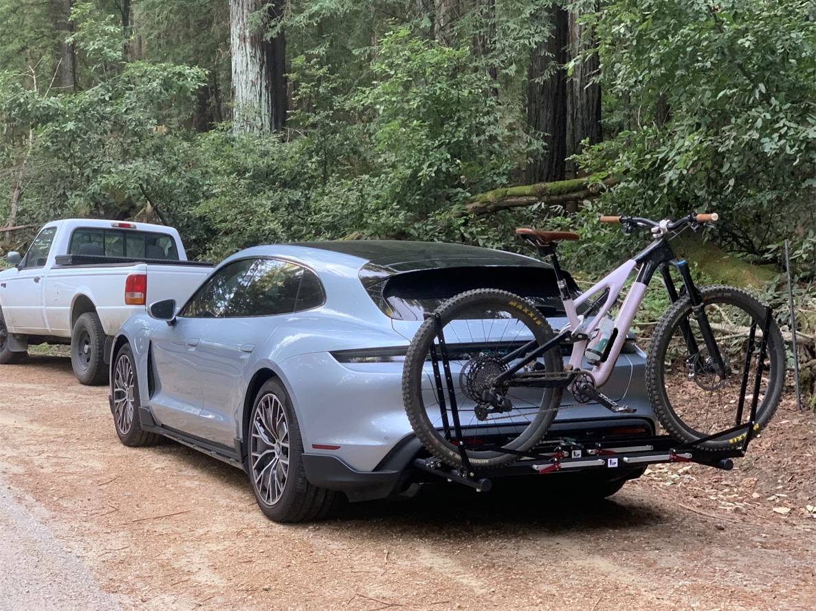

This is way better than the OEM rack, coming from someone with an OEM rack. I might just sell mine and make one of these instead.
Looks nice with the anodize on there too!
Had to bore out the ID to 1.75” to get these to fit.
Prescott Plastics 2” (50.48 mm) Round Plastic Plug Insert, Black End Cap for Metal Tubing, Fences, Glide Protection for Chairs and Furnitures (8 Pack) https://www.amazon.com/dp/B06XKB4CC...t_i_BMEV0GNMF4H1YG03T5EC?_encoding=UTF8&psc=1

Did you get the raw bars from your local metal shop?
Ordered a 60" length online. Local metal shop works too.
Breakdown of what I spent for this one off. Raw material and anodizing would be much cheaper in qty.
Aluminum tube 60" $150
M8 SS screws (box of 25) $14
Anodizing $110

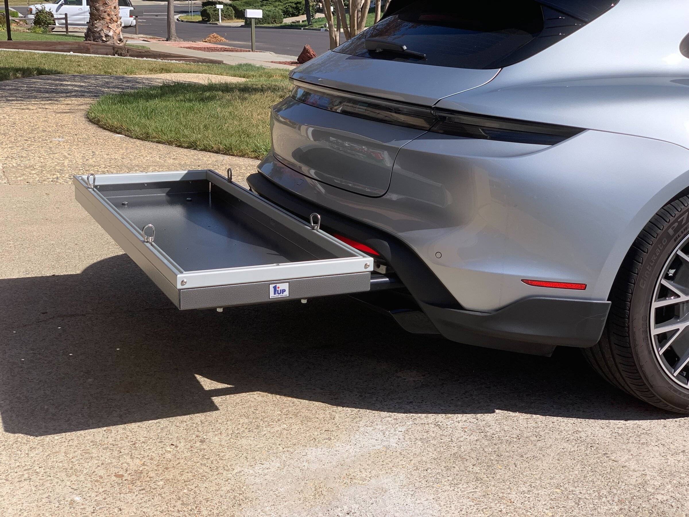

1up tray rack (qty2) MSRP $520
Plastic end caps $14
TOTAL spent for materials $808.
1up cargo tray only MSRP $355

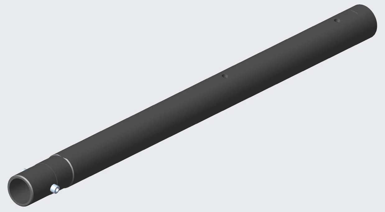

I recently received a bunch of interest in these rack supports so the plan is to make a batch. I've reached out to 1up to see if they can provide any discount on their tray racks for a group buy and will send out the support bar drawings today to quote machining.
I hope to confirm some prices and lead times in the next 2 weeks and I'll start a new thread with group buy details.
In the mean time, if anyone interested has any further comments or ideas, please post here. We can consider incorporating them in to this next batch. Currently, the only design change I have planned is to extend them by 2" to add some more clearance between the innermost bike and the car.
