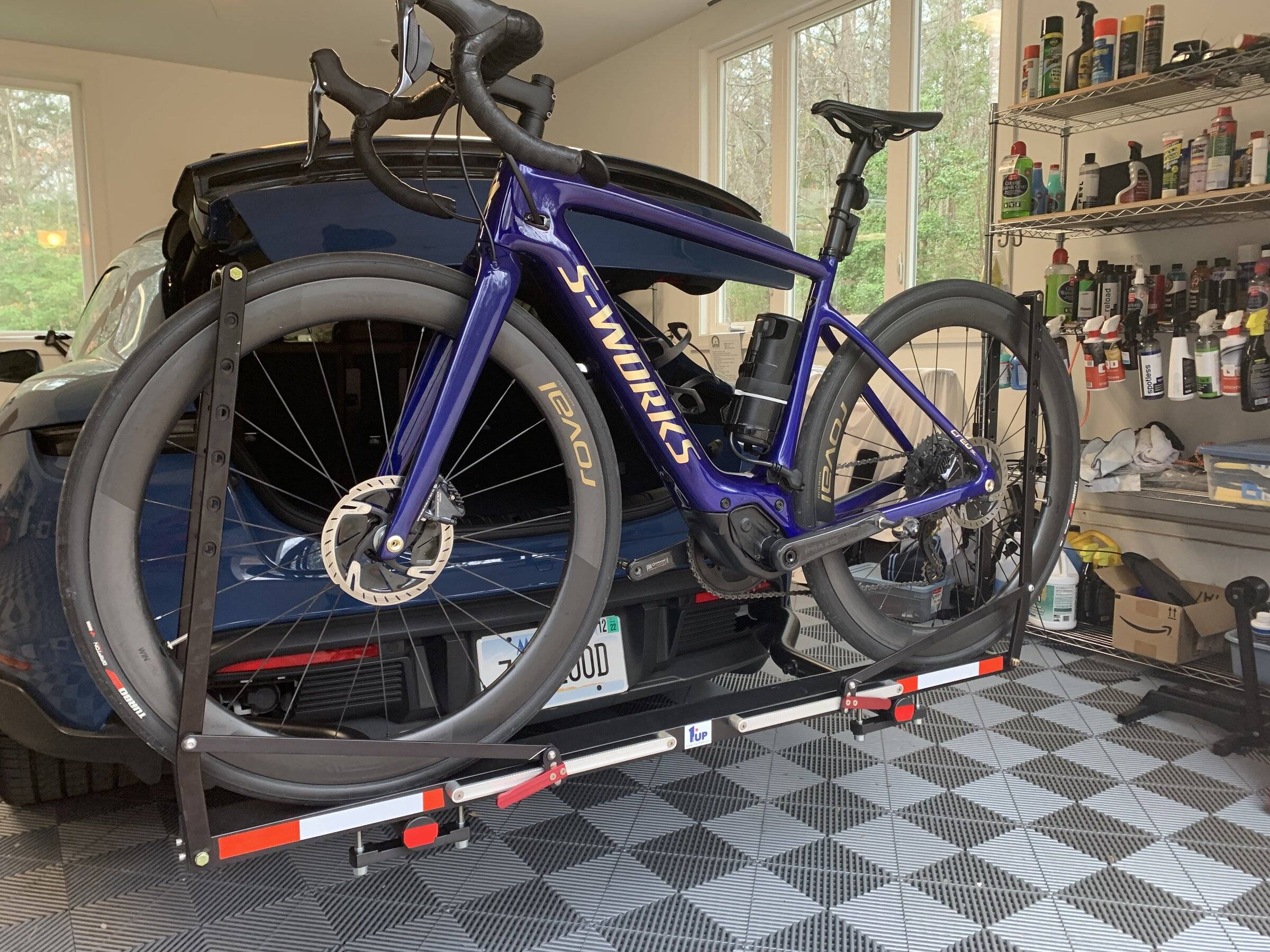

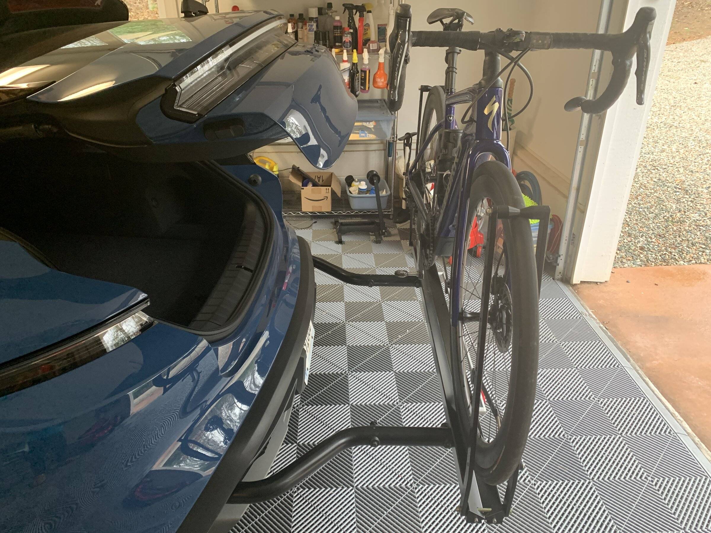

1Up tray with factory bike carrier bars. Hoping I can keep the bars and return the rack. I much prefer the 1Up solution. Much cleaner and the rear hatch has plenty of room to open with 1 tray mounted.
Awesome. Looks great! Do you know how thick the Porsche bars are? I assume they’re steel. It worrries me a bit to see them mounted so close to the ends of the tubes in case the tubes compress causing the clamps to loosen.
The factory bars are steel, 2.2in diameter. Of course the tray can be mounted further back on the bars, as long as the hatch will clear the bike.
Also the Porsche factory bike carrier rack is rated at 132 lbs.

Factory tubes look to be about 1/4” thick - those fasteners would go before the bars would deform :)
edit: 1/8” thick. Still beefy
Nice and light setup.
Do you think that a 2.8 mountain bike tire will fit?
This from 1Up website: "– Fits 16″–29″ wheels, up to 3.1″ wide (see spacer kit for tires wider than 3.1″)."
