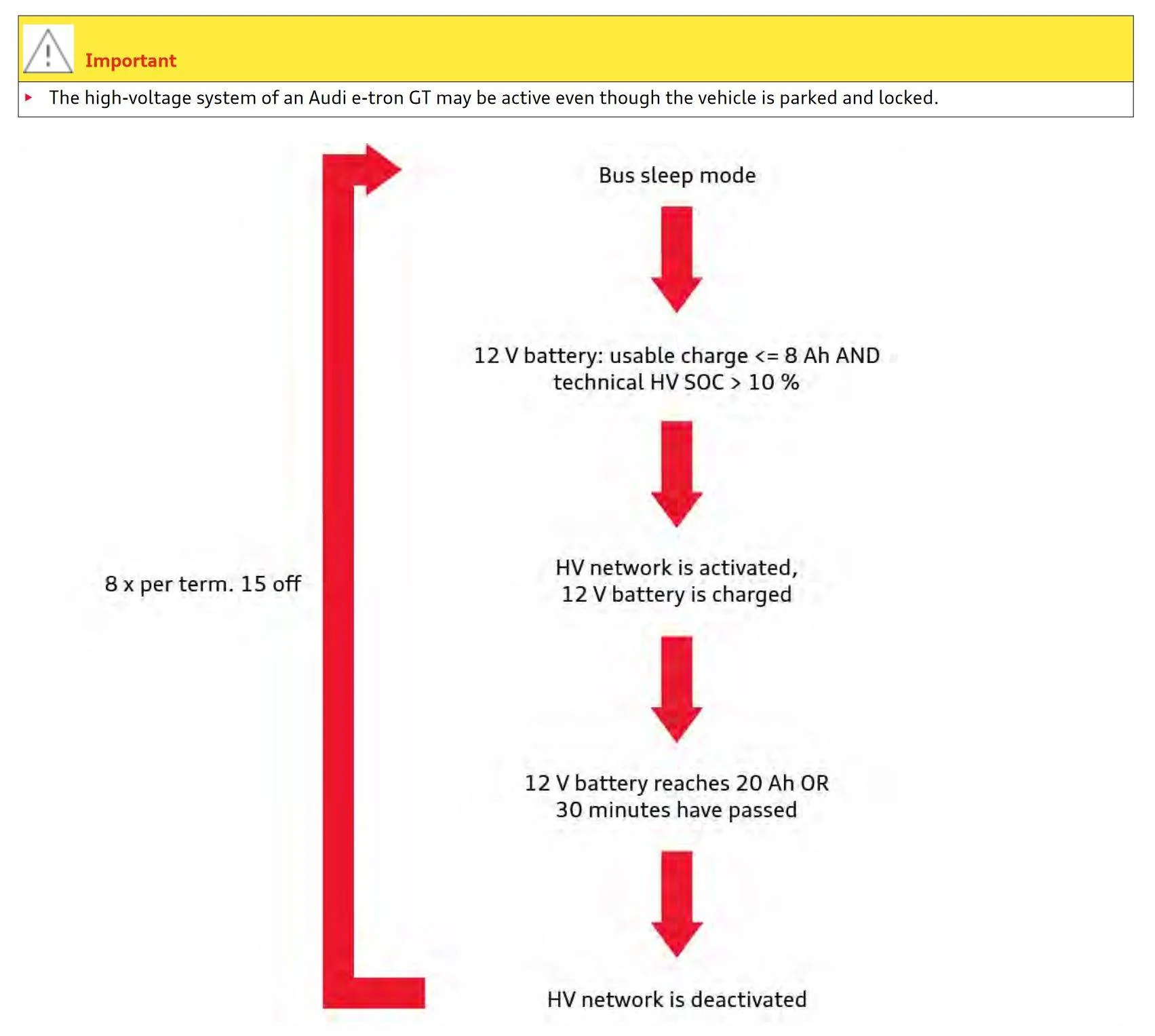

But then, there is this:
- The HV battery will probably not maintain the 12V battery once the HV battery drops to 10% charge. This is unconfirmed though, and the source is from the Audi e-tron manual. It makes sense though, and I thought I once saw a mention of this in the manual but I cannot find it anymore.
- There is this recent thread (Nov 2022) where the battery discharged from a tracker where the dealer said that the HV battery will recharge the 12V battery at most 7 or 8 times. (again, unconfirmed).
Answering myself :), in the Audi e-tron documentation (which uses esssentially the same platform as the Porsche Taycan), it is explained how the 12V battery is recharged: see
https://static.nhtsa.gov/odi/tsbs/2021/MC-10190946-0001.pdf, page 127.
Assuming it is indeed the same on the Taycan:
- The 12V battery is indeed LiFePO4, nominal 13.2V at 40Ah (= 528Wh, as shown here). At 80% the voltage is 13.4V and at 100% it is 13.8V. The battery can operate beween 11V and 14.8V before a relay disengages it from the system (temporarily).
- If the car is "off", and the HV battery is above 10% and the 12V battery falls below 8Ah, it will be recharged from the HV battery. (and the car HV network is active)
- The recharging from the HV stops if either the battery becomes 20Ah (half-full) or 30 minutes have passed. (and the car HV network is off again)
- This happens at most 8 times (!) (while the car is "off", i.e. terminal 15 is off).
For a 900x plus with rear camera which uses about 0.42A*12V = 5w, if we start parking with a "half-full" battery, we get (20-8) = 12Ah before the first recharge to 20Ah again, so a total of 9*12Ah*13.2V = 1425KWh, and thus about 1425/(5*24h) = 11.8 days before the 12V battery will no longer be recharged.
So, it seems pretty safe to hardwire a dashcam but it will eventually drain the 12V battery. So, it would be good to also set the parking safety on a 900X (or use a power magic pro) to, say, 12.5V, to have the camera switch off in case the 12V battery gets low. (and I think you can limit the 900X also to turn off after 48 hours).
- If the car is "off", and the HV battery is above 10% and the 12V battery falls below 8Ah, it will be recharged from the HV battery. (and the car becomes "on", terminal 15 is active)
- The recharging from the HV stops if either the battery becomes 20Ah (half-full) or 30 minutes have passed. (and the car turns "off" again, terminal 15 is off)
I wonder why they would set a 30 minute and 8 times limits, vs. say an SoC limit of the HV battery (like Tesla does, they also send warnings to the phone app if 12V battery discharges too quickly). While it makes sense to limit the HV battery discharge, if the 12V battery is dead, you're likely calling a tow truck anyways, so would you rather come back to a half discharged HV battery but able to start and drive the car, or a dead car you cannot even get into? Also, if the car is plugged in and the HV SoC can be replenished, 8 times limit makes no sense at all (you leave your car plugged in, come back to a dead car because 12V battery stopped recharging).
