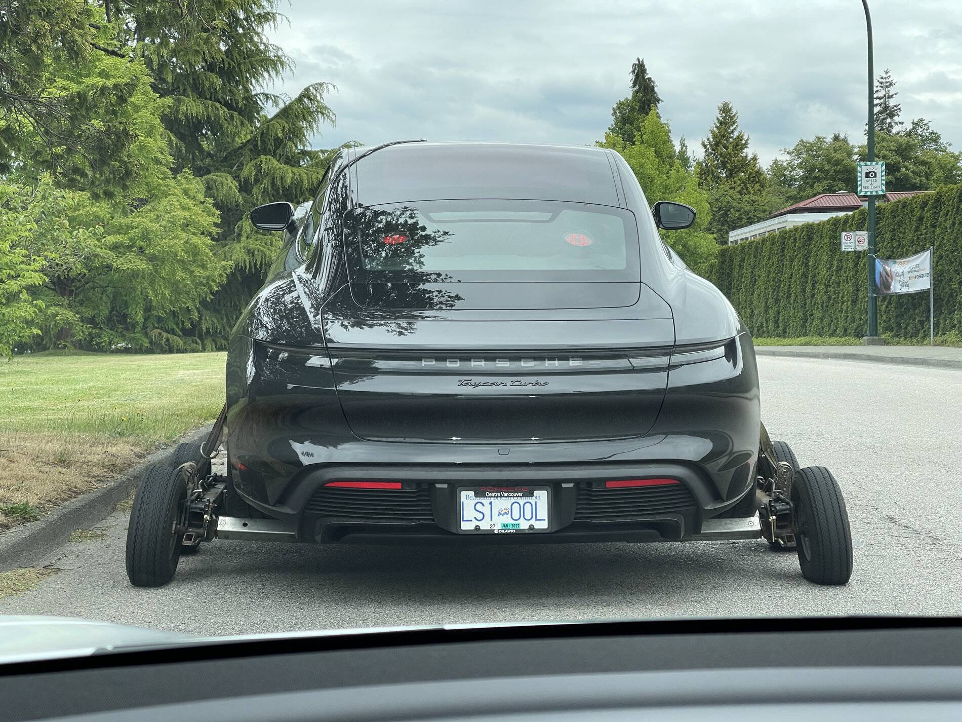

So my car is on order for September production, and I'm hoping the power loss issue is just an isolated incident for a small number of drivers. And then I see this in front of me just now. Of course I don't know why it is being towed, but it makes me wonder. I'm hoping this is not what awaits me....
