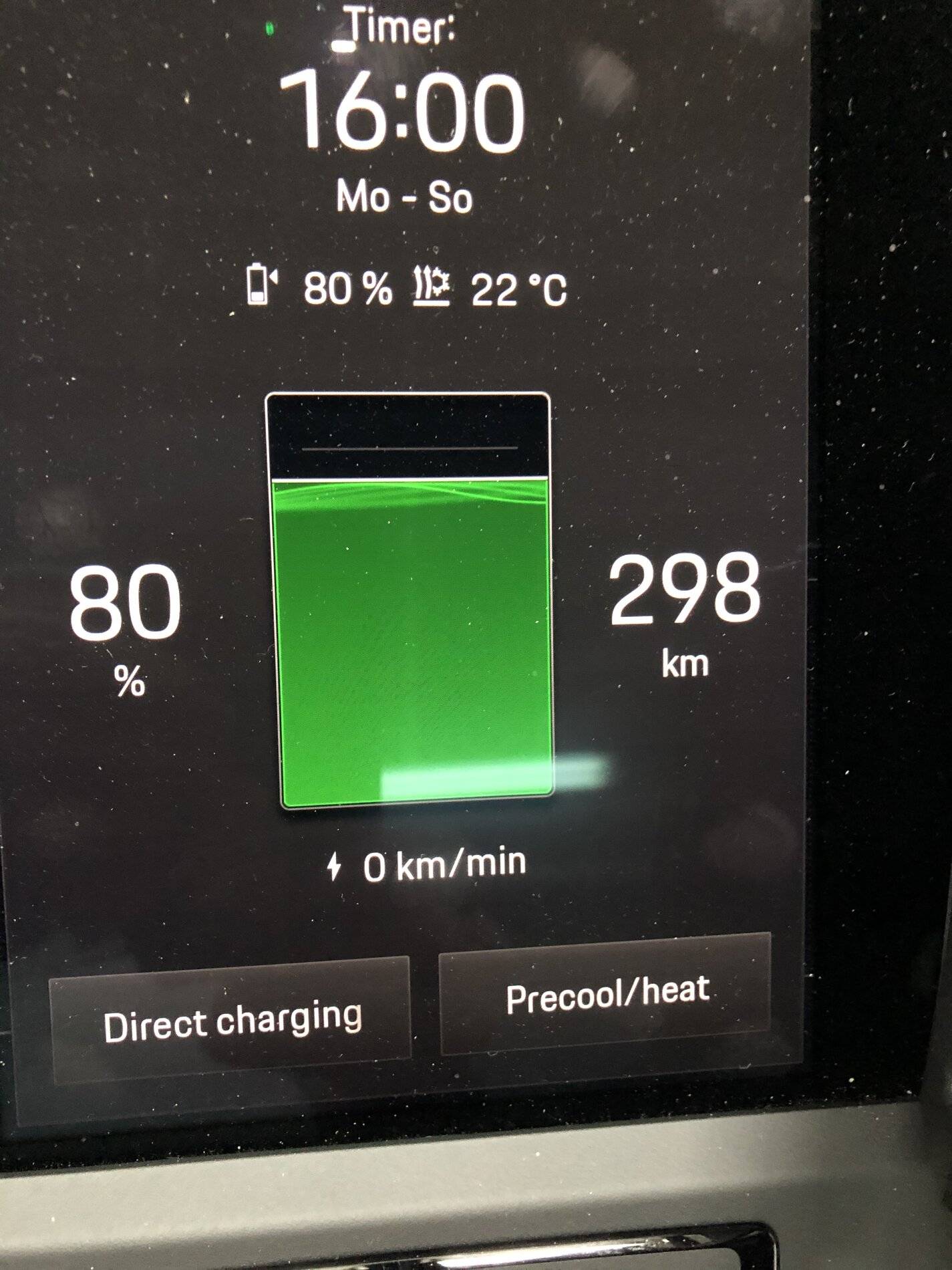

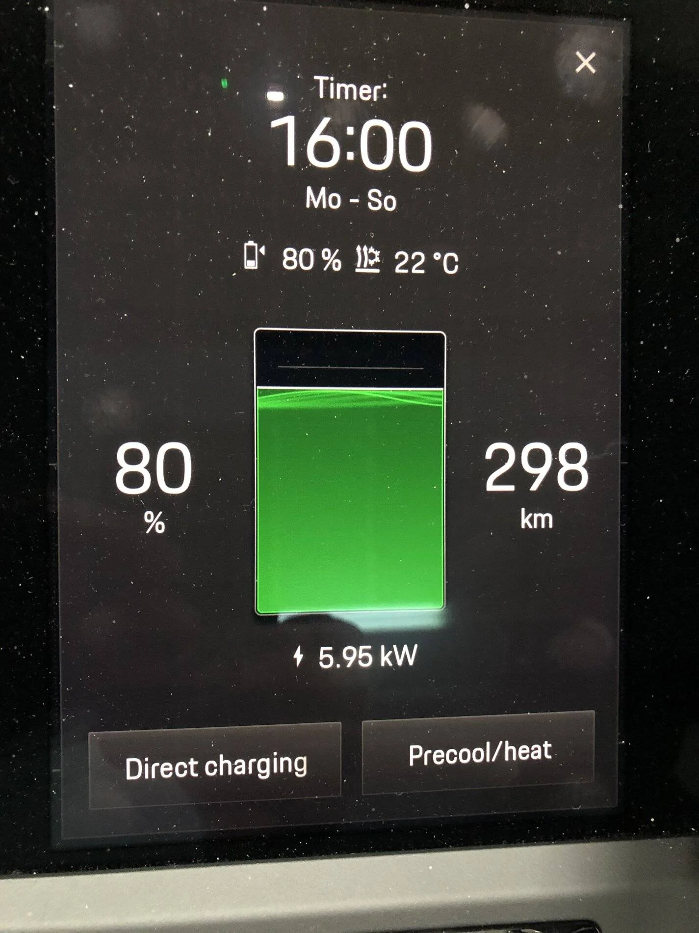

Also toggle the charge rate from miles per minute to kW on the charge screen. That makes much more sense to look at. See photos below.
Porsche Taycan DC charging BFBF042A-8CA3-4A60-8D58-5C077CE83365
Porsche Taycan DC charging DA041838-F60A-4E14-91AC-F85625FA687D
Just press on the kW or miles/ min to toggle

If you had an Etron beside you at a 150 kW charger, you might have shared the 150 kW with that. Depending on charger type it might only give 150 kW in total and if two charge at the same time it reduces!
Thanks a bunch i did not know you could do this
