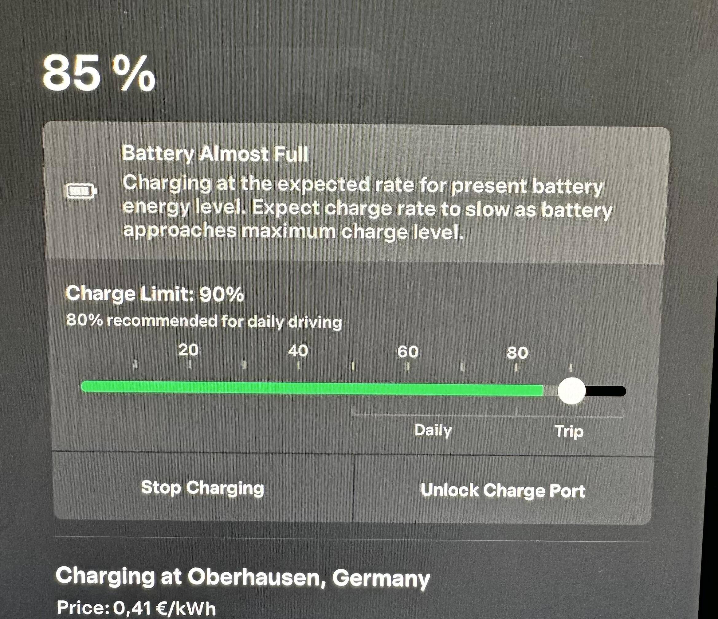

Imagine your battery charge level at say 40%, and you want to top up to 75% for the next leg of your journey. So you plug in to a 150kw or 350kw DC fast charger and head off to grab some lunch or do a bit of shopping.
Returning a bit later, the battery is at 95% - far higher than you intended. As commonly happens, the car was ready to go before you were.
It would be very useful - and just a software change - to let us set a charge limit when DC fast charging, just like we do when AC charging at home. Mercedes does it, Tesla does it, as do others. Dear Porsche: Please add this feature!! And then have the app ping me when I get close to my desired charge level.
Here's the Tesla version, showing a 90% charge limit set on a Model Y and being used at a Supercharger station:

Although I have no Mercedes, but have Tesla (M3P) and BMW (i4) next to the Taycan, but non of the mentioned cars allow to limit the DC charging power, only on AC.
3,587
3,227
That is peculiar. My M3P can set the DC charge to whatever % I want and stop at that. The Tesla app will also notify me when the charge level is nearly achieved and warn about idle fees. In Tesla I just set one charge level and that is valid for both AC and DC charging.
Yes it is clear with me. I thought we are talking about to limit the charging power on DC I mean to set up max charging power 100kW or 80kw etc. similar as we are able to limit it on AC from 6A to 32A.
It was my misunderstanding, thanks to clarify. Using DC only on road trips when I let to work the Charging Planner, so did not recognized up to now it is not adjustable, I mean the max charging % on a scale.
Anyway Taycan also send a push message when the requested charging % is achieved (using Charging Planner) and can decide to stop the charging process from the app or let it charge further.
In this case Taycan needs a little bit more attention on DC without Charging Planner, opening the app time to time controlling the actual charging % and stop it manually when achieves the requested SOC%.
