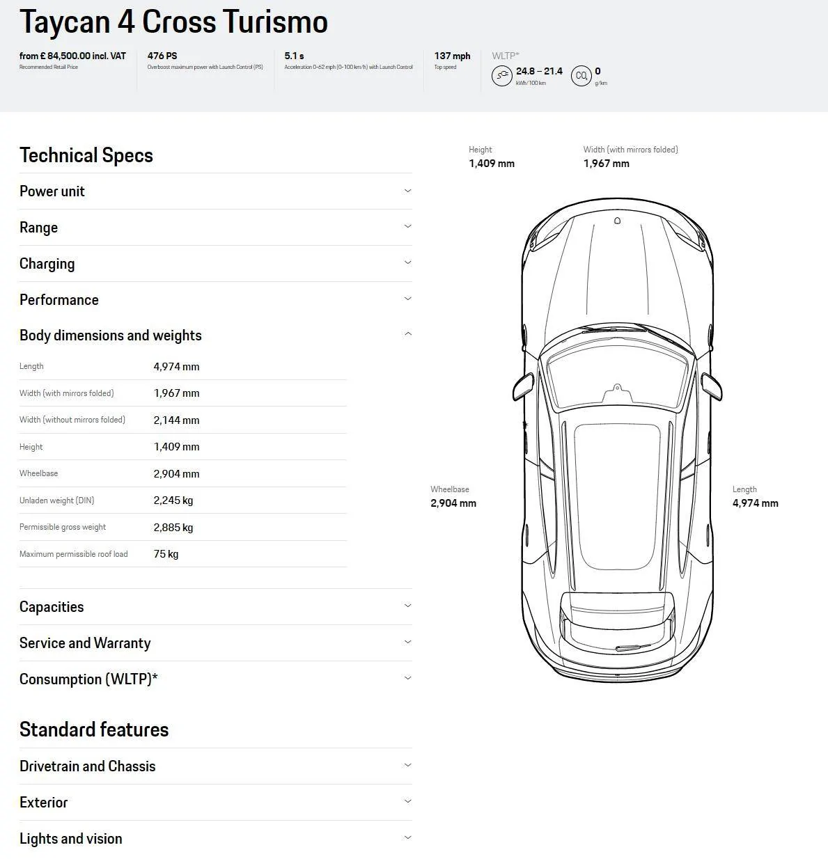

Porsche published specification sheets in 2019 (when I joined the forum) that included curb weights on page 2. Unfortunately the Sport and Cross Tourismo models were not yet announced. There's probably a more current version of these somewhere. But in the meantime, you can use this to validate @satchurator's method of calculating the curb weight from the gross and max payload weights (see if it works on the other models), to give you greater confidence that the method applies to your CT4.

if you download the brochures from Porsche Taycan - Porsche USA they have a tables with weights across the range. 5,000 is a good average. if you want to know your cars weight pull through a truck weigh station.

Equal points to @philbur and @f1eng - thank you!
The brochure link does have current model year curb weight under the technical specs Body section. And of course, weighing the actual car at a weigh bridge is the absolute definitive!

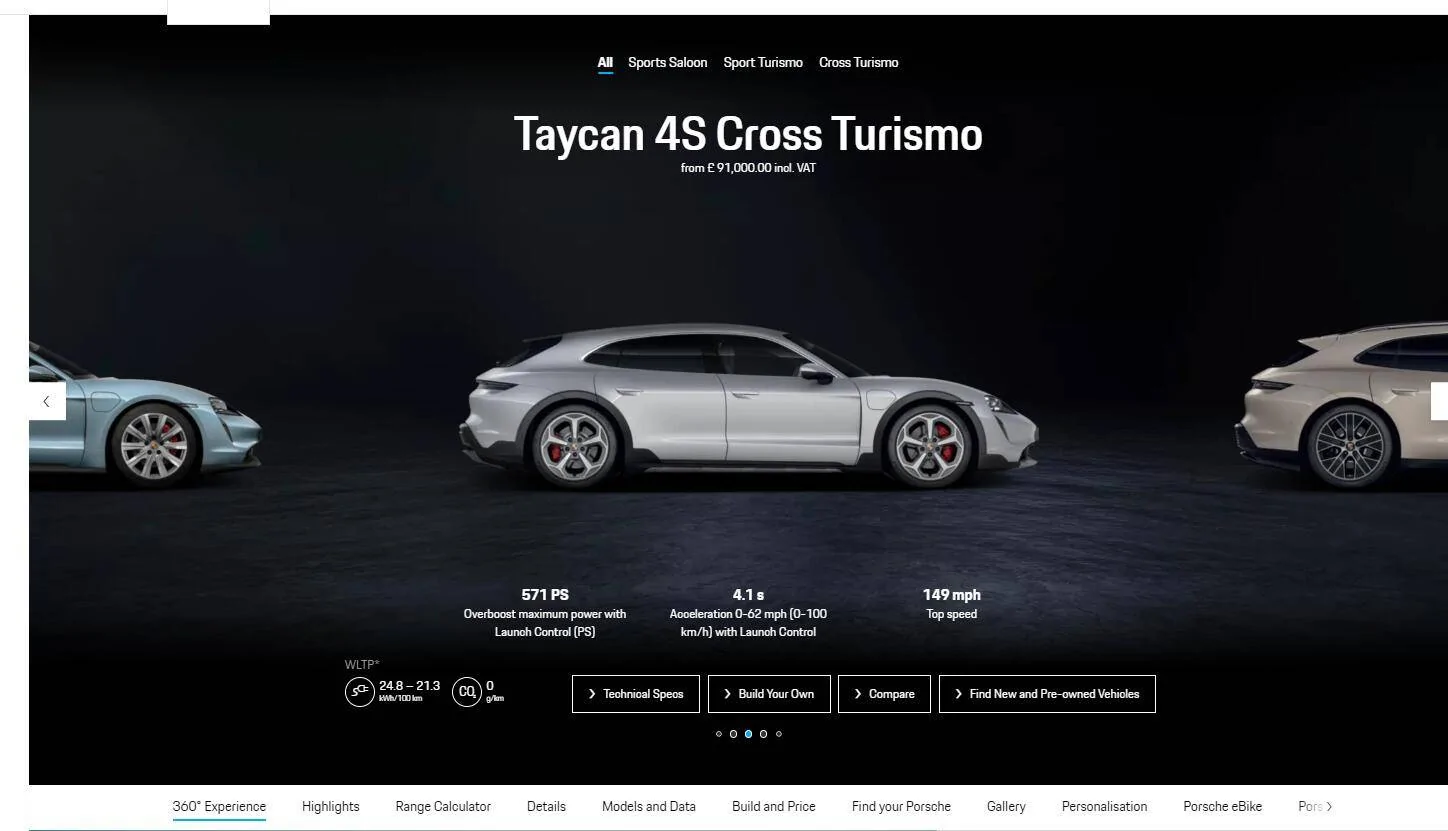

Did you not bother to look?
Review the Taycan pages on the Porsche website - select your model and then click technical details

I bookmarked that page since it had this and the range calculator on it. Unfortunately it has been updated and clicking on the bookmark no longer has all this detail and the range planner has gone too.
Whether it exists elsewhere on the Porsche site I haven’t checked yet but the link I have been using for the twent seven million years since I placed my order goes to a fairly useless page now :(
https://www.porsche.com/uk/models/taycan/taycan-models/taycan-4-cross-turismo/ then click 'Technical Specs' under whichever variant of Taycan you have selected.
All links to Range etc are further down the same page.

Thanks a lot, so it is still there! I have re-bookmarked it since the bookmark which used to bring me here no longer does.
Aye, bookmarks can be 'crazy' things these days (no doubt it will change again).

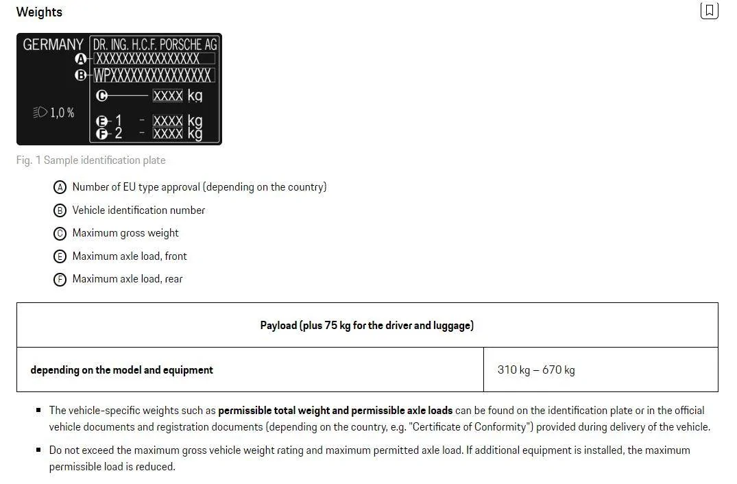

Ha ha!
This is what is listed in the online manual (not all details)
