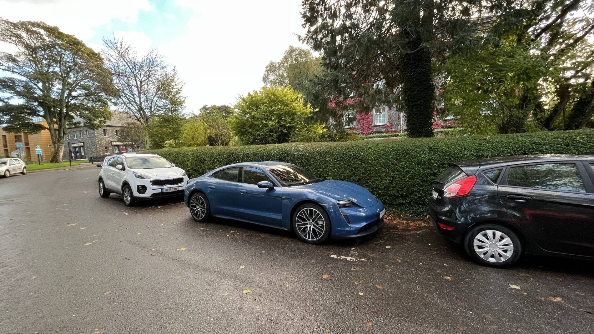

I haven't seen too many videos of this feature working so thought I'd share mine. Porsche describes it as:
The system automatically detects parking space. Once the system has signaled that the parking space is a sufficient size, the driver can initiate and control the parking process. The system automatically takes over the steering and the forward and backward movement of the vehicle. The Active Parking Assistance is able to park the vehicle in parallel and perpendicular parking spaces.
Here is a short video of it working in my car:
All the movements and actions of the car – including putting on the indicator – after I press the auto park button and pull forward to find the space – is entirely automatic. No hands on the wheel, no feet on the pedals.

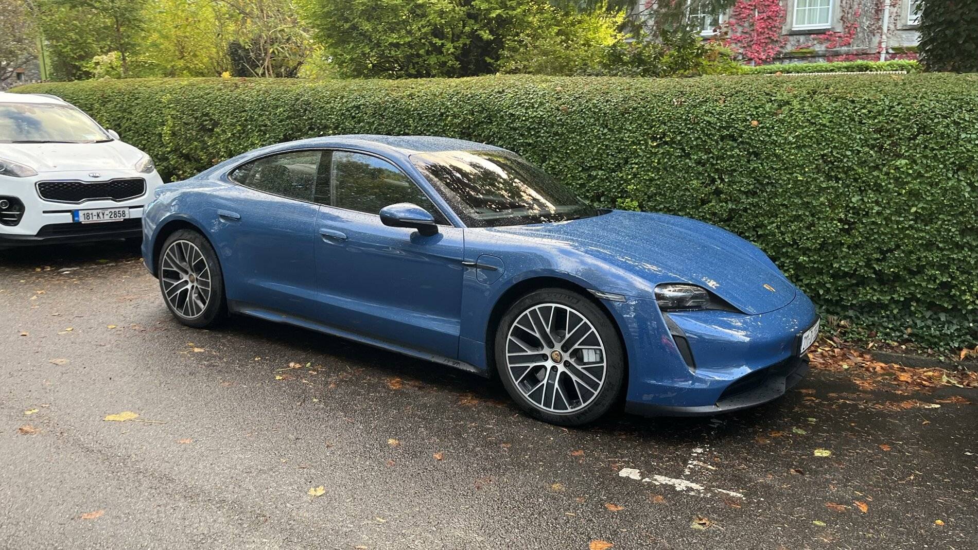

Here is my car parked after the manoeuvre:
