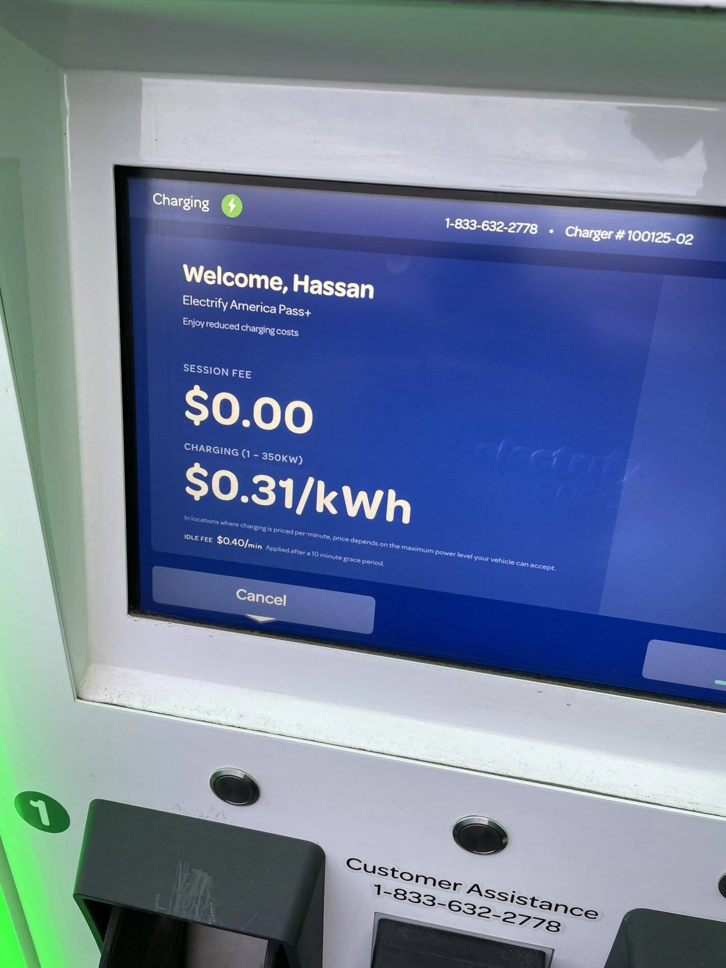

Technically it did! I am not Hassan but I plugged in and my Taycan immediately started charging...no apps or anything.
Hassan, dm me if you see this and I owe you money.

I just did a test at EA location:
Walmart 2643 - Woodbury, MN12 mi
10240 Hudson Rd. Woodbury, MN 55129
With my 2021 Taycan 4S and the plug and charge just worked. My charge rate was terrible but it was -10 F and the car had not pre-heated.
