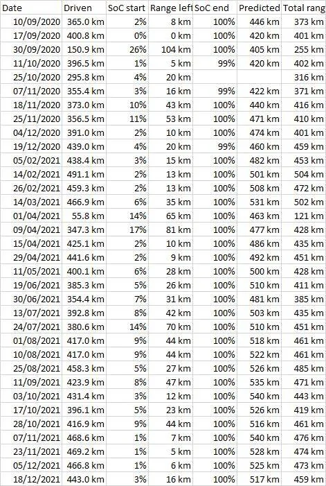

Until now I've been super careful not to go to 100%. TBH I've never kept a car for that long so I'm probably causing a lot of trouble for myself just so the next owner reaps the benefits but I can't help it.
Funny, I am the opposite. I want to learn and see what the battery is made of. I always charge from very low to 100%, as if it was an ICE. The advantage is, that I only have less than 40 cycles for 18000 km.

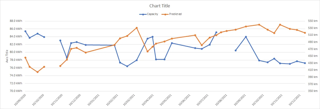

It also gives me a good idea about degradation, which also happens with age alone.
Porsche Taycan Direct charging mode stays on until you turn it off again? 1641004379579
Even if the battery has a 20% degradation, it still works fine for me - and after 5 years and about 150 cycles, not my problem anymore... ;)
