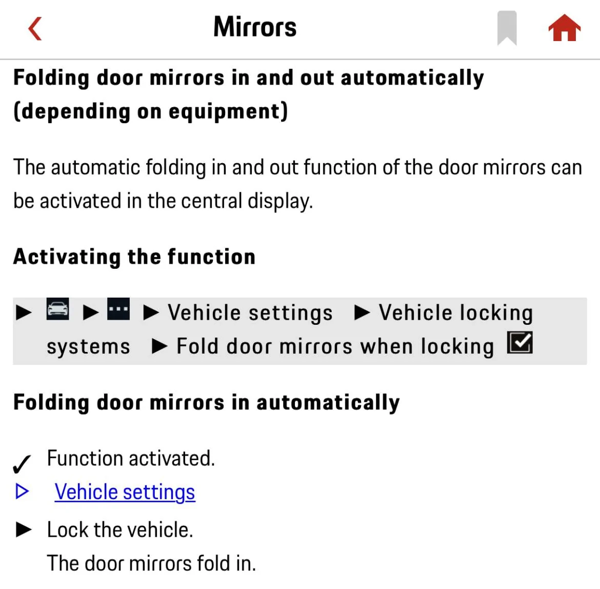

You should be able to disable them from folding in automatically.
The setting should be under:
- Vehicle settings
- Vehicle locking systems​
- Fold door mirrors when locking​
From GTK:
Porsche Taycan Disable folding mirrors? F62462B6-0AC7-42A4-B830-3870FFE96D9F
