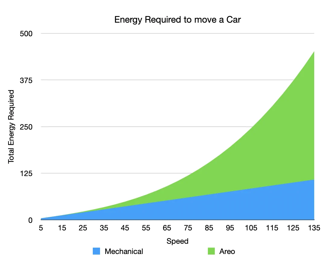

the chart below is 100% fabricated and does not represent any factual values for _ANY_ vehicle I'm aware of - but it is conceptually accurate as a mental model of how as speed increases the contribution of aero-dynamic loads becomes greater than the linear cost to "just move the car" from a pure mechanical physics point of view (rolling resistance/friction/weight which are constant and linear) - again this is a "conceptual" model to illustrate how when one increases speed the aero component becomes greater than the technical component in a non-linear increasing fashion…
please don't quibble with the actual numbers - they are meaning less - but conceptually accurate in terms of aero dominating cost in a non-linear/increasing fashion…it's a demonstration as an example - and not entirely inaccurate for the theory and illustrative that aero does dominate costs as speed increases - I'll leave it to mechanical/aero engineers to provide a real world model, but will assert the basic change may differ in scale/ratio but not in concept.
you'll note on the chart that aerodynamic drag in this model does not play a significant role until around 50 mph - but from that point forward it starts to dominate incremental cost as speed increases…the chart/model I fabricated was "hand tuned" to achieve this inflection point - but that is representative of real world - where in fact between 40 & 50 mph is where aero starts to appear in cost equations as a meaningingful factor, and by 60-65 mph is a majority factor in cost to move the vehicle…
even though each change in speed only 10 mph (linear) the cost is non-linear - each mph-unit added costs more than the previous mph in incremental costs…
while the units of power above are "made" up the scale/change is not - each mph costs more than the previous mph after 50 mph - and you stack all these on top of one another and pretty soon your Taycan can only drive like 70 miles at say 100 mph…
this gets really really expensive power wise very very quickly - and is also why reducing speed is so effective - you're gaining more range which each mph slower you are going, than losing in terms of speed…
an EV that say can go 300 miles on a full charge at 50 mph, can only go 180 miles at say 70 mph, or maybe only 140 miles at 80 mph…

until about 40-50 mph all the energy expended on moving the car is over coming mechanic friction and weight - with the amount of energy required to over come aerodynamics being “insignficant” at lower speeds…
however as one gets above 50 mph the portion of power being expended to overcome aerodynmic drag becomes signficant and dominant and overwhelms the basic cost of moving the car

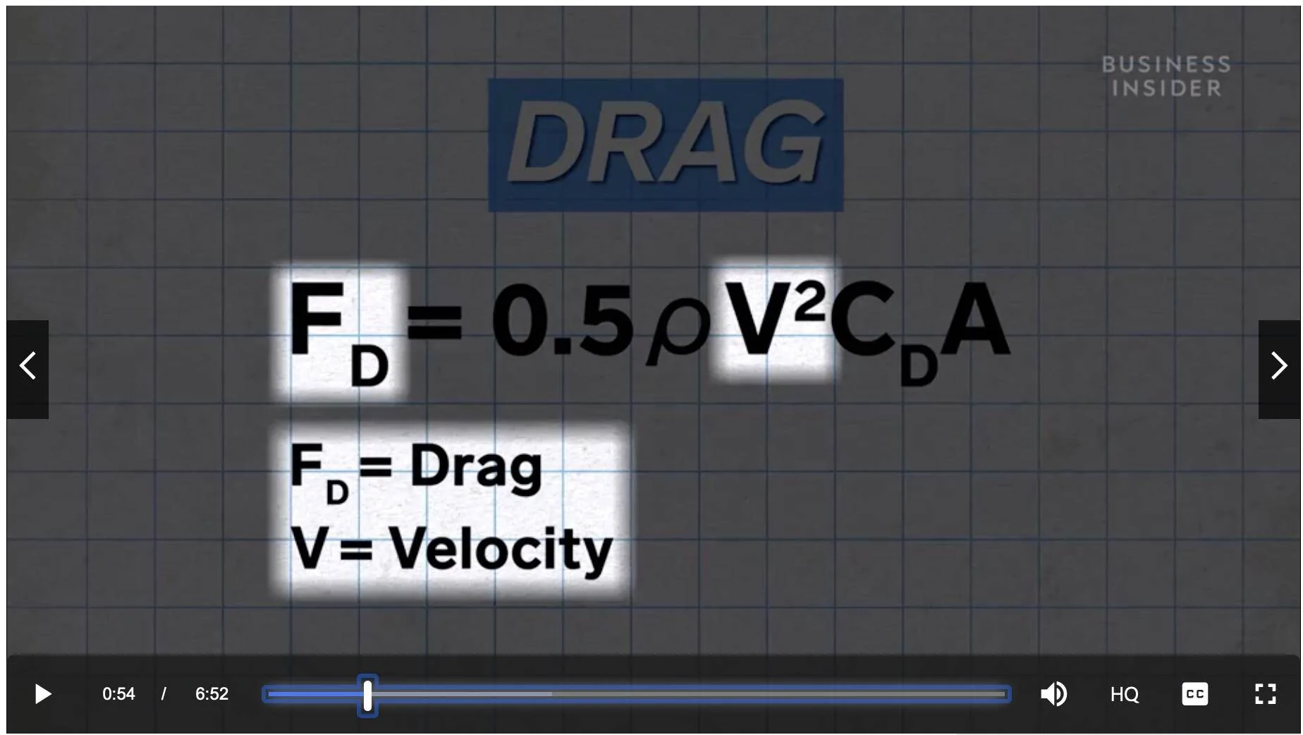

as speed increases the power required to offset the aerodynamic drag has a velocity^2 (squared) component and it gets really expensive really really quickly…

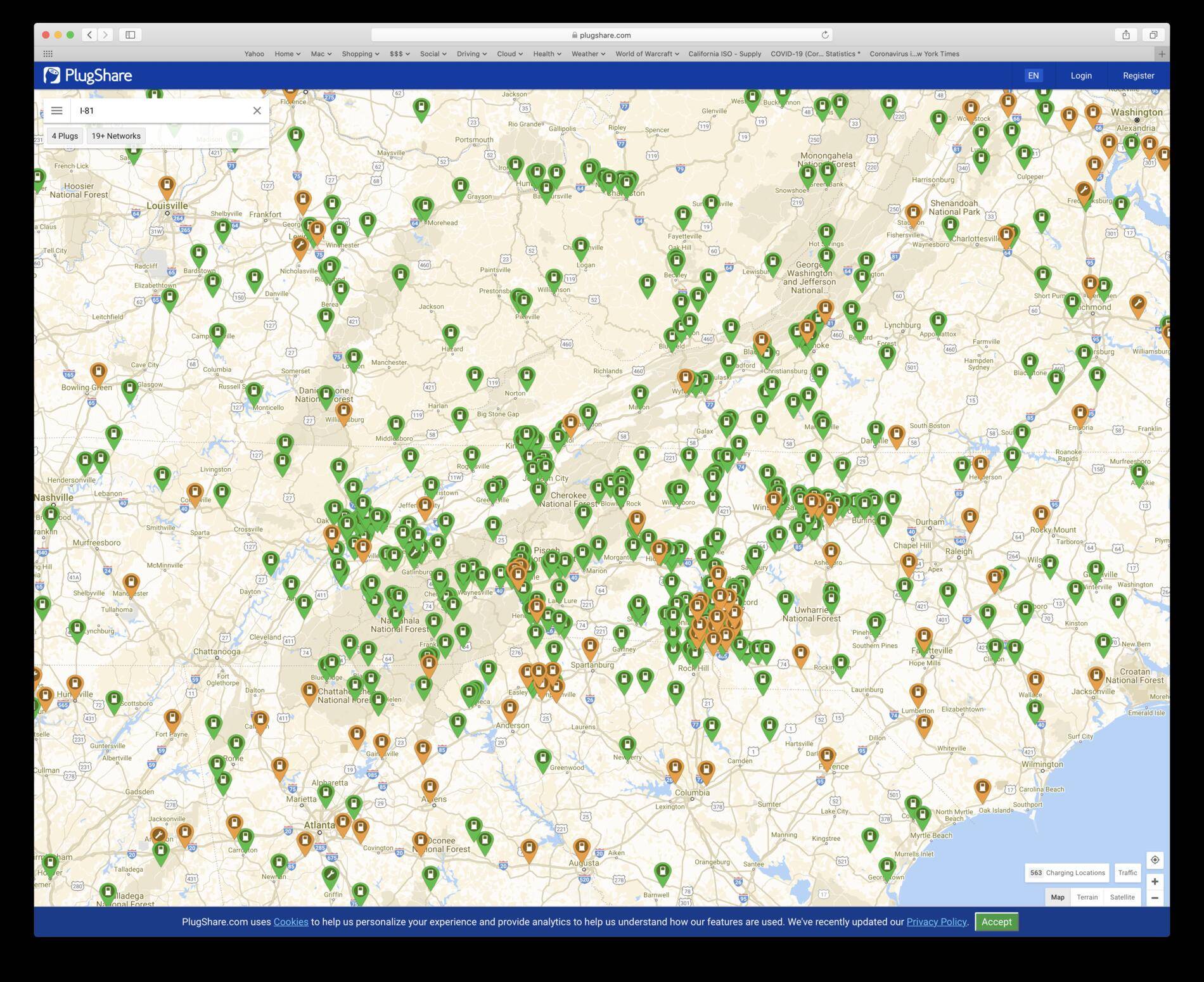

EV road tripping requires a little planning up front, and I highly recomend using plug-share to evaluate the reliability of fast charging options along your route.
Dave,
Really great information. That should be extracted into a “Welcome to EV Driving FAQ” which we should write/assemble sometime... soon.
I just wanted to expand on a subject you touched on: “the reliability of the EV charging network”.
Our charging network is different that Tesla’s. We don’t have a Single Supplier, Single Provider network. We have a mishmash of networks, and even within the single most important network for Taycans, the ElectrifyAmerica network, they have four different suppliers of DC Fast chargers.
And we use a Porsche-written App to start charging sessions. And Porsche lags behind in features that the EA App has had for months. The EA app is a good backup, though.
But my main point is this: You cannot rely on that charger 200 miles away to be working. Yes, you can easily make it there, but what if it fails? Where is the next one? If you have 230 miles of range (in your particular driving style, weather, terrain, etc) but the next Charging Station is 50 miles further on, you are in trouble if your first choice (200 mile) station is out of order.
You’ll learn to charge more often on long road trips, to reduce risk.
If you like risk, then by all means, drive to a station 220 miles away that sits in the middle of a desert, 75 miles from anywhere else. I’ve done it. Fingers were crossed, anxiety was high.
Know where your backup stations are. Arm yourself with lots of Apps: (EA, ChargePoint, PlugShare, ChargeHub, EV Hotels, ABRP, Flo, EVgo, etc.)
Teach your navigator (spouse, child, cat, whatever) to use those Apps, and to use the car’s Nav to find other backup stations.

I will 100% agree with @louv - pre-trip charge location planning with plug-share is critical!

here is a plug-share screen shot for I-81
there is good coverage of EV chargers in this area of the country - so planning and have some backup plans appears to be very reasonable - green "pins" are L2 chargers (9.6 kW or less - the vast vast majority are likely 6 kW public chargers - 208 volts * 30 amps) - and orange chargers are DC Fast Chargers 25 kW or more…
clicking on individual "pins" will allow you to see any recent "check-ins" for charger's operational status, and it's over all "score" for reliability - 1 = very low reliability 10=near flawless reliability
Chattanooga appears a little spares so you might need to get creative if you're going to charge in that area…otherwise I'd travel around in this area worry free based on the high number of chargers indicated on the map.
