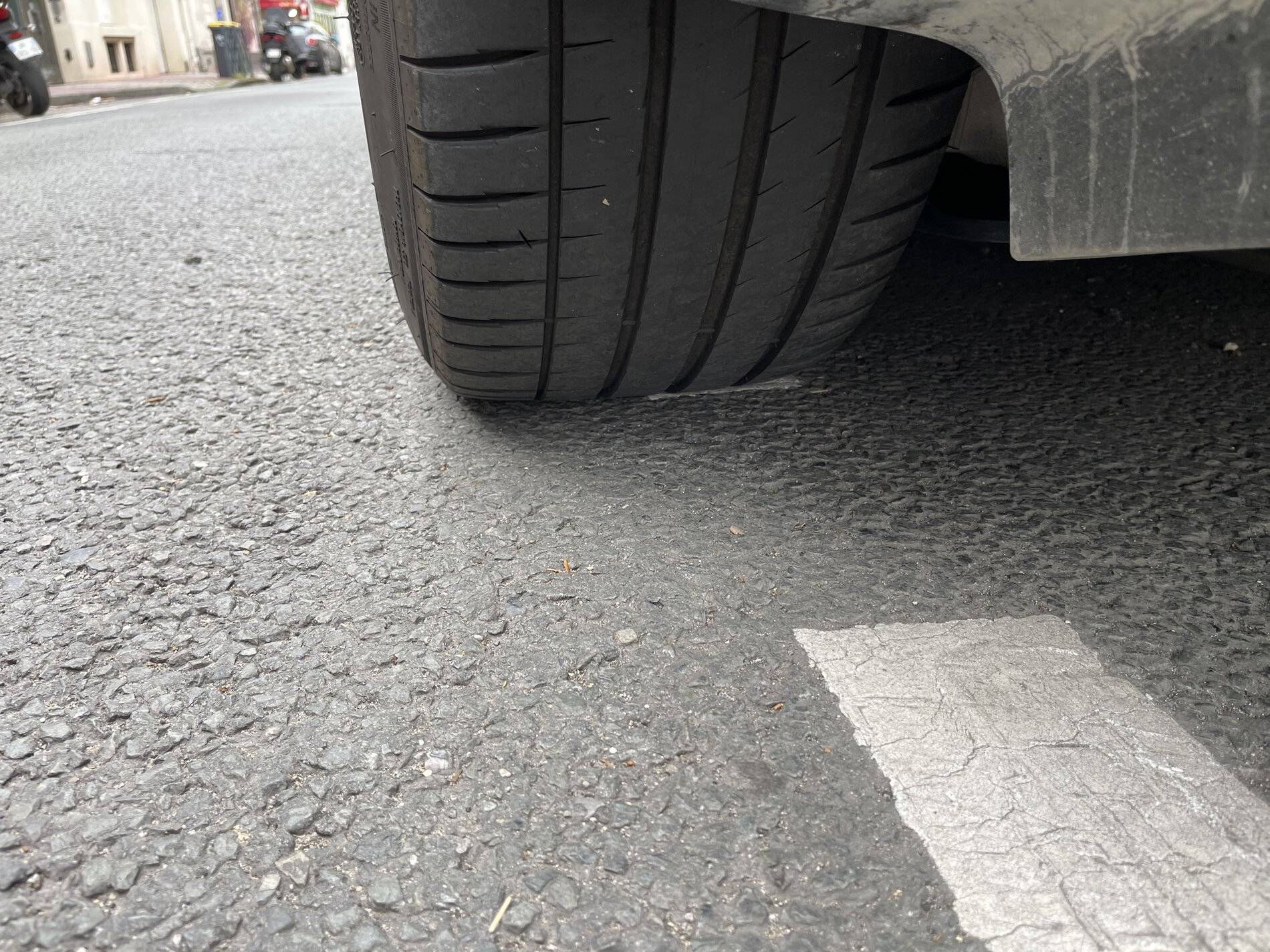

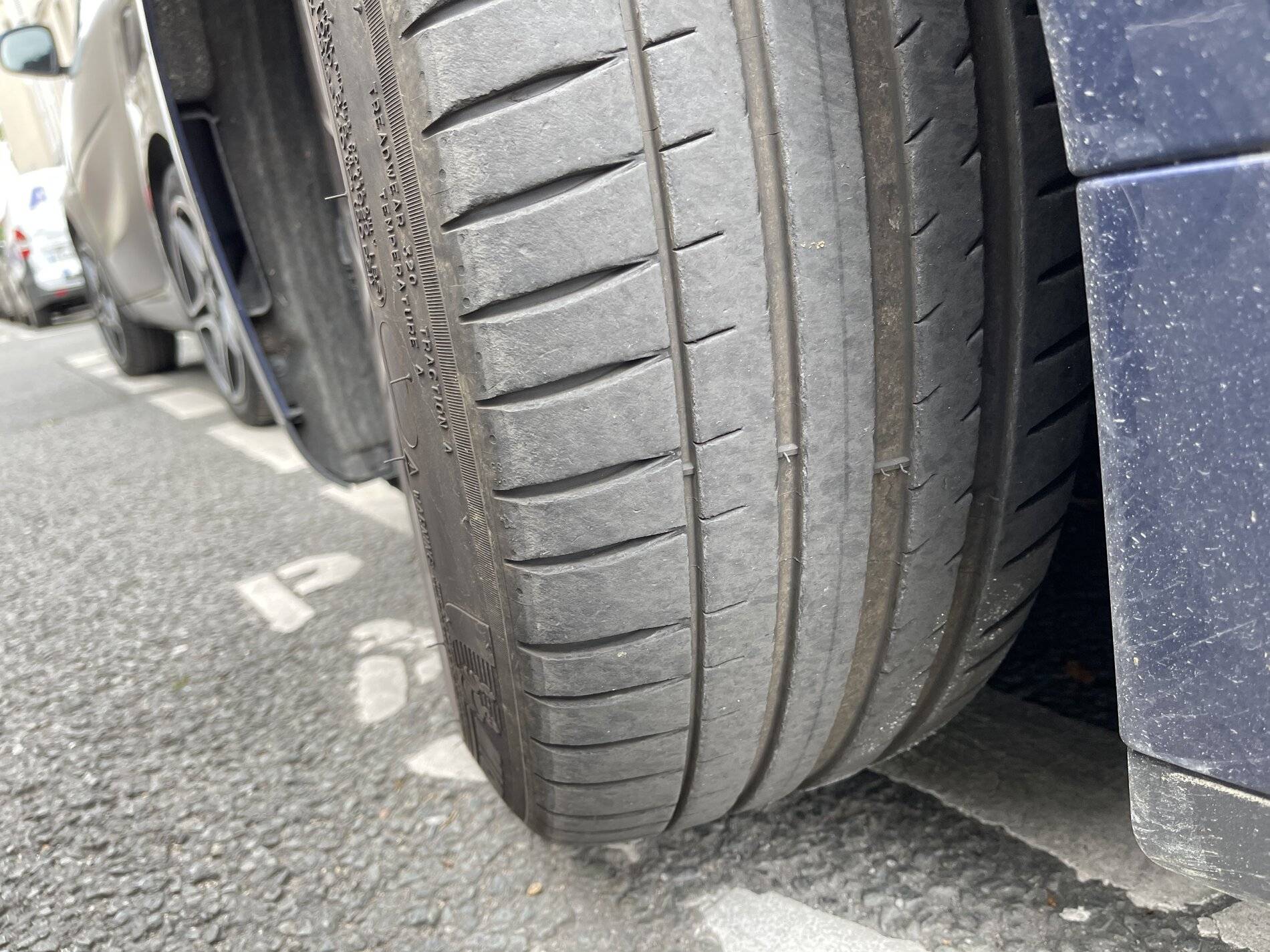

Hi guys!
I hope you are well :)
I drove for 15000 km with the Taycan with the same tires (yes, I know, it’s not a good thing but weather is too incertain in Paris ?).
Today, I’m wondering if I have to change it.
I have Michelin 20 inches.
What is your thoughts when you look at these pictures from front and rear?
I have the feeling that the middle band are a little bit used and can impact my range.
Thanks for your help!

They look just fine to me with the distance you have driven. Perhaps check your tyre pressure if you feel the middle part of the tyres have worn more than the rest

Based on the wear indicators there's about 25% life left in them. Tire pressure definitely looks too high for your driving habits as seem by more wear in the middle than on the shoulders. Those looks like the summers so you probably have around 3,500KM left in those tires before time to replace. You'll want to take it easy in standing water.
