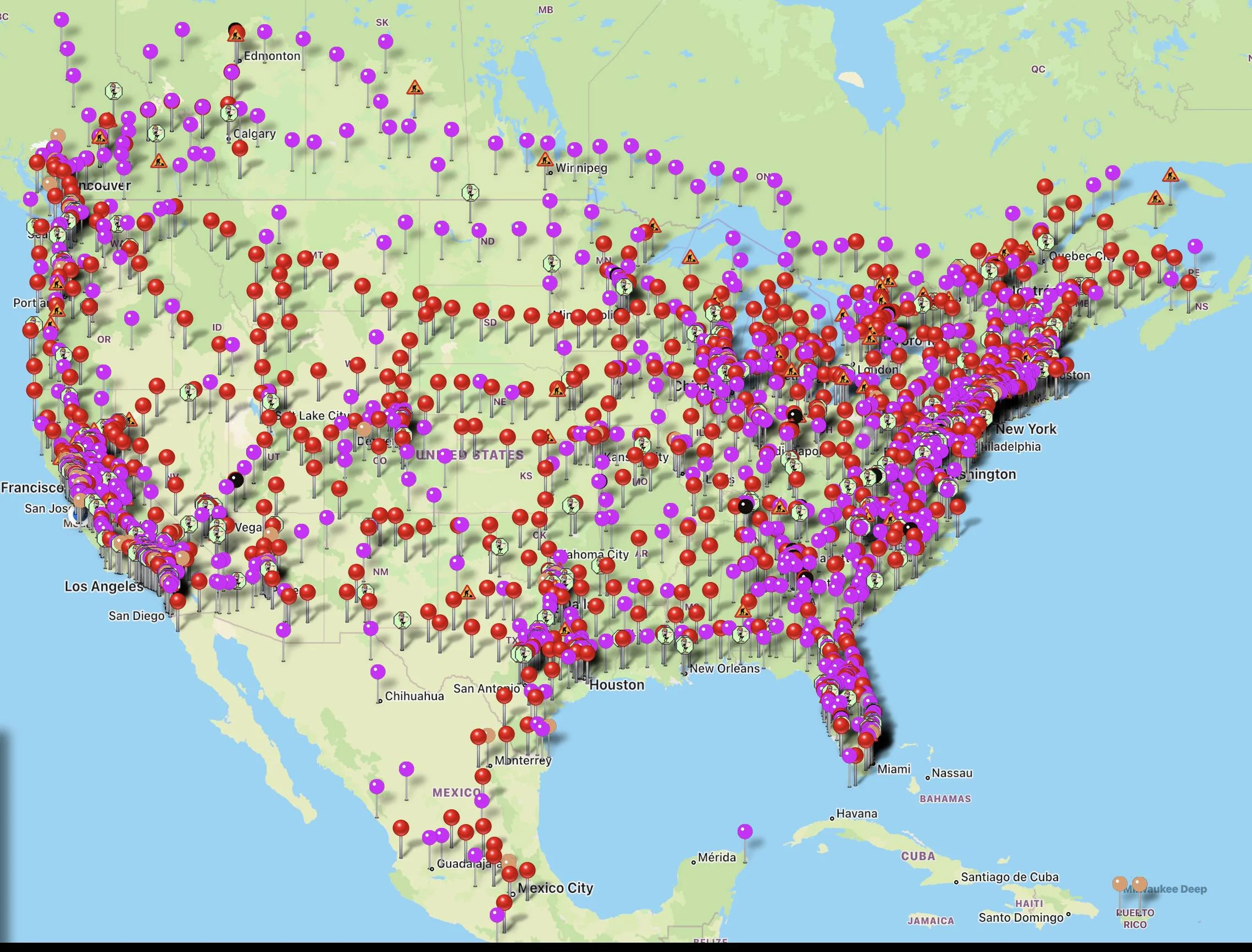

I’m also finalizing my specs and originally had this on my build. I watched a YT video that suggested adding it because A) it was cheap and B) it helps to future-proof the car. Then I watched and Inside EV’s video with Tom M. from 2021 and he said it was a waste of money because there wasn’t a single 400V charger in the US… or something to that effect. I will likely be charging at home or work with a low probability of long road trips and using DCFCs, at least for a few years. Possibly longer drives to work in the future that would require use of DCFCs - 300 mile round trip with a quick charging session. So the question is, what would I really be missing if I left this off the build?
Tom M's statement is accurate and inaccurate at the same time - he is correct for CCS stations - but incorrect for the most functional/ubiquitous and reliable FastDC network which is the Tesla Supercharger network…
every single Tesla Supercharger is a 400V FastDC charger - or when it is open to CCS vehicle's it will be.
if you do not spec it you will be limited to charging at 50 kW at all the Tesla Superchargers
if this is your first EV you'll end up using FastDC charging more than you think
what we're talking about here is your time when you stop to charge
what is your time worth
I think $460 is a cheap option to save time - but I could be wrong…
here is all the locations you'll be limited to 50 kW int he future if you do not spec the option.
Hmmm... your statement above is based on two assumptions:
  1. You are assuming Tesla will in fact offer an adapter of retrofit all of their locations to include CCS before today's Taycan end-of-life. Unlike some folks, I don't know that this is a given. I see them more building dual stations only where they get subsidies to do so. Even then, I am not sure they are incentivized to match the CCS rate to their Tesla DC charging rate. Wouldn't be the first time Tesla does something just to satisfy subsidy/grant requirements - remember the Tesla Battery Swap project - faster than an ICE fill-up? They built exactly one station, which qualified them for the grant. Got some great PR out of it too.
  2. You are assuming the map above does not change by the time Tesla opens up the Superchargers to CCS (since you said here are "ALL" locations). :p
