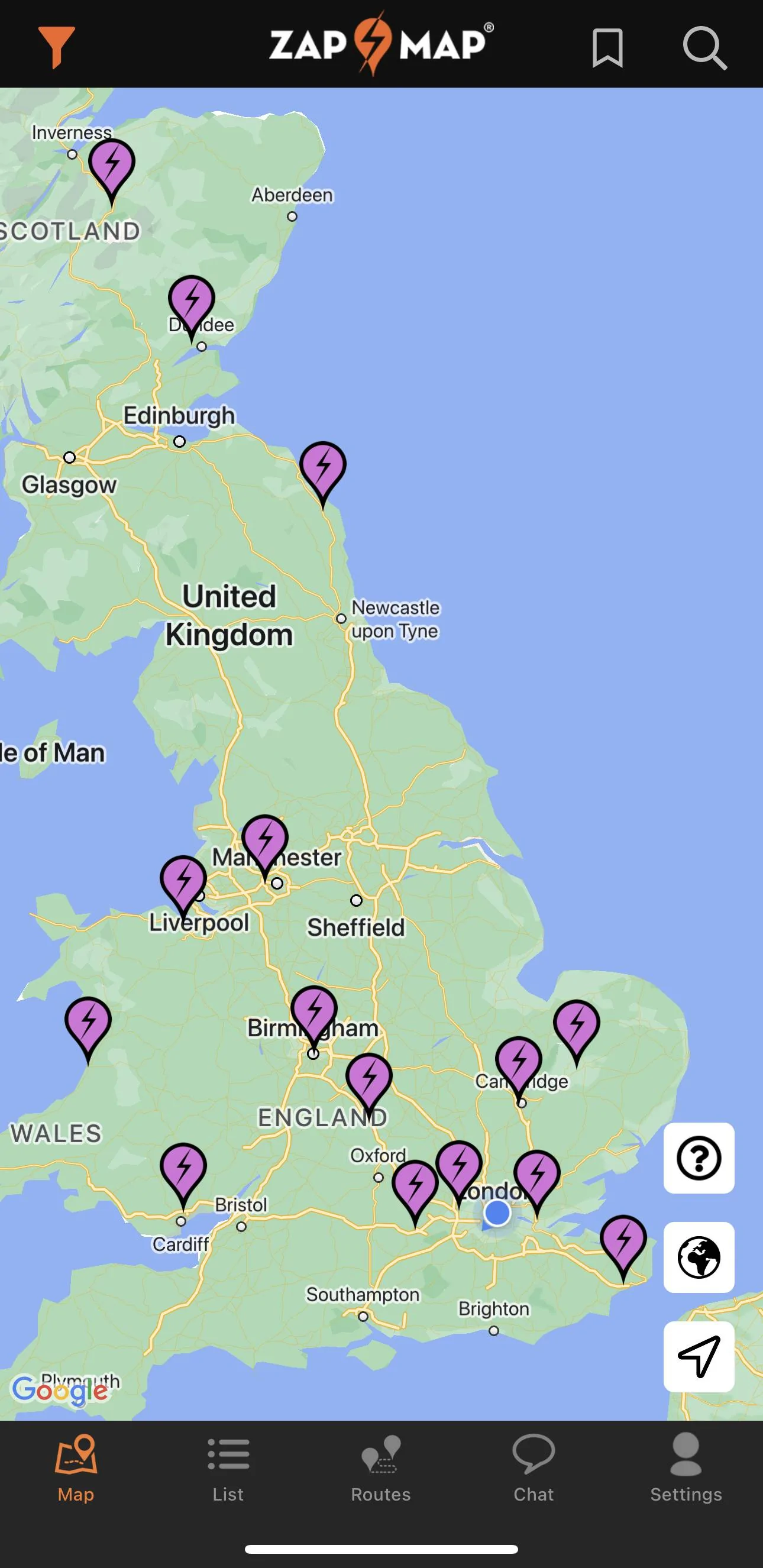

Not all of Tesla has been opened up - only 3 in Scotland for example but as they say "every little helps".

15 so far across the UK. More are rumoured (there was an accidental data leak a few weeks ago on Tesla’s charging map…)
