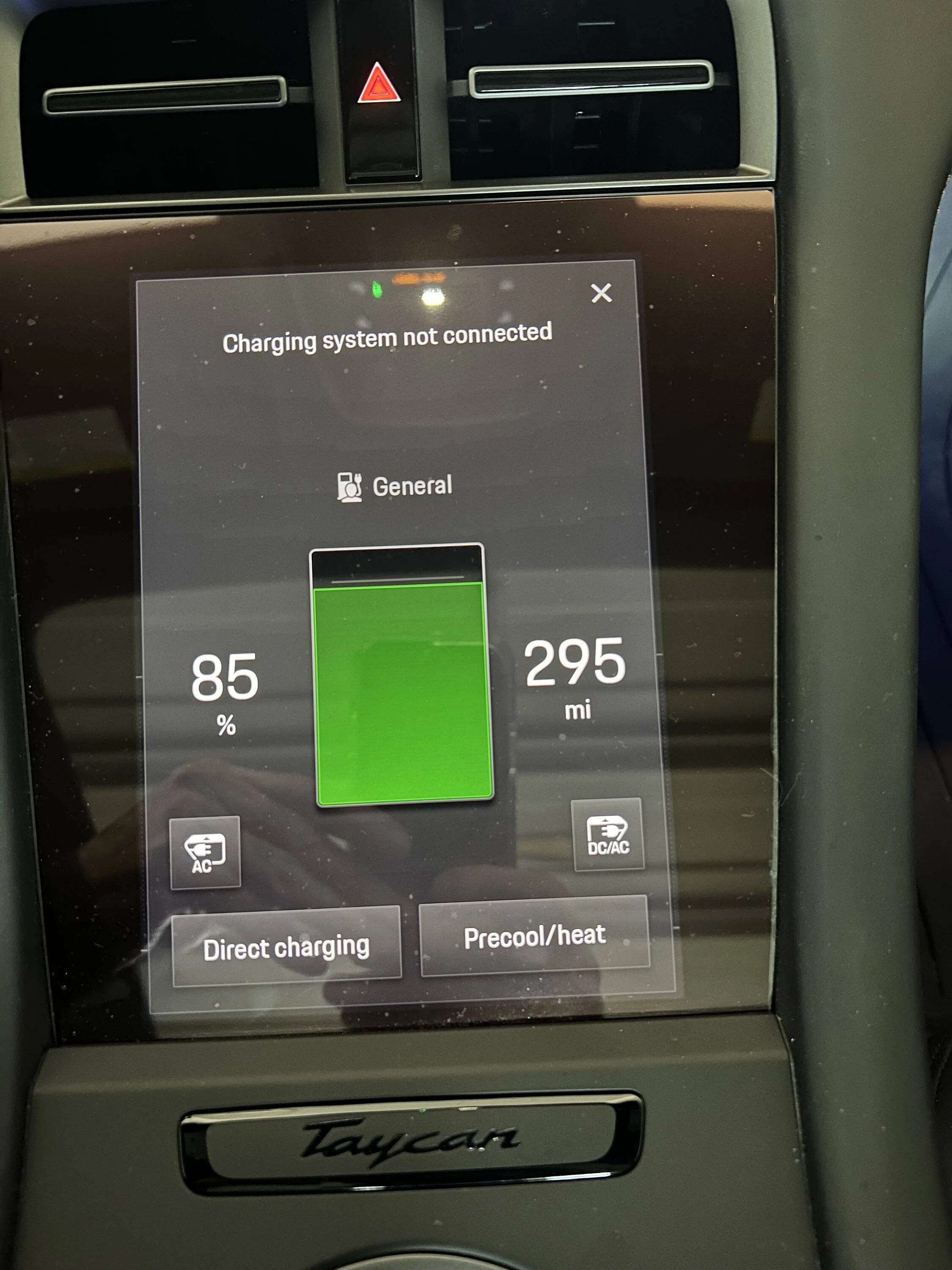

Let's do this for science:
20:30, I'm going to use the car in 12h only
Porsche Taycan Do you lose battery % overnight? Screenshot_2023-05-25-20-29-26-56_842b4389820829b7900b72d042499707
Let's see tomorrow morning.

Sharing image of battery and range from today. Held same charge for past three days since charging. Had not driven for 3 days.
Porsche Taycan Do you lose battery % overnight? IMG_3779

I bet it will be same tomorrow morning just to make it look like I'm imagining things
