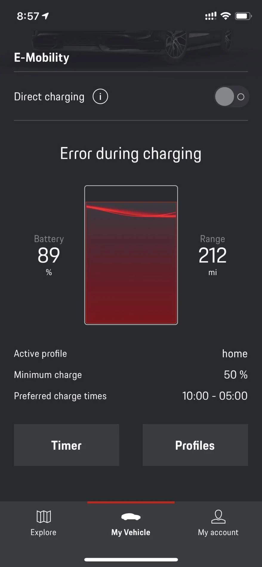

The next morning, yesterday, I wake up and check the iPhone app at about 7:30am: the car is nicely charged as requested.
At 9:51am, my phone rings from an unknown number. I answer, and it's the Porsche Connect Security Team. "There's a problem with your car." "What's the problem?" "First you need to answer your two security questions..." <redacted> "<laughter> Yup, that's right. OK, either your car was broken into or there a problem with the battery." "Uh... those are really different things. OK, I'm out at the car now. No problems. No windows broken, no damage." "OK, well, have a good day, Call us back if you have any questions."
At this point I notice the car hasn't automatically unlocked. Odd. I grab the remote from my pocket and press the unlock button. No joy. I think maybe it's the remote. I read in the "Good To Know" Manual, to place the key near the upper right corner of the rear window and press unlock. Nope. Nothing.
I look at the Porsche Connect App now... It looks like this:

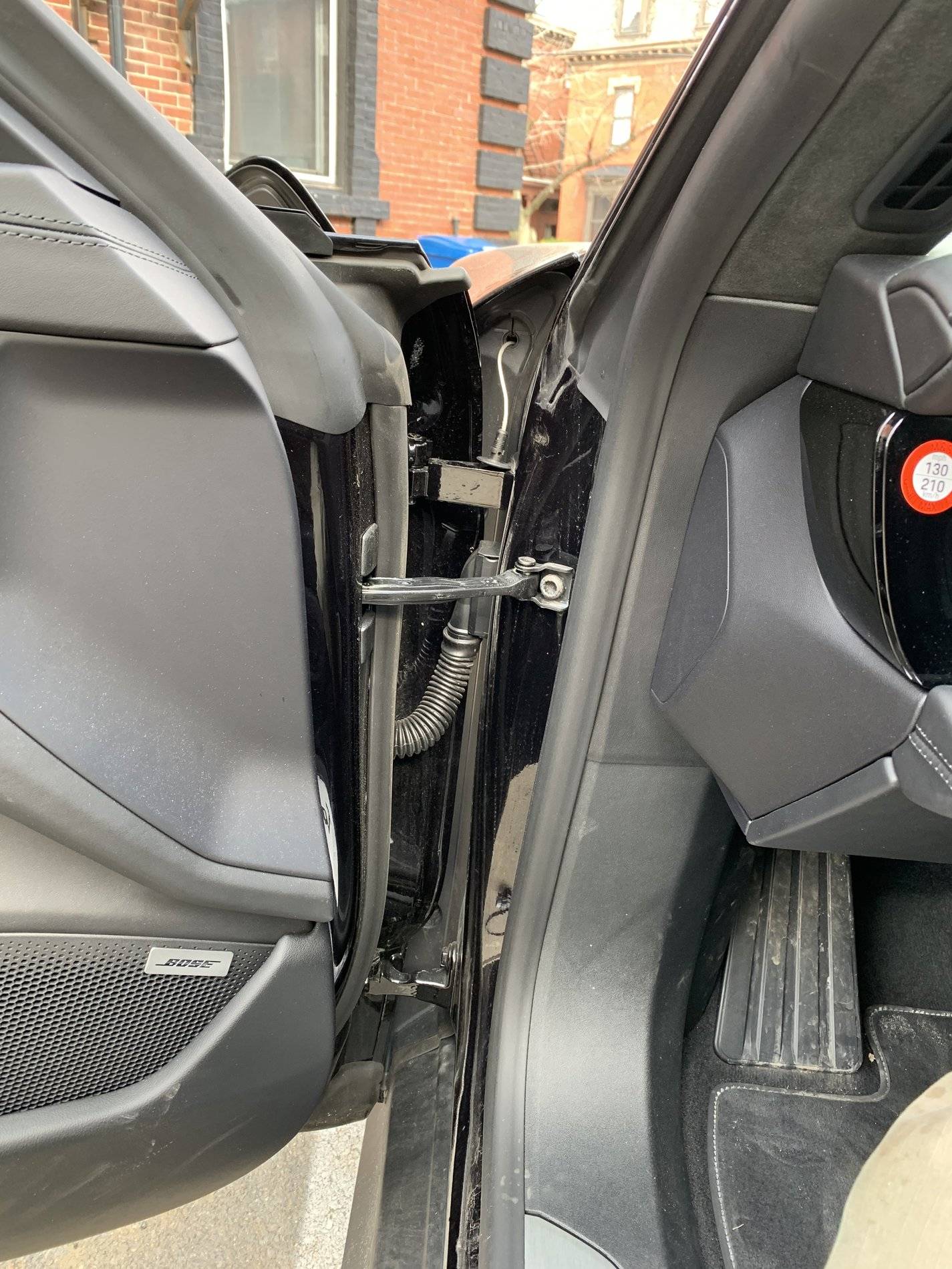

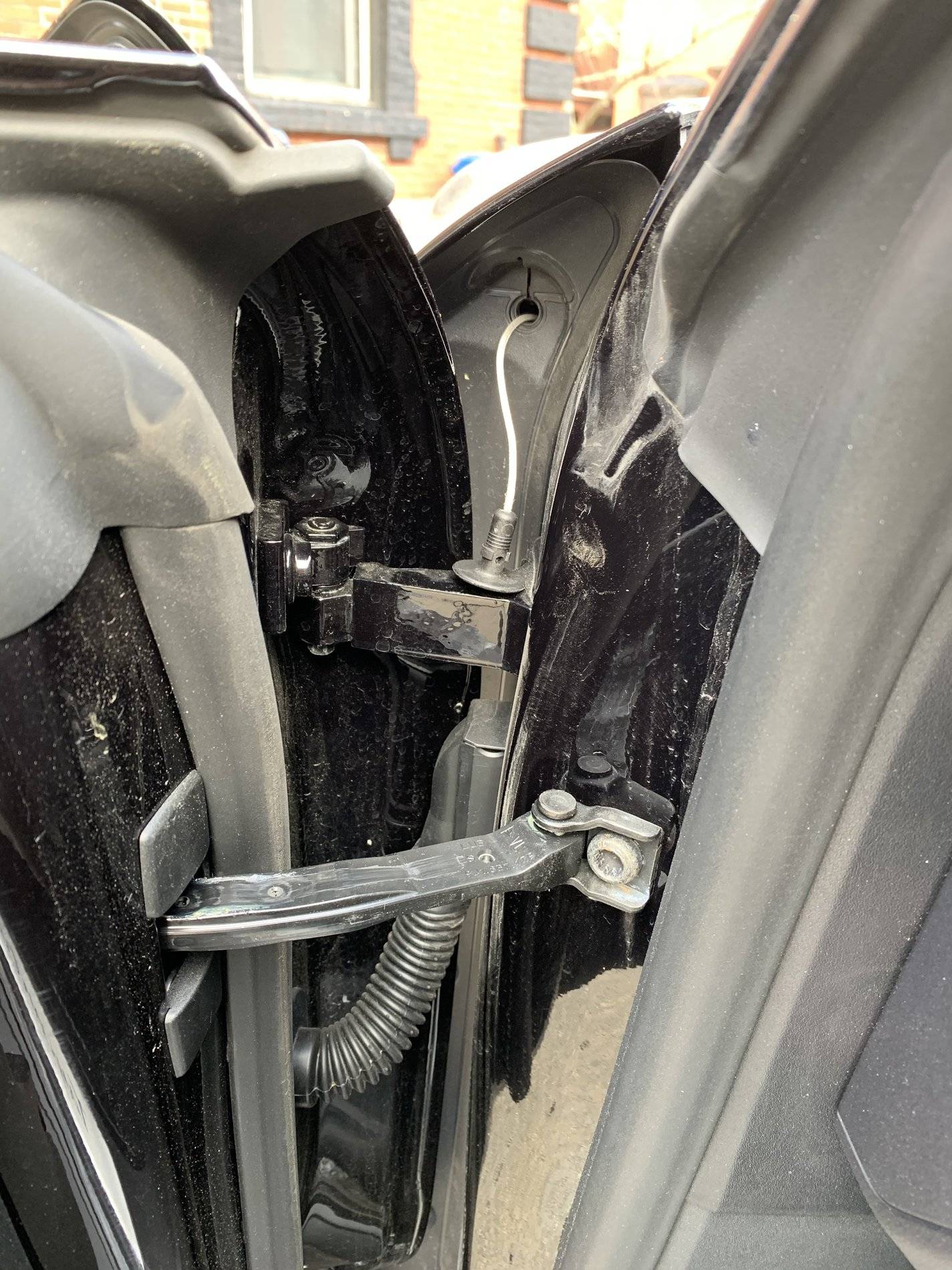

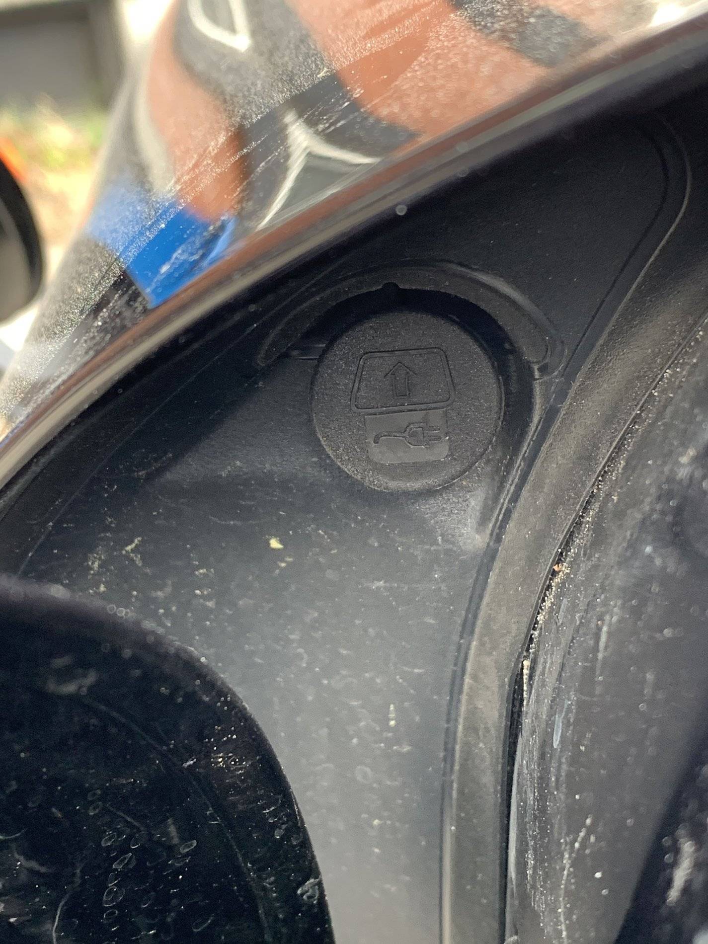

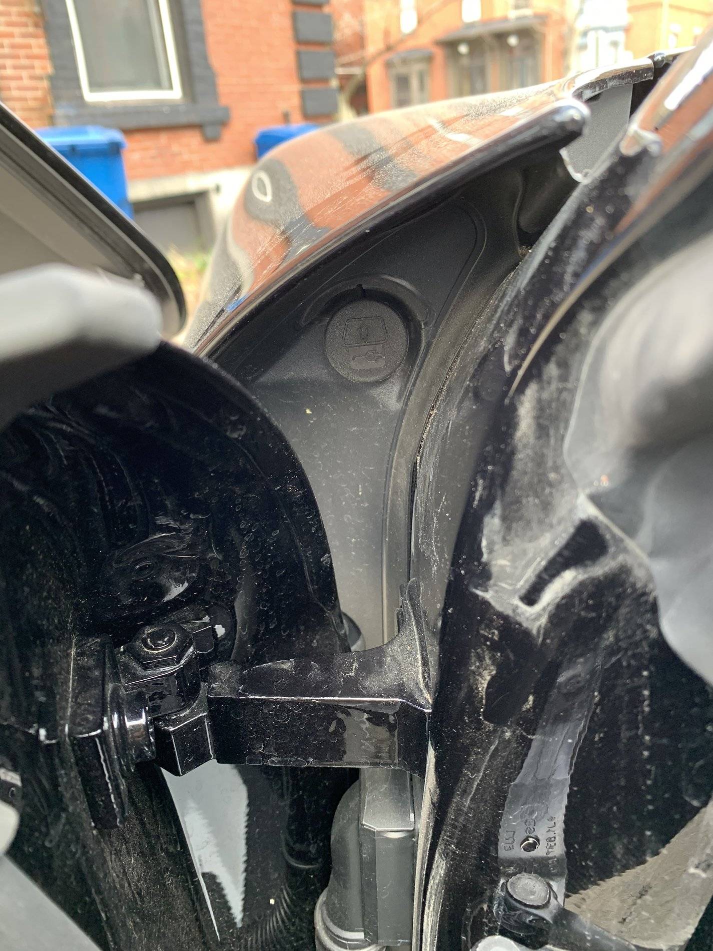

Before the car can be towed, I have to unplug from my Charging Station. Hmmm. The car is locked. The car won't let go of the charger plug. There *must* be an emergency release somewhere. Back to the "Good To Know" app, to read the manual.
To Remove the Charging Stations' plug from the car:
1) Open the front door, on the side where you are plugged in.
2) Look for a round button at the top of the front body panel.
3) Pull on that knob, which is connected to a cord, which will release the lock on the charging station plug.

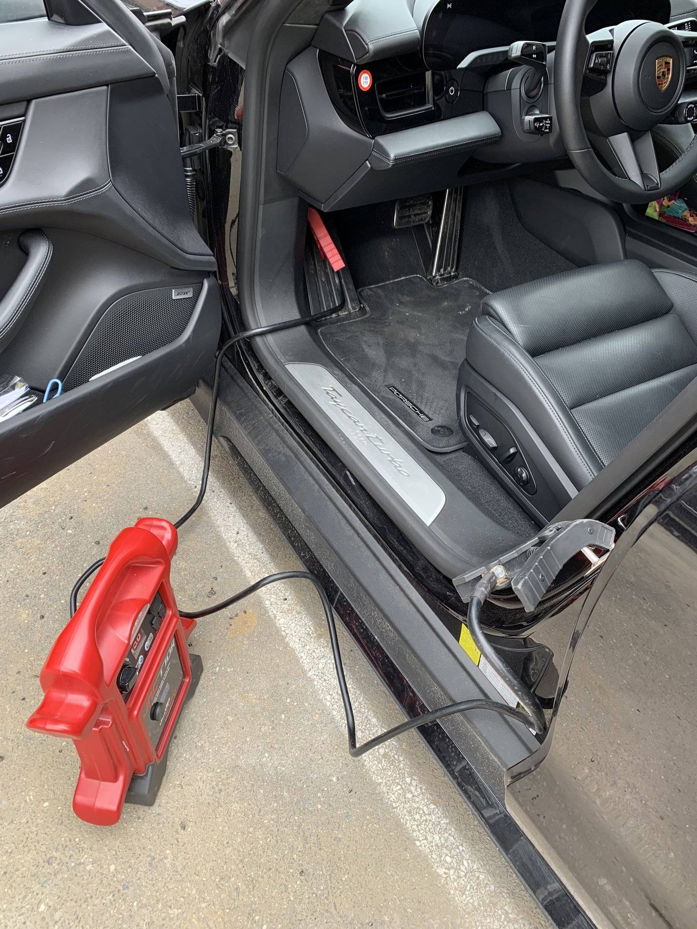

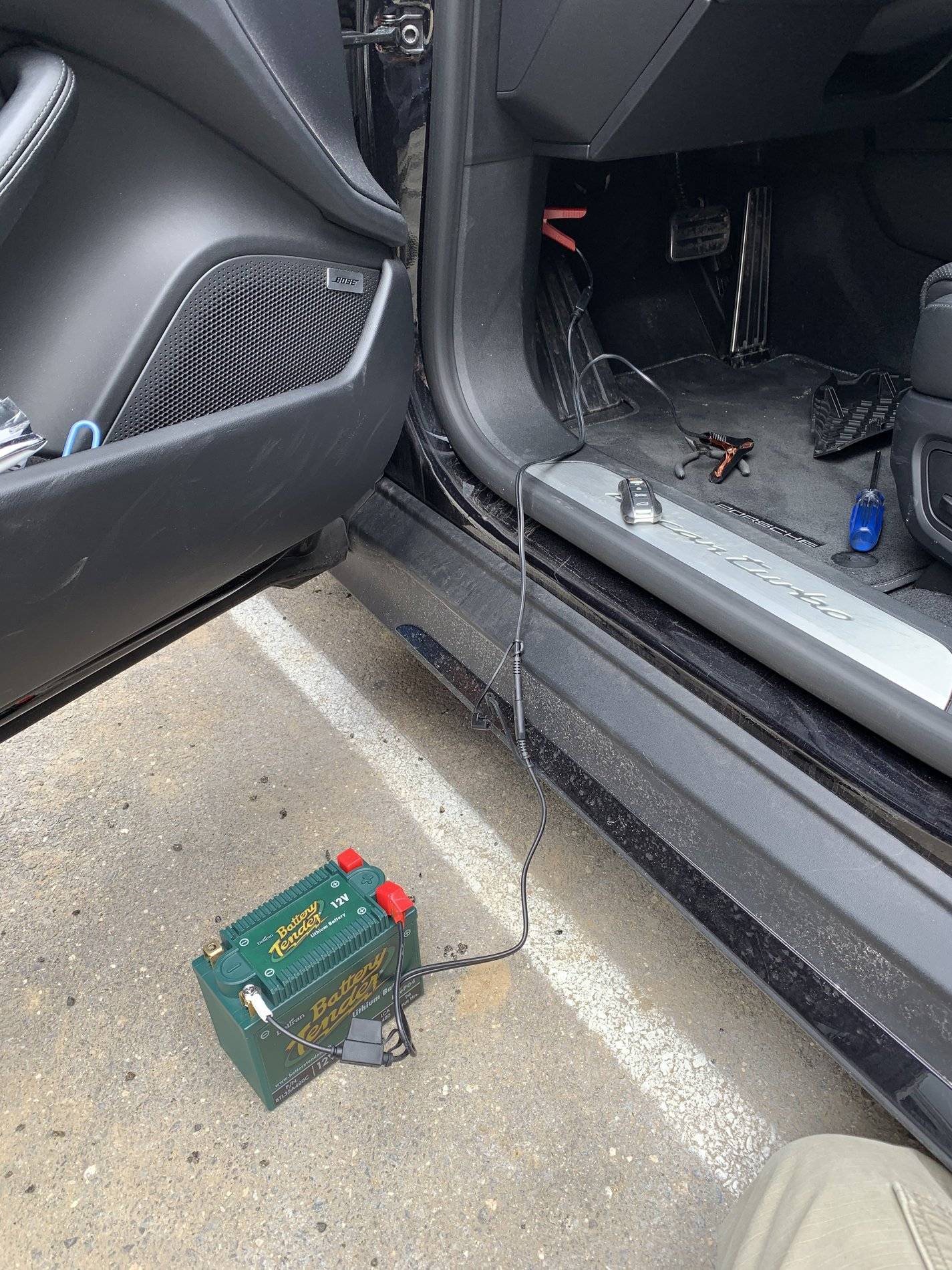

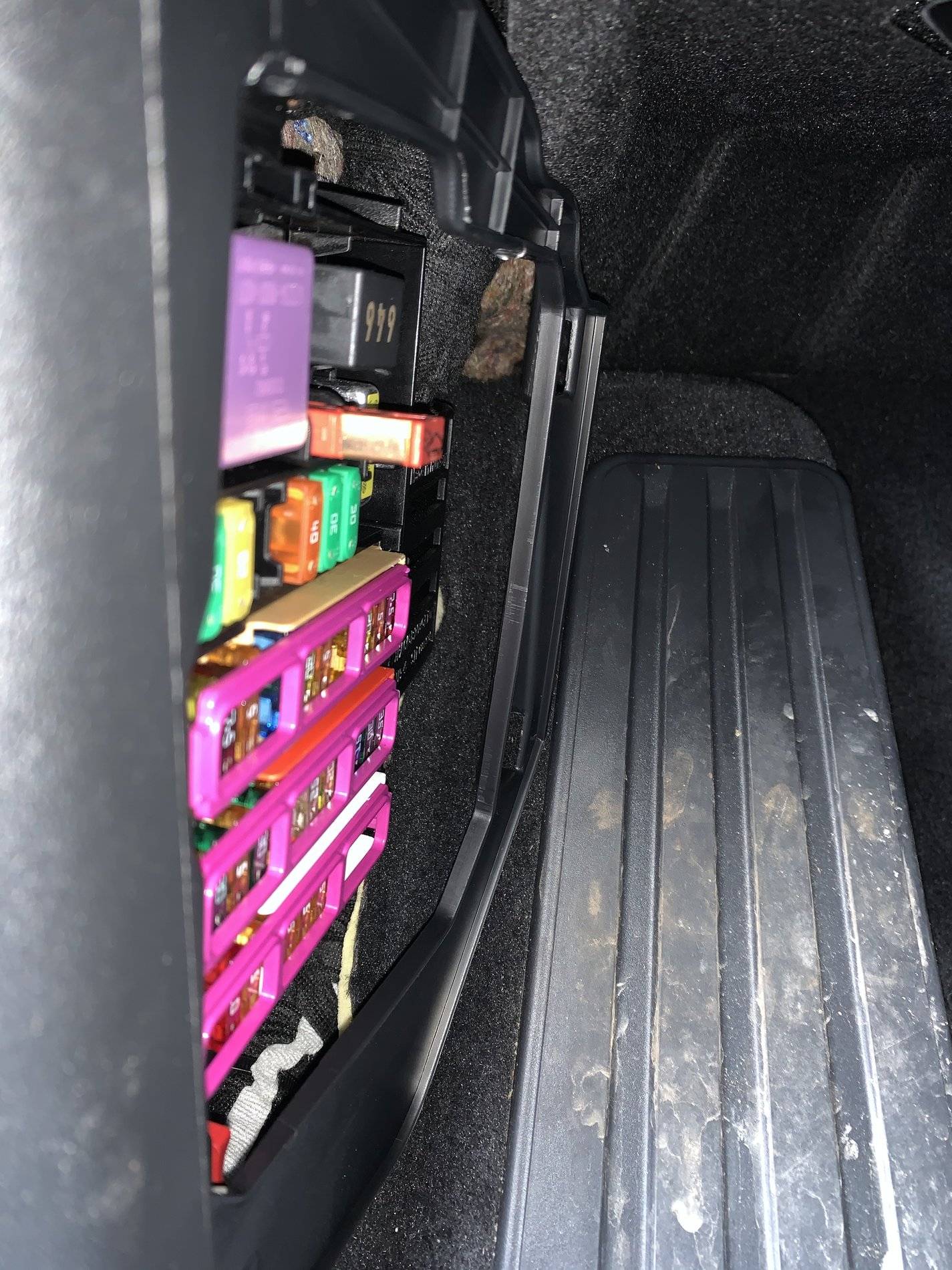

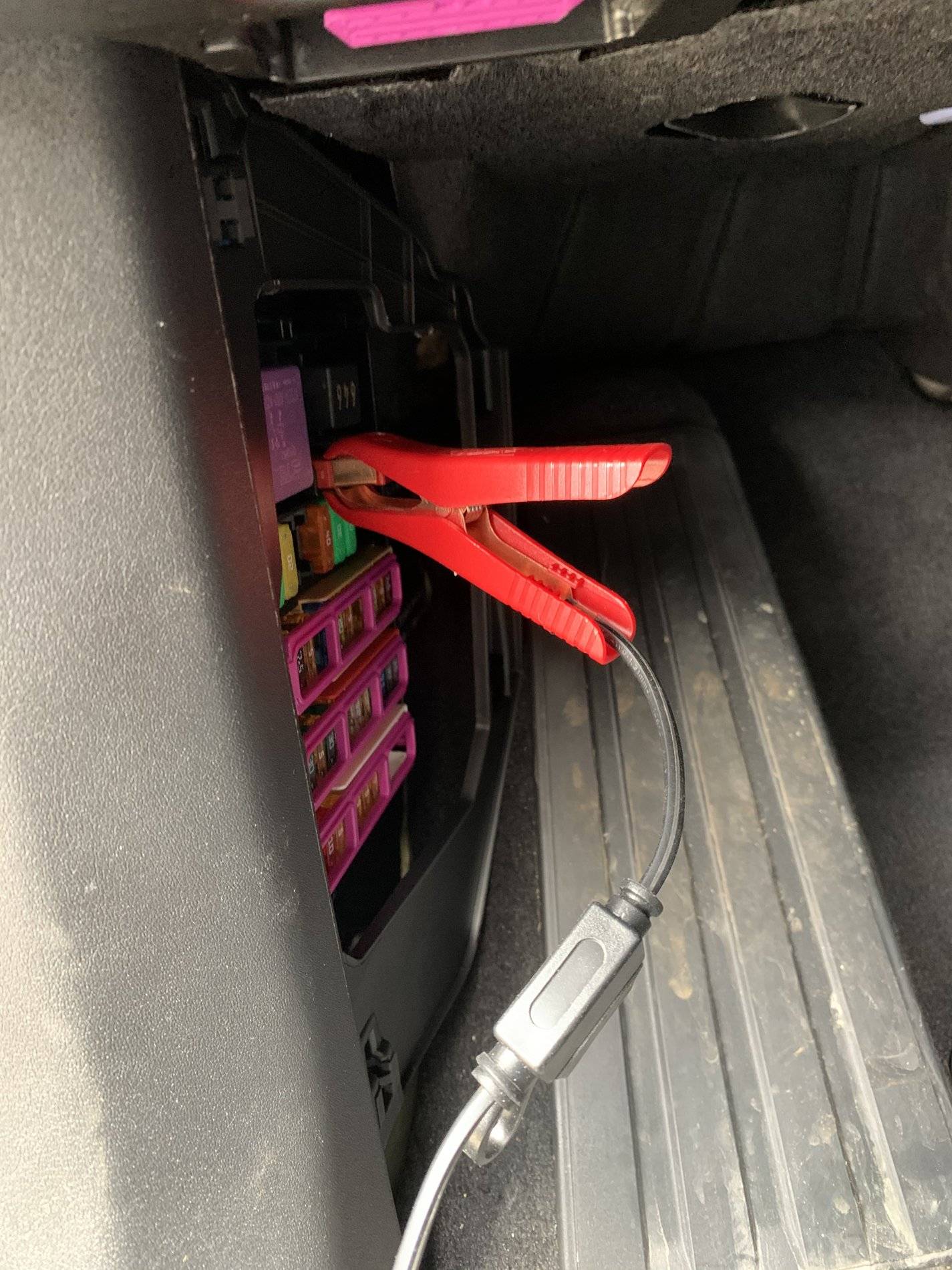

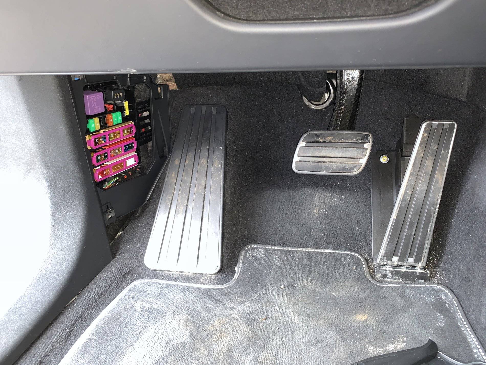

I discover instructions for applying power to the 12v system, so that the Frunk can be opened (and then the 12v Battery can be accessed directly). I go in the house, grab a spare 12v battery, and some charger clips and go back outside.
To Apply 12v Power to the car, when the car's 12v Battery is dead:
1) Open the fuse panel (to the left of the driver's side footwell)
2) Find the Red 12v Positive Terminal, and pull it out about 1/2 inch.
3) From your spare 12v Battery, Attach 12v Positive to that terminal.
4) From your spare 12v battery, attach negative to the hinge of the car. (bare metal)
At this point, I hear relays switching on and off... kinda like it was trying to connect, something was failing, and then it would try again. After 10 seconds of that, I disconnected. Never mind. I don't know what's really wrong, so I'm just going to stop.
Soon after, the technician arrives.

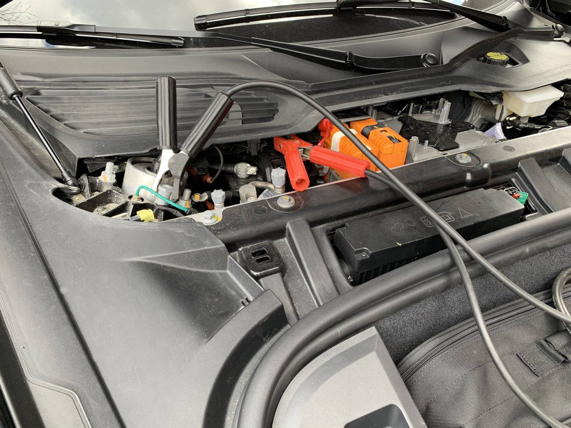

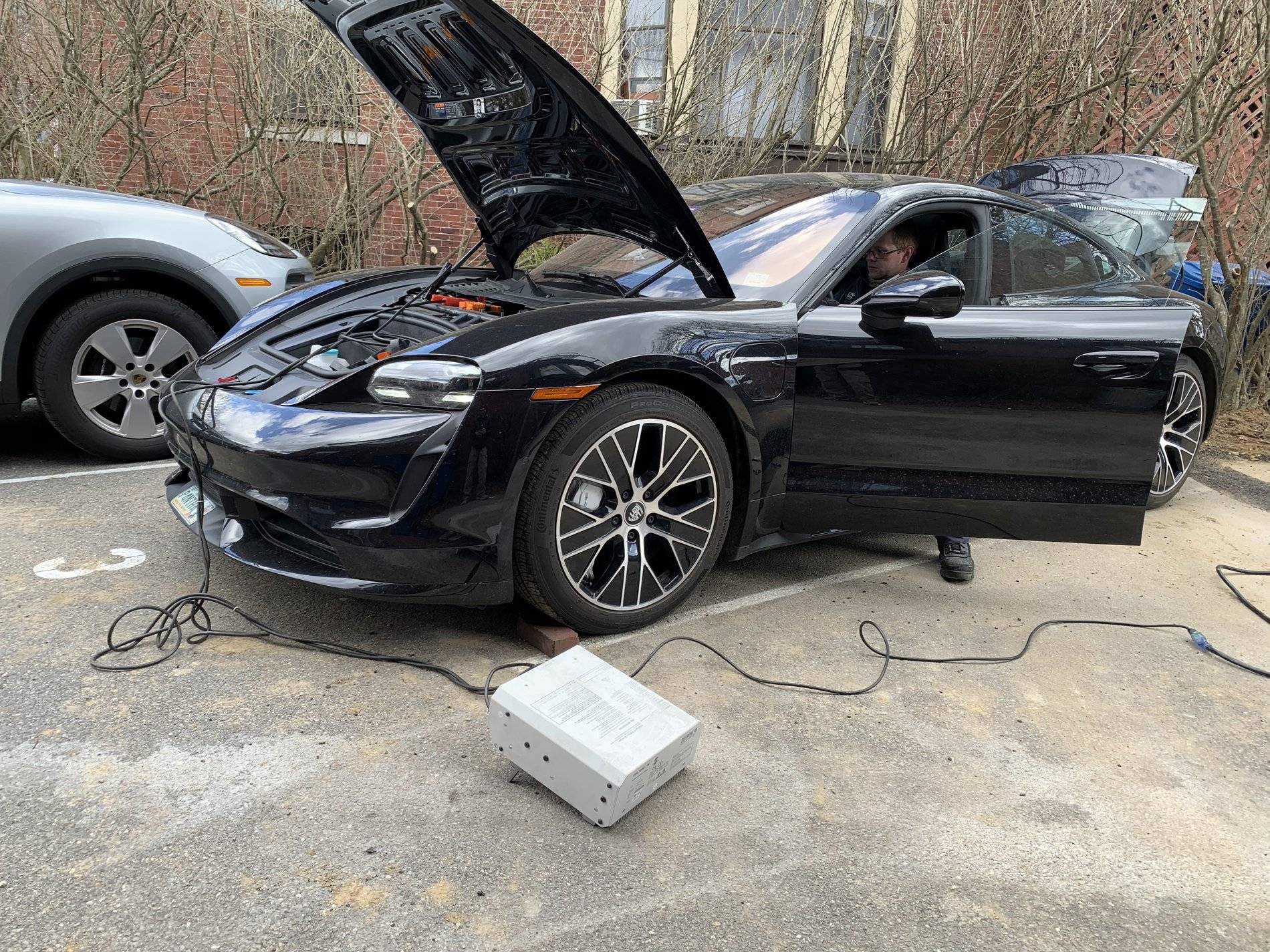

He connects a bigger batter to the same places. And tries to turn on the car. No joy. We wait a few minutes. Still nothing.

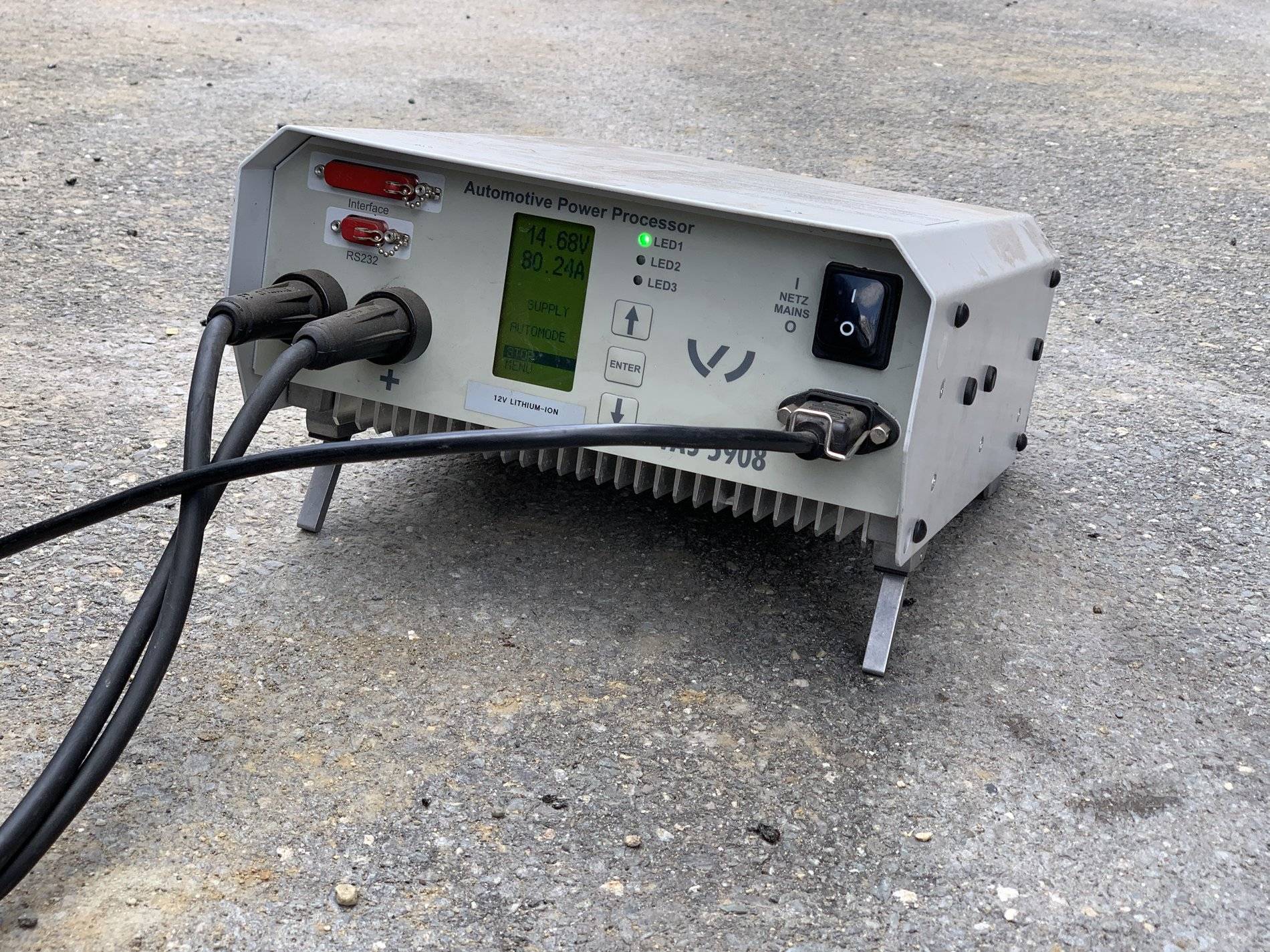

Then he says he needs their Lithium Ion Battery Charger. So a quick, 10 minute run back to the shop, he grabs the big charger. Meanwhile, I run a 100 foot extension cord so he can plug in the charger.
When he returns, and attaches the big charger, the car wakes up enough that we can pop the hood. Now we have access to the actual 12v Lithium battery, so the charger can do a better (read: faster) jobber-charging the 12v Battery.
After charging for about 5 minutes, the valiant Technician attached their diagnostic computer to the ODB-II connector, and collects some diagnostic data from the car.
We let it charge, and download data for another 10 minutes or so, and now everything seems fine.
