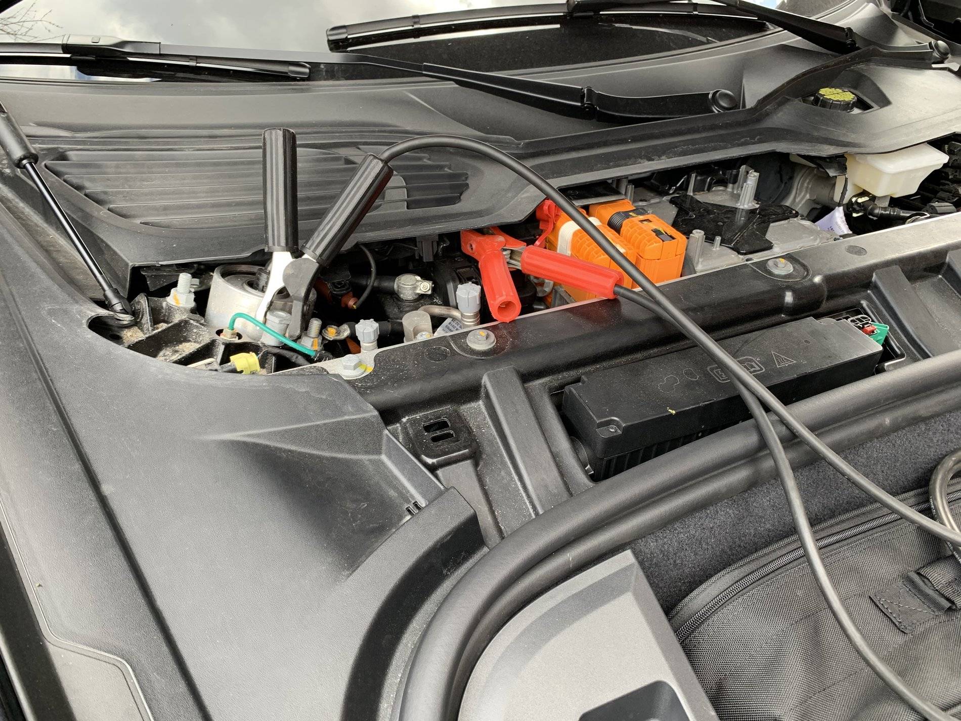

Is the battery accessible at all? The plugin cars that I have had gave me posts that were connected to the battery somewhere, but the battery itself was only accessible by lifting the car.
louv
louv
Don
Sep 6, 2019
1,154
3,728
Maine
The 12v battery is under a panel above and behind the Frunk. Passenger side (US car).
Here are the jumper cables connected to the (+) on the battery, and a (-) post on the body of the car.
Photo taken from in front of the car. The Frunk is lower right. Panel is removed.
