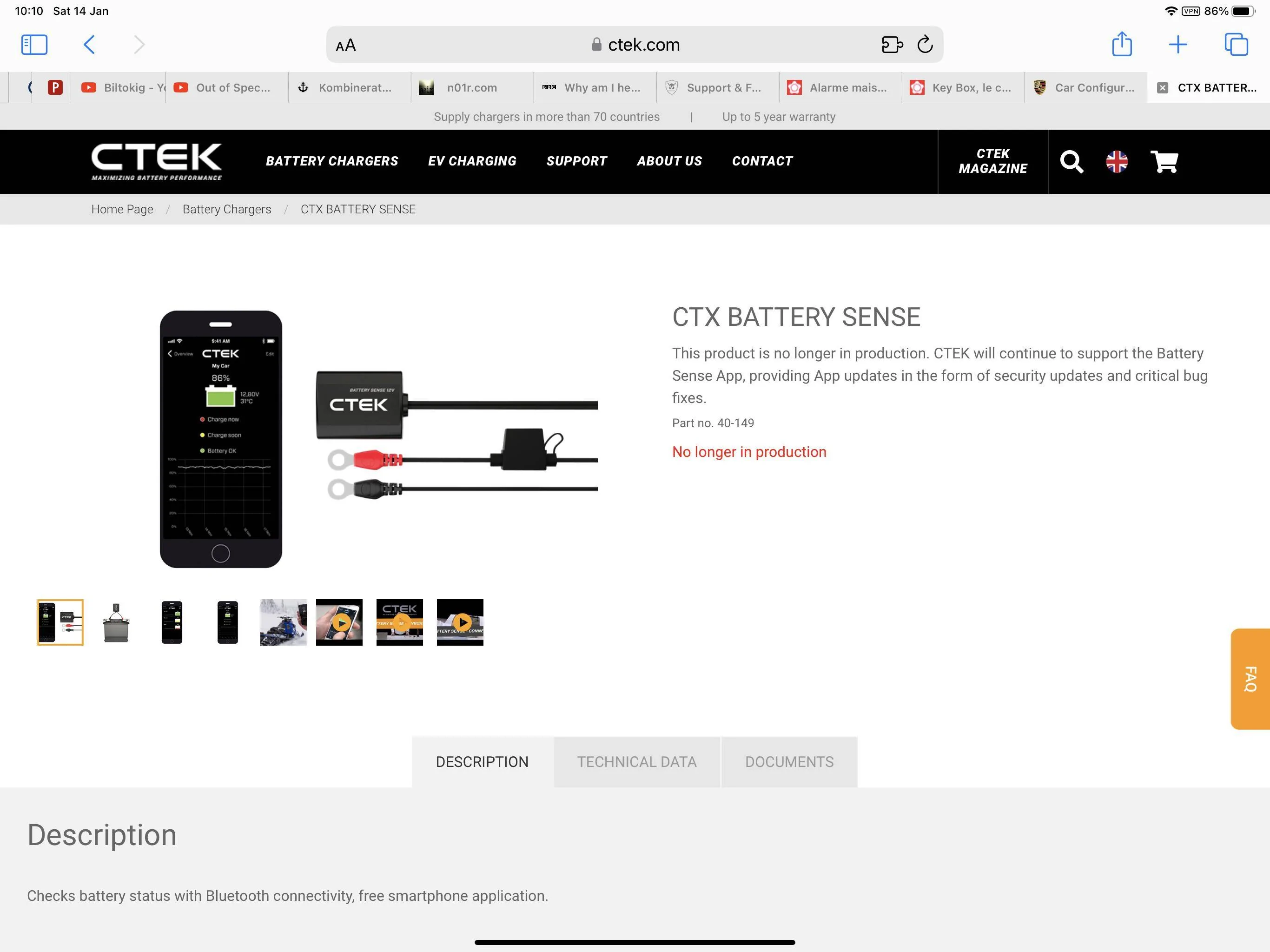

How hard is to meter the 12V battery with the app? Or the car itself send a warning message. I don’t this is hard in today’s cars to keep updating the 12V battery health.

I bought it localy. But the link to the device in my previos post still works.
Neat piece of kit - thanks for posting - just ordered so apparently is still available (at least in US).
