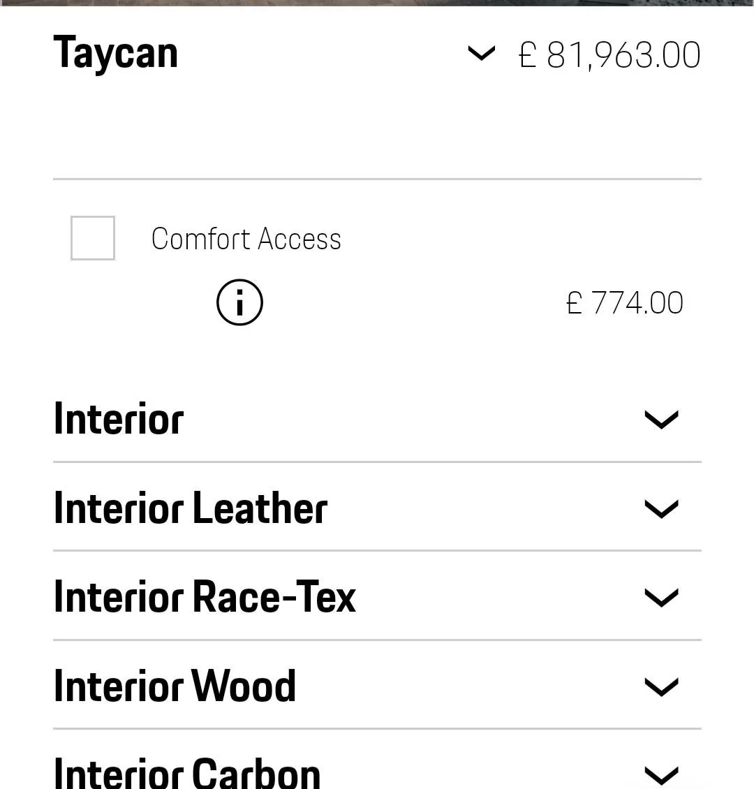

Comfort access is standard on all models.

Not in the UK.
A lot of people don't want it because of relay thefts.
Too right!
Each to their own, but I’ll never deliberately spec it. The one time I forget to put my key in the pouch / tin etc
