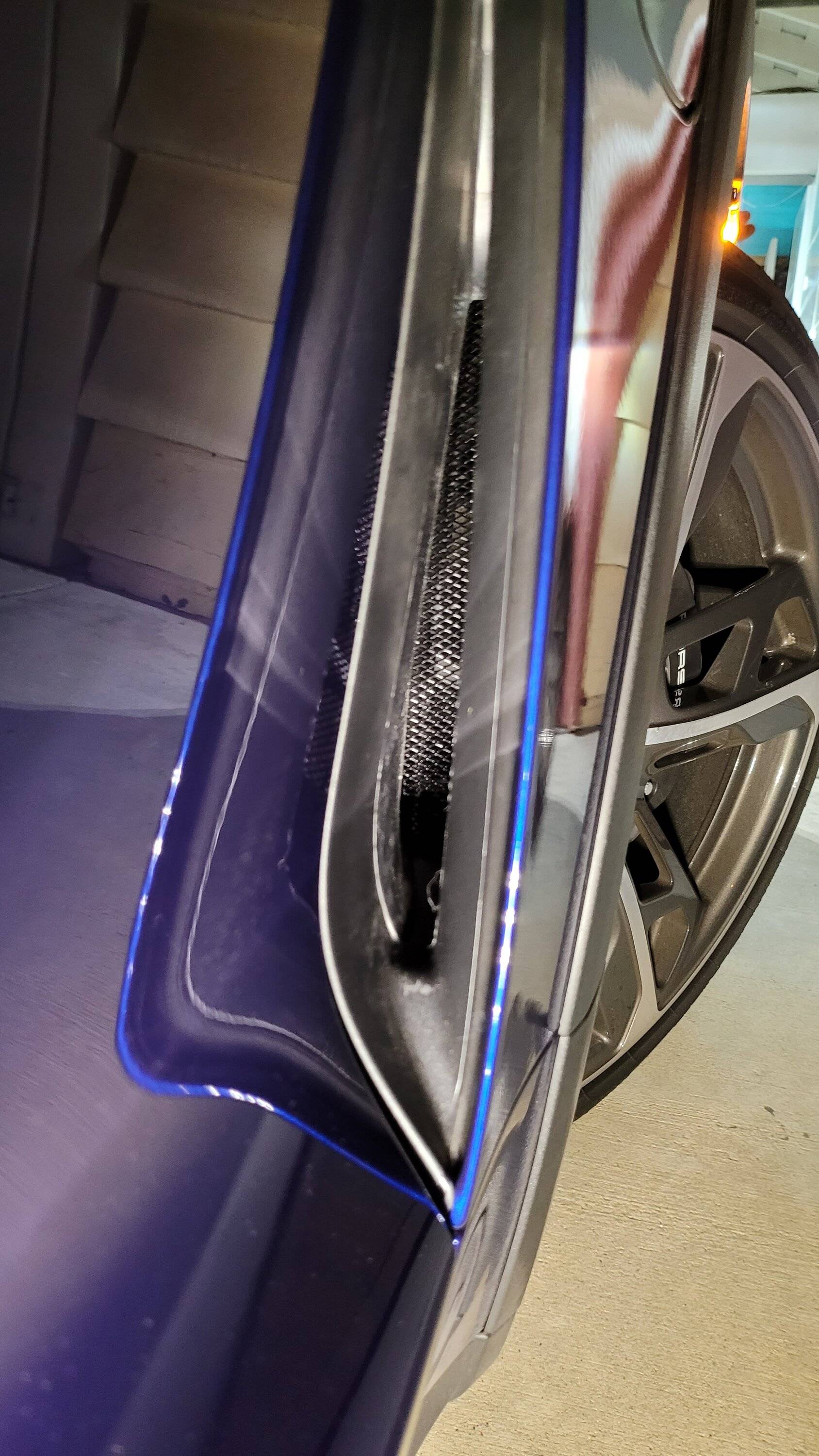

Here's from the door side.
Porsche Taycan Dreaded stone chip scratch through the front wheel vent 20230217_195501
There's a small gap between the door side and the wheel side. The mesh is sitting in that space wedge between the two sides. It's not going to come off without a lot of force.

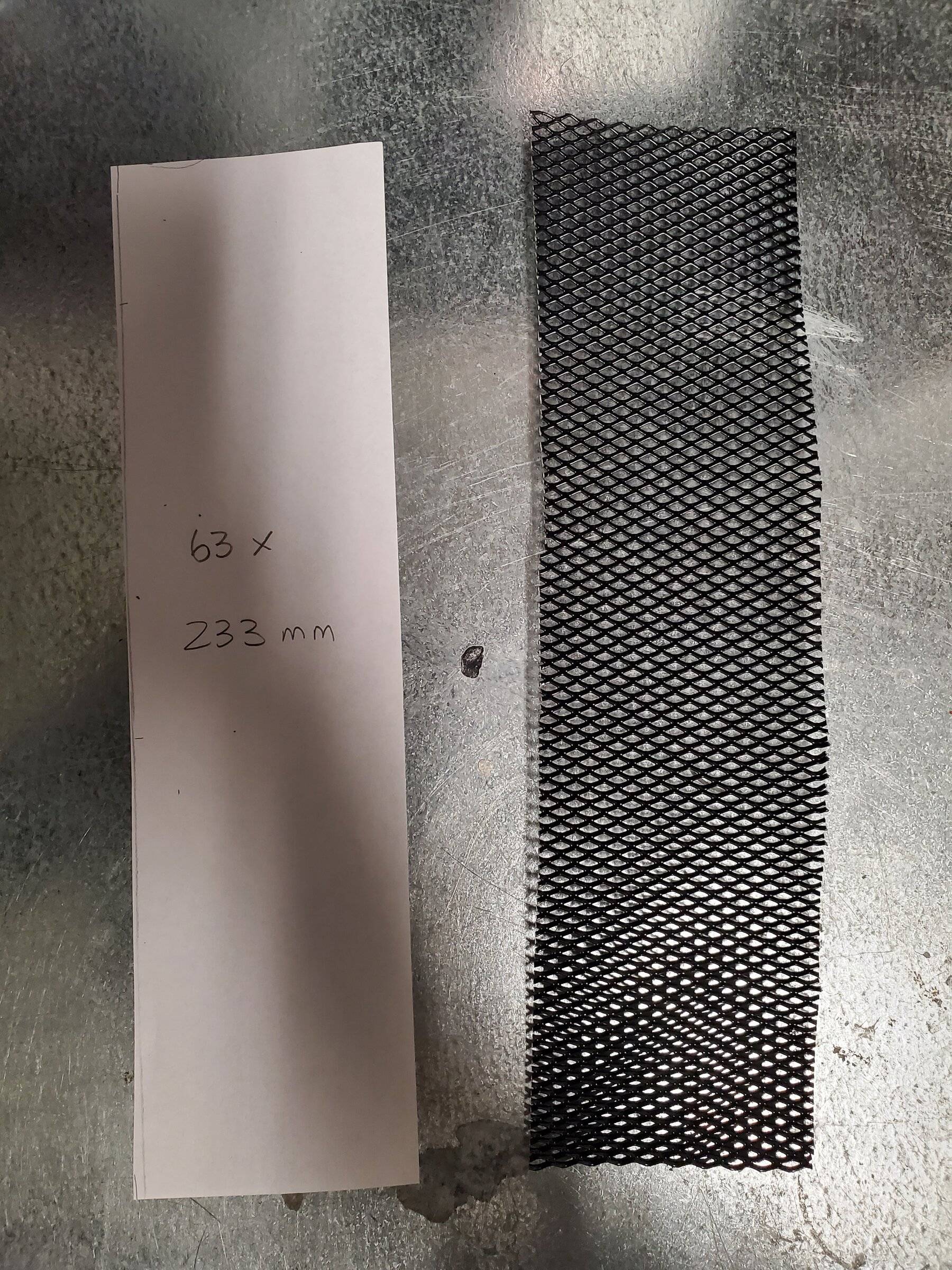

I think I have that kind of mesh locally. Not sure if black or silver but inside the vent probably doesn’t matter.
Thx for the measurements
