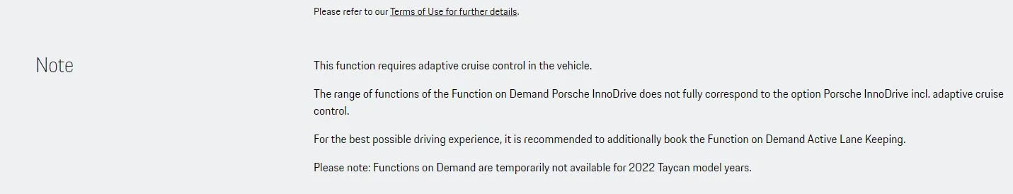

The FOD version of Innodrive is not identical to the optioned version.
Unlike TESLA, Porsche builds the car to exact spec's, even the wiring harasses will be unique based on options. TESLA installs all the hardware options and charges you to "unlock", enable.
The optioned version is both ALK and InnoDrive. But with FoD you can get them independently. If there is another difference, I would like to know what it is.

I have ordered ACC and I was going to get ALK as FOD. However, apparently for now FOD is not available for model 2022. Will hopefully be solved.
My dealer advised against Innodrive in Belgium because of fantom braking.
I will give it a try when FOD for model 2022 is available
