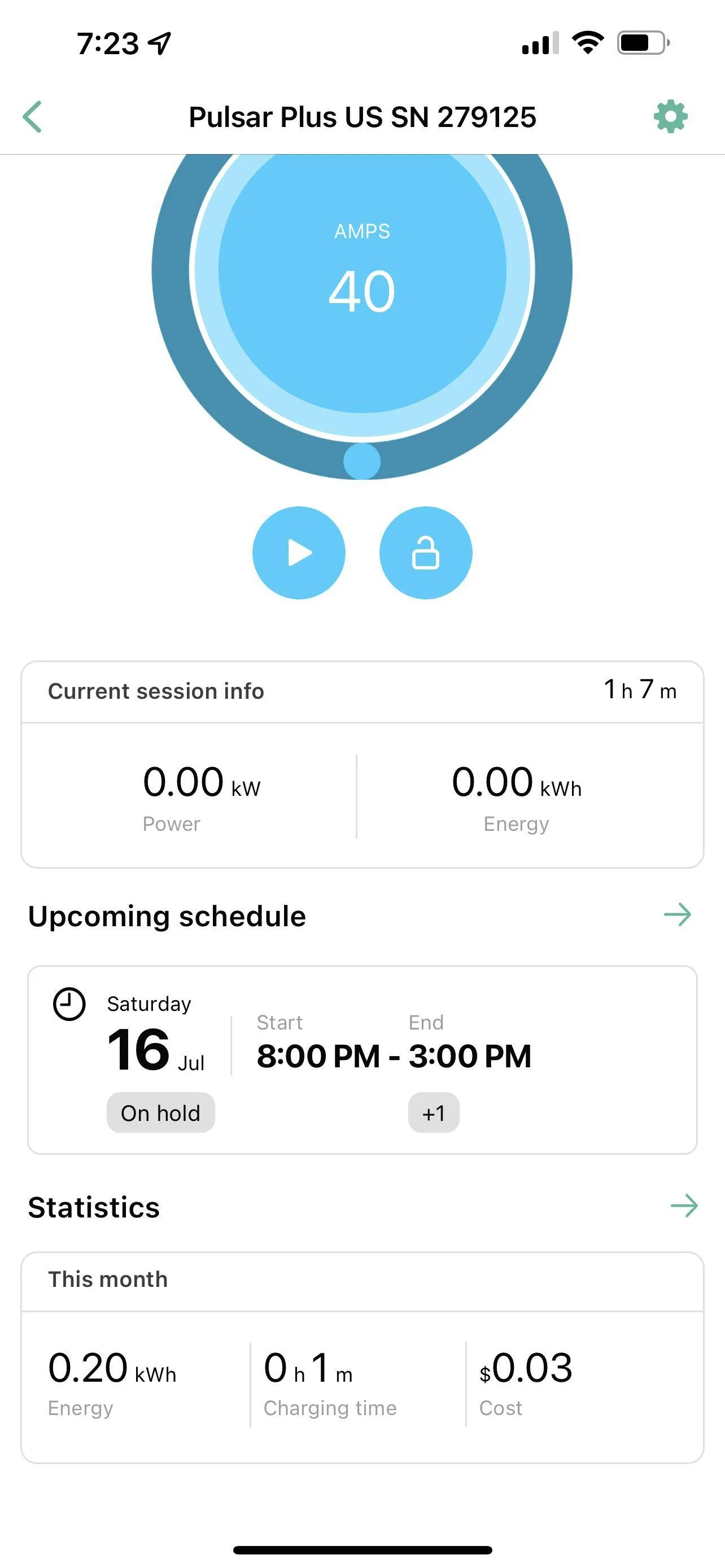

Enter the Wallbox, which has its own time-of-use scheduling feature at the charger level.
I can just delete all timers and profiles and let the charger run everything, right?
Well...not so much. The Wallbox can control charging time windows, but it has no awareness of the car's State of Charge. It would just blow straight through to 100% if I did this.

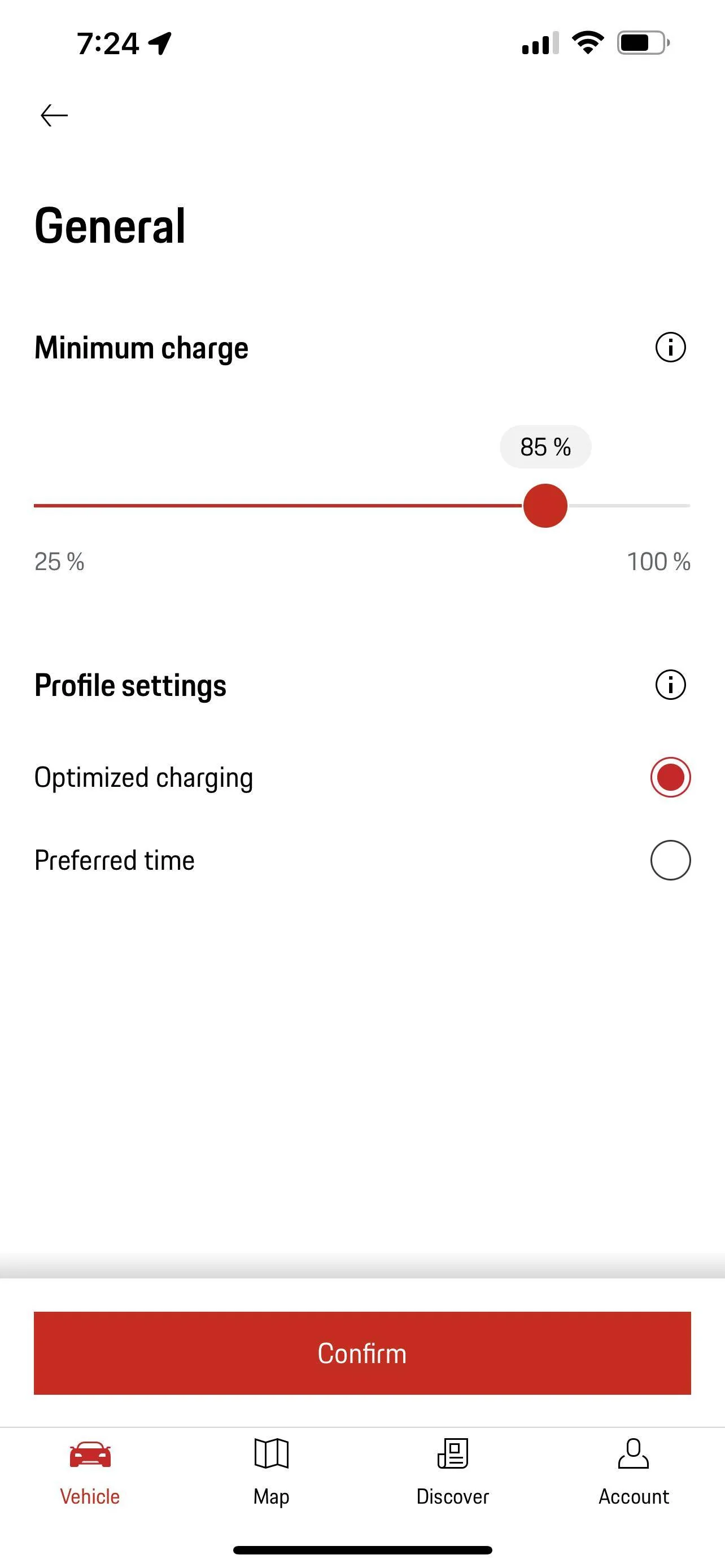

So my current plan of attack is:
  • Wallbox set to charge 8PM->3PM
  • Porsche profile set to 85% minimum charge (no time window)
  • No timers
It remains to be seen if the car will stop at 85% given this configuration. I expect it probably will.
However there is already a minor problem with this approach; when the Wallbox is waiting for it's scheduled time, the Porsche treats this as a charging error. It goes red, sends an error push notification to the app, etc. Not ideal.

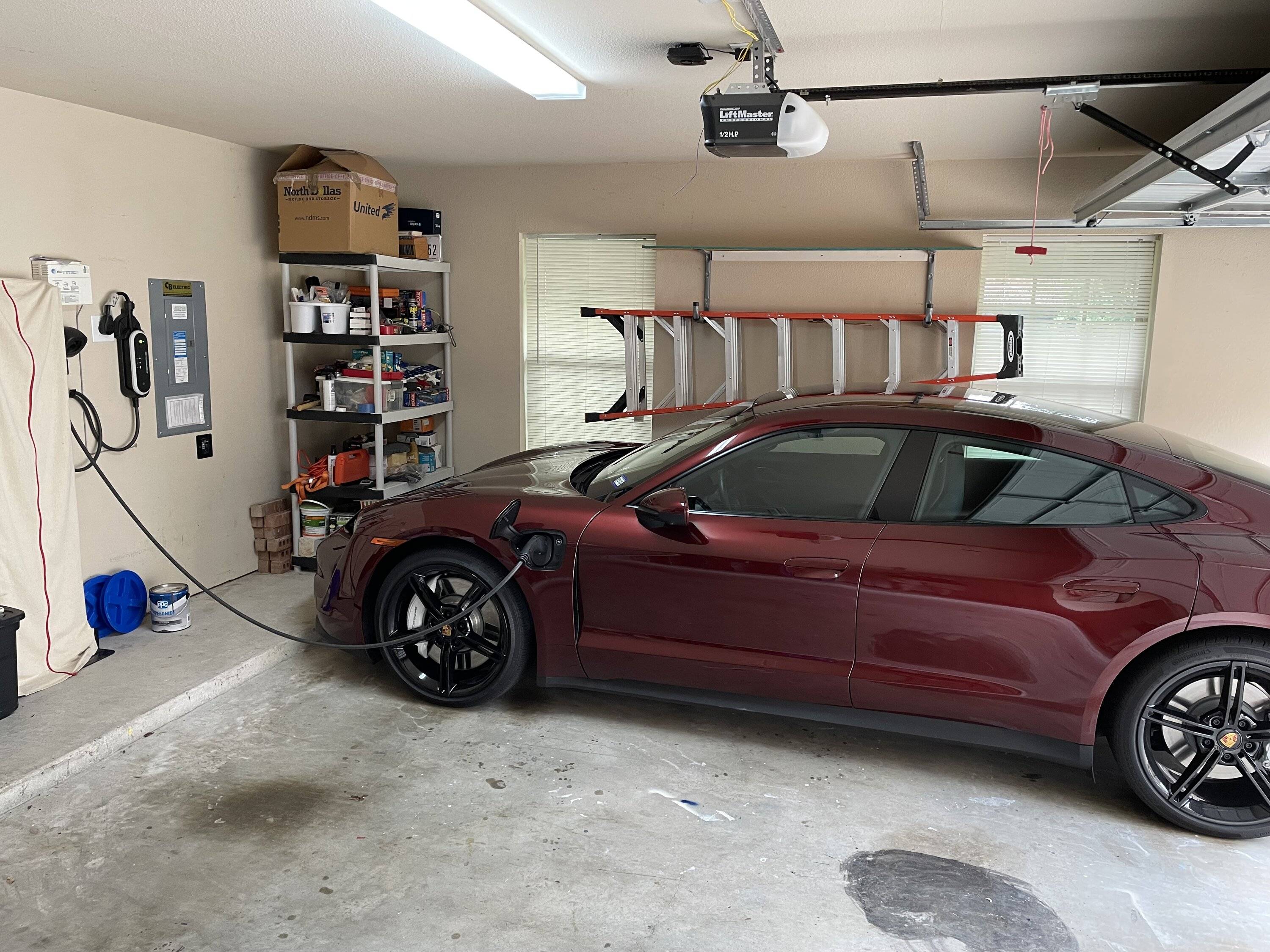

Anyway we'll see how it goes. Pics of before/after. Please don't mock my garage floor, I know I need to get it epoxied. :)

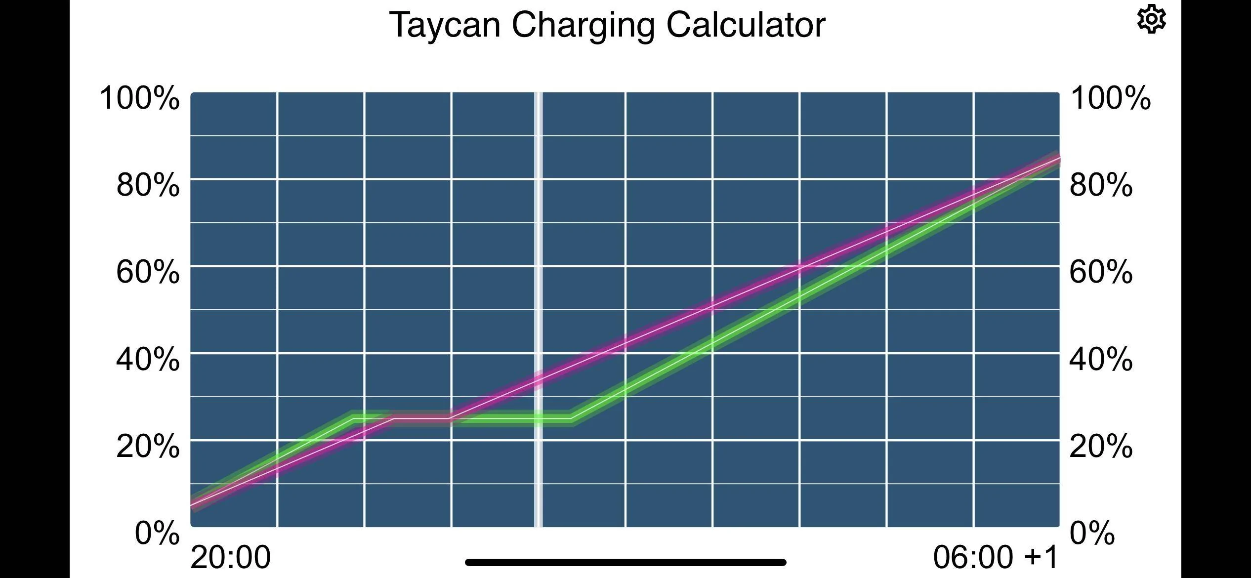

I guess I kind of understand the frustration with the timer making it charge as late as possible, but I still think it would work fine if you just set a timer for 6am@85% and nothing else, as long as you don’t typically need to recharge in the middle of the day.
If you charge at 9.6kW, it wouldn’t start until after midnight.
Even if you turn it down to 32 amps, it starts near 11. You have to start getting below 5kW to make it start charging before 8pm.
Green line is 9.6kw.
Purple is 7.7kW.
So, I’m still not convinced a profile was ever needed for your use case.
Purple is 7.7kW.
I do agree with you - I guess the control freak in me didn't like "trusting it?"

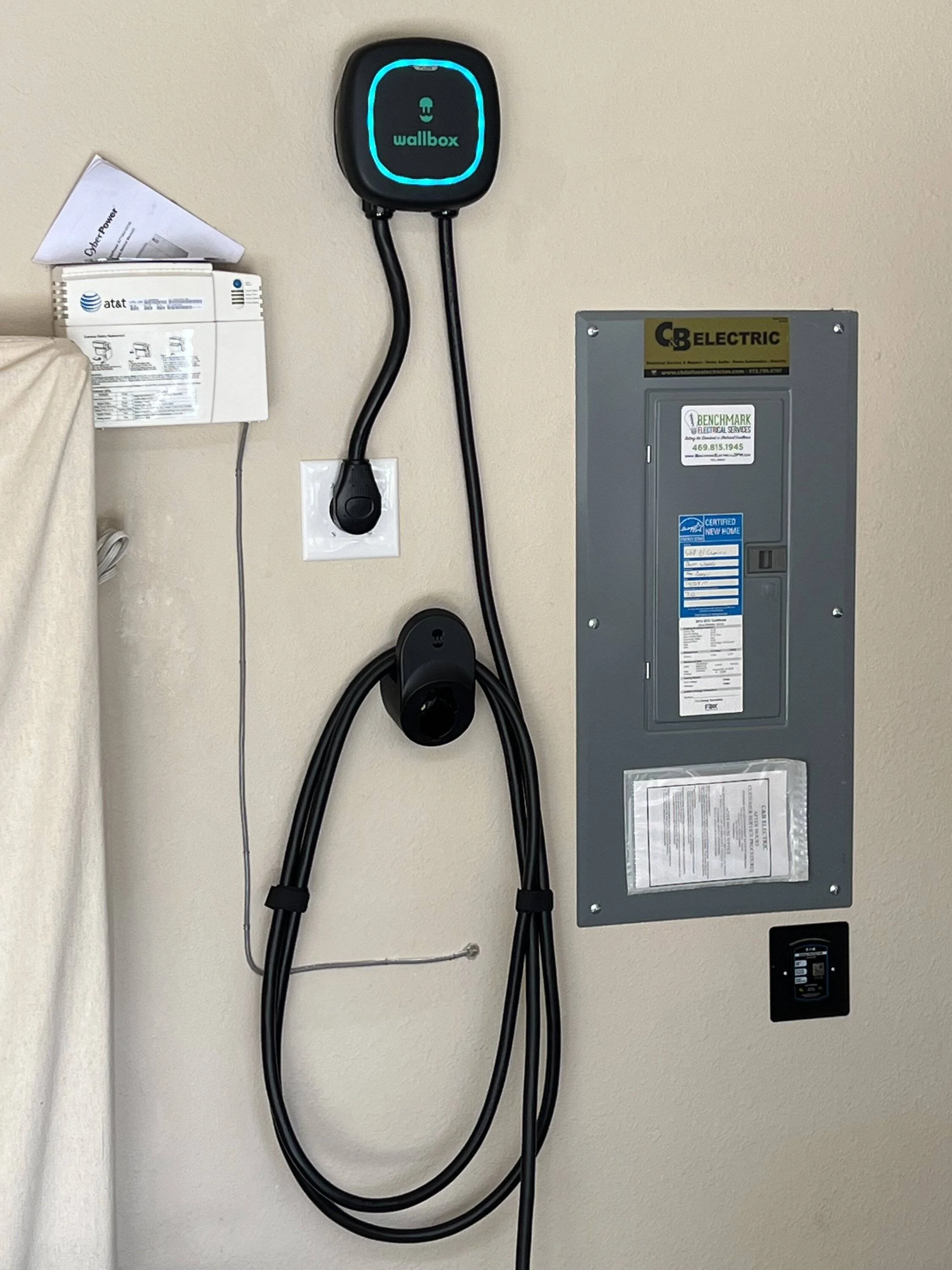

So far I am gruntled. It works just fine and has a lot more stats available than the PMC+. You can view them with an app or my.wallbox.com website.
Install was easy, 2 screws into a stud, done.
I do wish the NEMA cable was a bit shorter; I really had to mount the box high to accommodate it. The manual suggests 8 inches from the top of the NEMA plug outlet cover to the bottom of the Wallbox, but I had to go a little higher. It was giving the plug too much curve and actually pulling it out of the socket.
Not a big deal.
