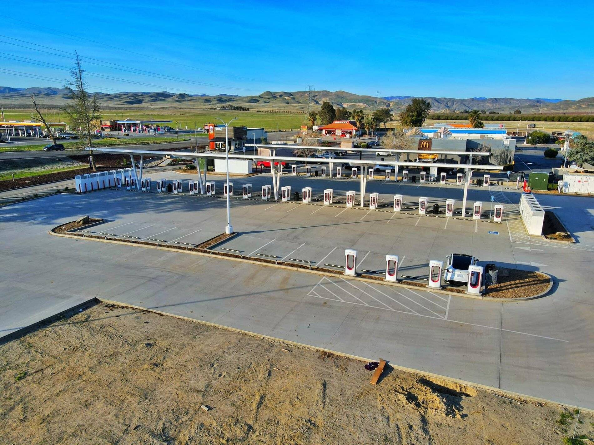

This has been my experience as well. Countless road trips (probably 30,000 miles over 7 years) and I’ve only had to wait in line twice. Both times were in California. The SpC network is so broad and reliable that I do very little if any planning anymore.
Porsche Taycan EA charging FAIL FAIL FAIL 18ABDB39-EB41-4A92-9C5D-0E47B81A5A97
