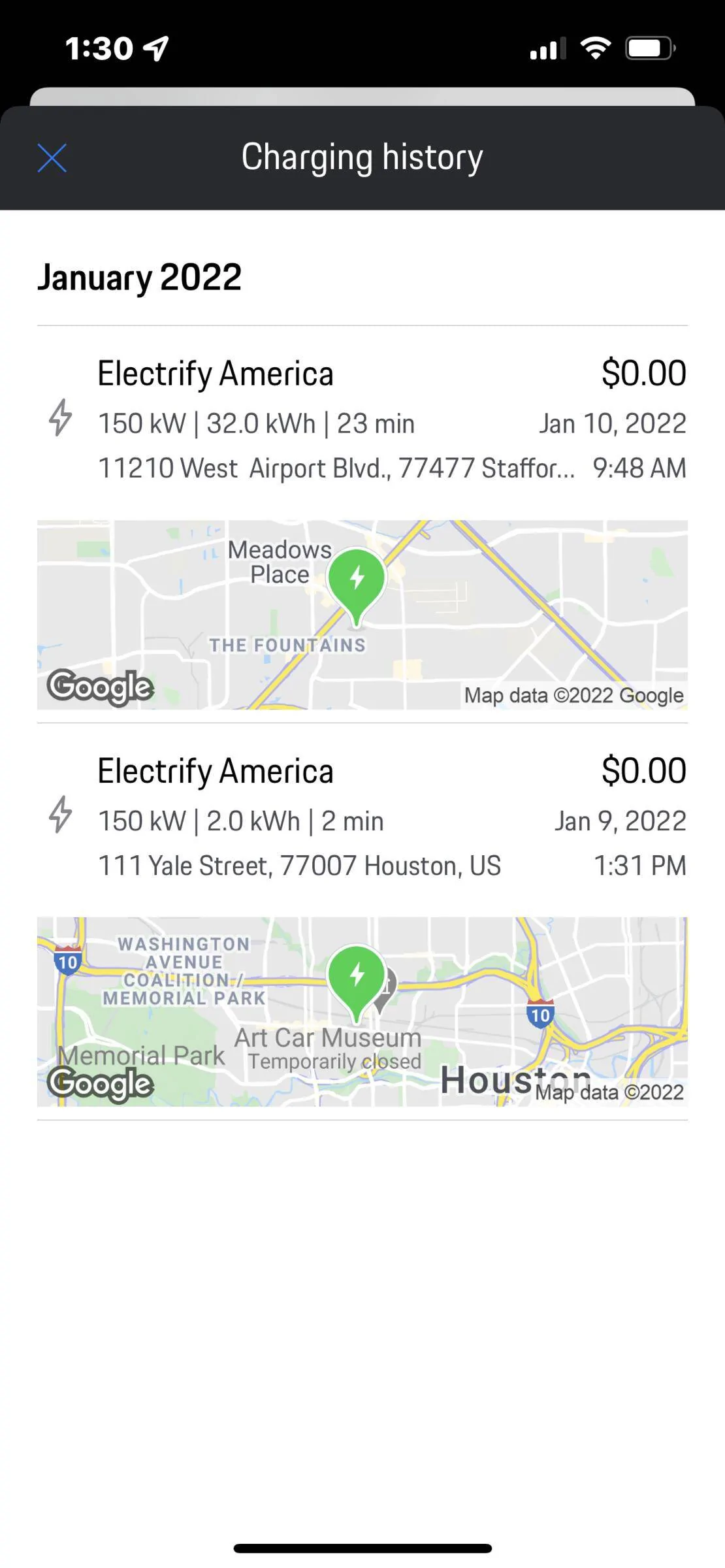

Odd indeed - here is what mine shows (ignore the first test - was literally a rapid plug and go just to see if P&C actually worked and it did). The second charge is the one this AM:
One thing I need to check more carefully on my next charge is the time charging as I am near 100% certain I did max ca. 18 mins poss. only 15, yet it reported 23 mins - odd.

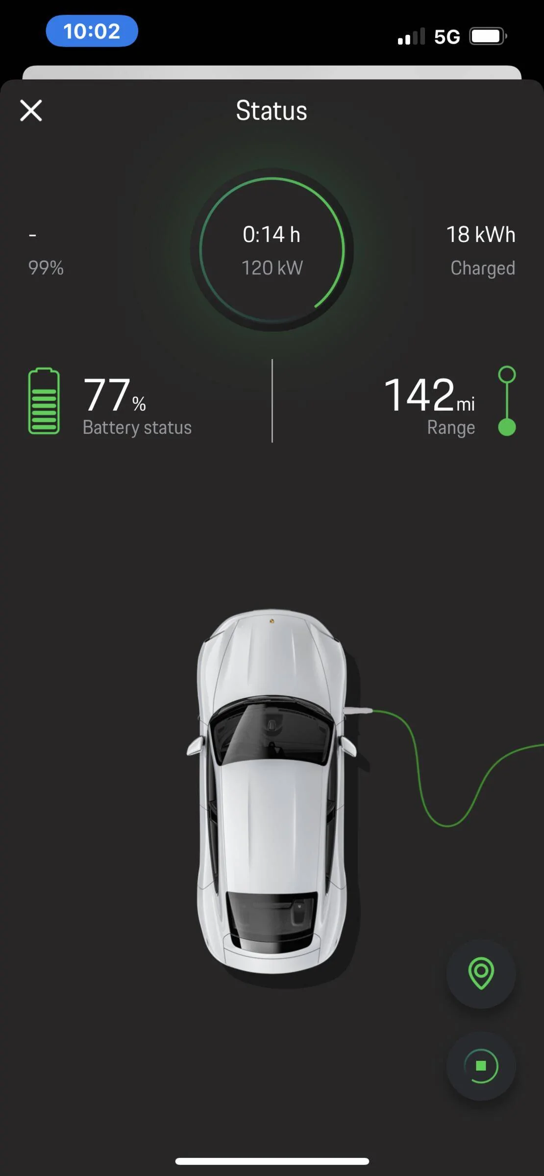

BTW - here is a pic of the charging status panel accessed from the active charging icon on the home page of the NA Charging app for ref in case you have not seen it as yet:

yman182
Sep 7, 2021
194
I am going to have to try it again. I didn't get either of those.

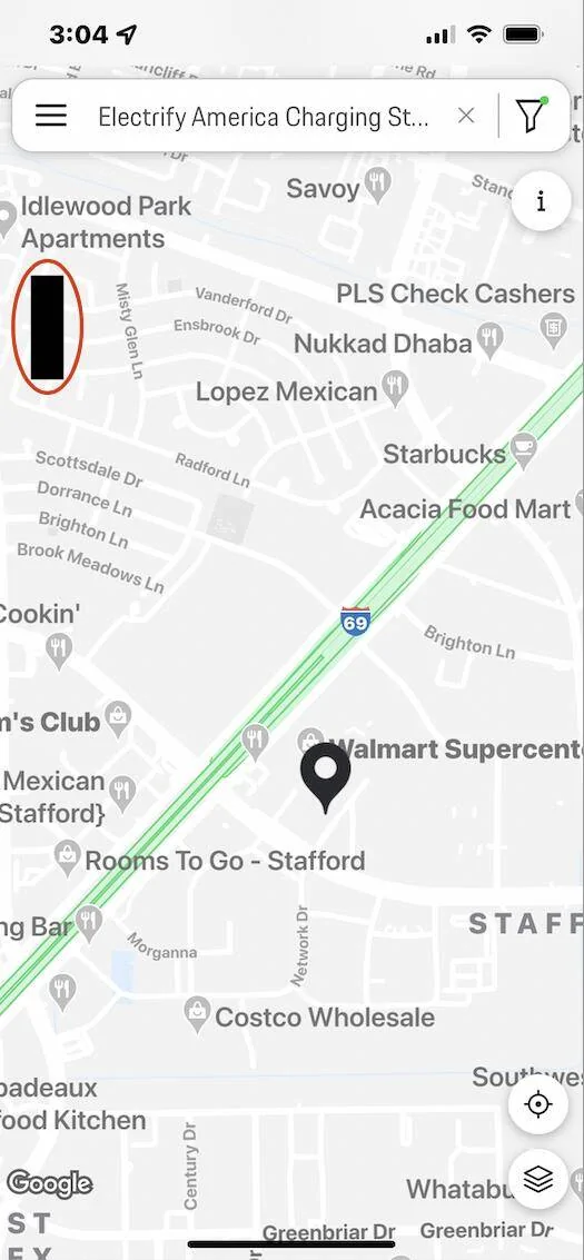

One more - possibly a bit redundant :), but I did not take a pic at the time of the icon I was referencing that appears here on the main display of the NA Charging app - clicking this brings you to that charging status page (assuming you are in a P&C session of course).
