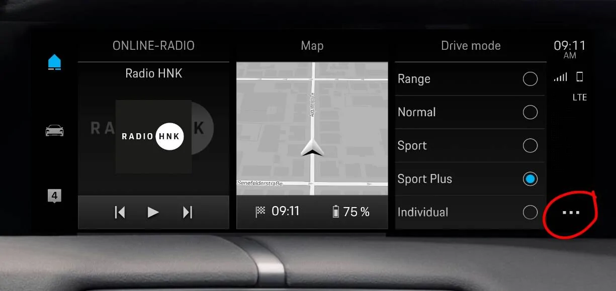

Porsche Taycan Easy way to reach Range Mode without Sports Chrono package 2021-10-27_11.25.09
Goto home (top left) and press it, you'll get to the second customizable screen.
Then press the "three dots menu".

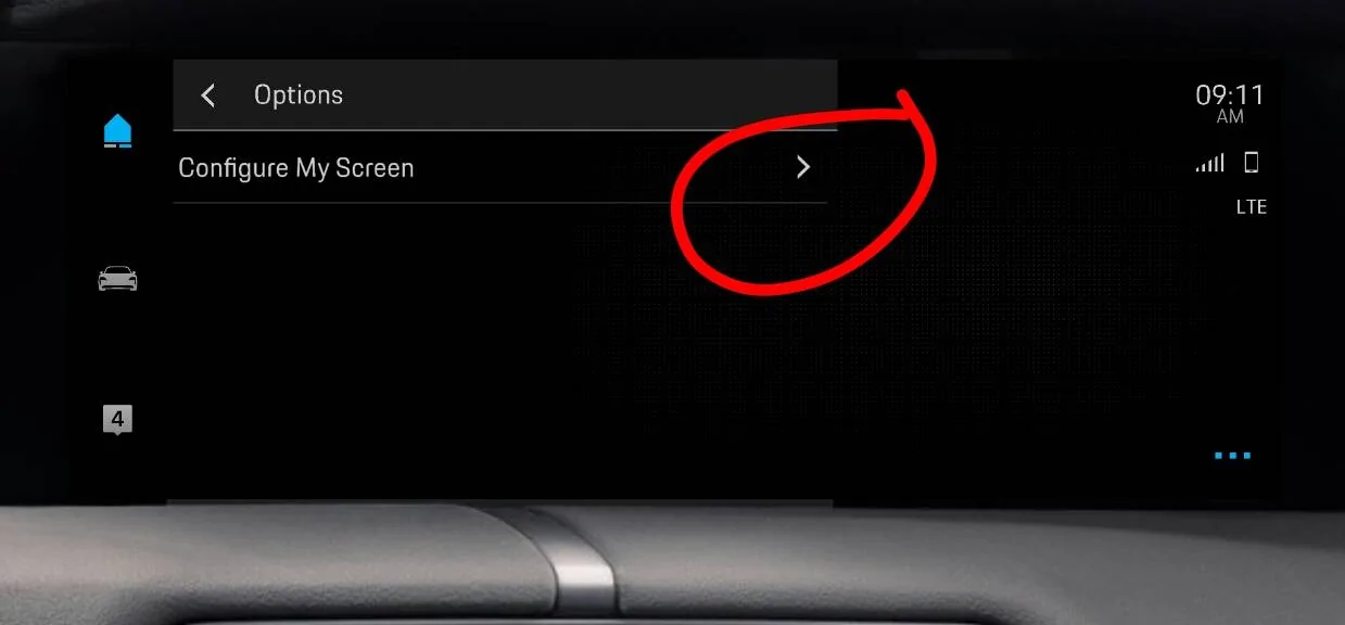

Porsche Taycan Easy way to reach Range Mode without Sports Chrono package 2021-10-27_11.25.36
Goto Configure my screen.

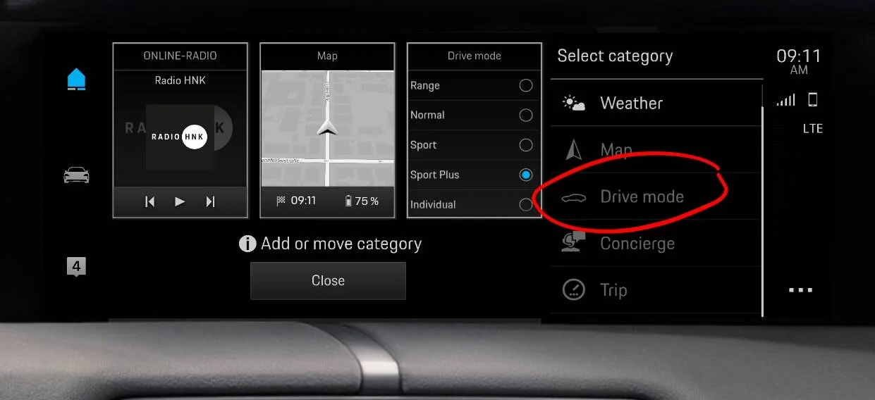

Porsche Taycan Easy way to reach Range Mode without Sports Chrono package 2021-10-27_11.26.08
Select Drive mode.
You can even customize more out of the drive mode menu as there are two options in the slider (ride height and suspension).
Annoyingly, it'll start in the standard home menu so you'll have to press the second screen every time you get into the car.
Anyway, you'll get used to it, like many other things not being stored the way you left them...
