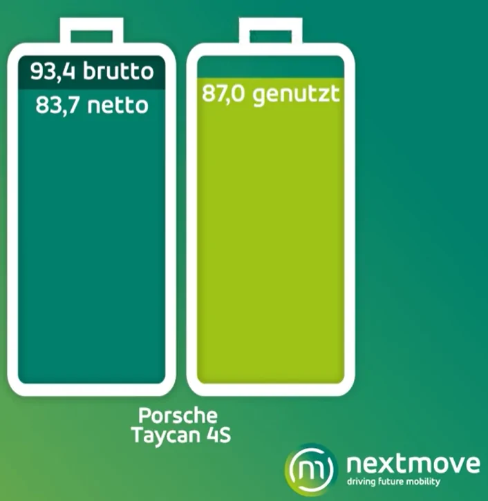

As I remember, nextmove also reported on this that either the consumption calculation in the car is not quite right or the battery net capacity is around 4 kWh larger than on paper.
Porsche Taycan Efficiency testing the Taycan 4S at 62, 81, and 99mph - The Autobahn Specialist snip_20200412203622
I don't think Prosche changed the reserve of the battery, I think they are simply slightly larger than what is written on paper. This would fit to the strategy of "under reporting" but "over delivering".
