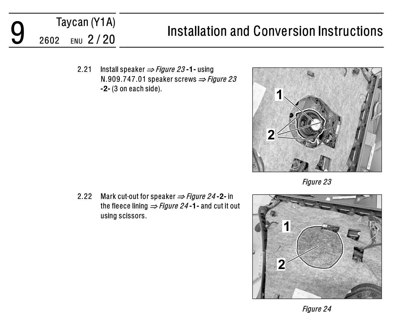

Does anyone know if the Sport Sound is played through car’s standard speakers or does it have its own dedicated speaker/s inside the cabin - i know there is a speaker mounted under the boot floor on the outside, but presumably that’s for external sound only?

One external speaker upfront...and one external speaker in the rear. Inside the car, i suppose it is piped through the normal speakers? But this part no doubt be answered by someone who HAS taken delivery of their Taycan, and can confirm :)
EDIT: I found there are actually dedicated interior speakers for this purpose as well! In the rear doors.

Cars without the optional E-sound, it's a black box in the front of the car... it's for pedestrian warning...
With the optional E-sound, its an additional black box in the rear and two additional speakers in the rear doors...
I looked at adding it, but the AD wanted 11 hours plus $1,000 in parts (in Canada)... not worth it...

Do you know where in the rear doors the speaker is located? I have it, and just discovered there is a weird buzzing sound that gets louder in tandem with the sports sound.

As mentioned, I have it but it's making a buzzing sound in tandem with the volume of the sport sound. Annoying to say the least.
