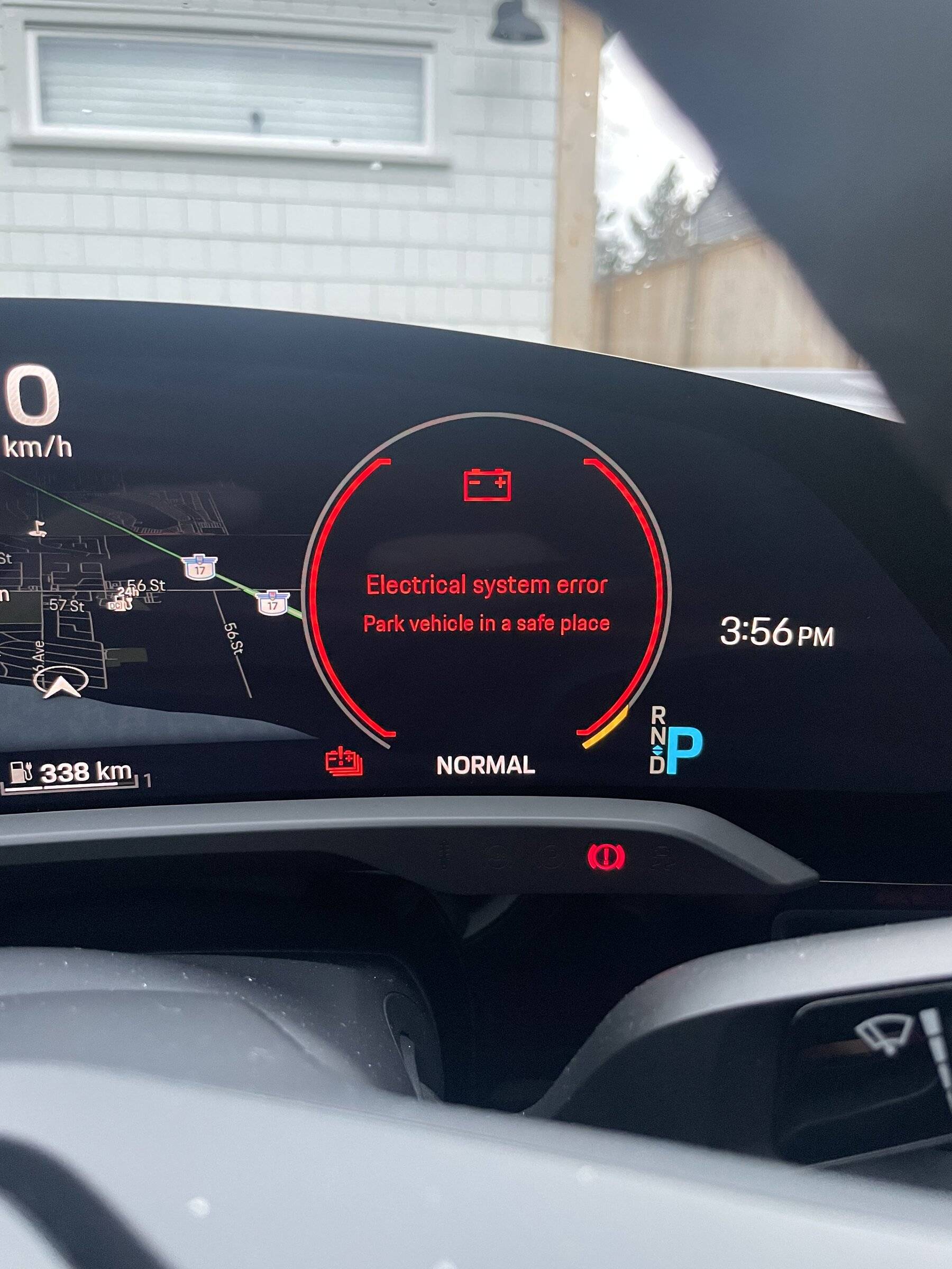

Terra
Jul 20, 2020
54
Vancouver
Many
well… after 16,000km got in to go and this popped up.. turned off and plugged in and “charging not possible” after a while error went away and all good.. happened again the next morning and same thing.. left it and went away.. next day again and when it got going drove it straight to the dealership.. it’s now been sitting there for 9 days.. and they are so backlogged it has not even been diagnosed yet.. ??‍♂.. hopefully get in next week But there was mention of replacing the main (big) battery.. other than this.. no prior issues other than the odd PCM glitch..
