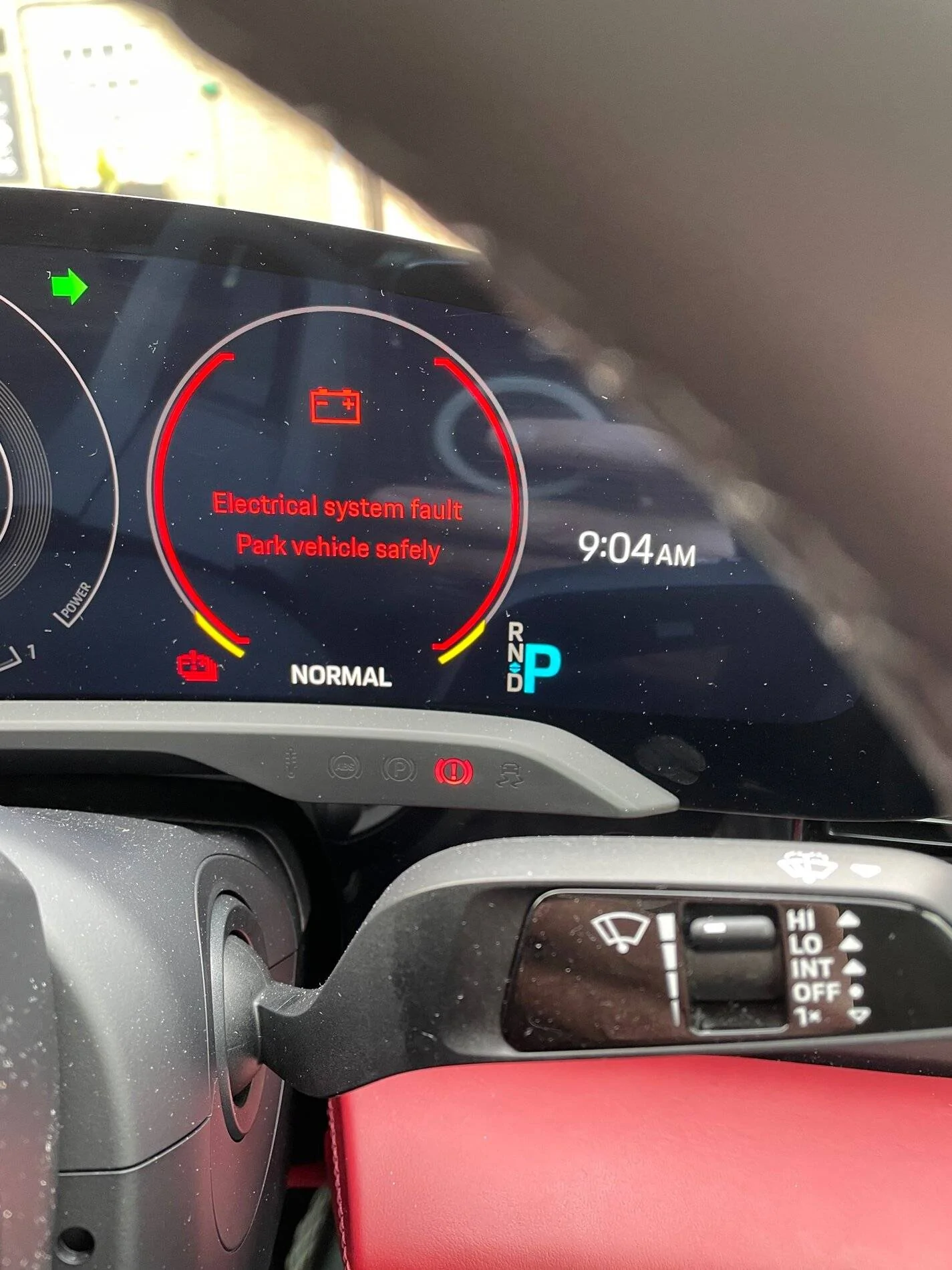

Dear all,
Firstly I’ve had my Taycan 4S for 6 months and love it but encountered a scary electrical fault whilst driving a few days ago. I’d just left home early in the morning and when pressing the brakes to slow for a junction the car lost power and began shaking as if the ABS brakes had locked up but in fact the vehicle struggled to slow and stop!
It was extremely alarming not being able to stop as normal but very lucky I wasn’t driving above 30 miles an hour and their was no other traffic around at the time.
Has anyone else lost braking power and seen the electrical fault warning on the dashboard?

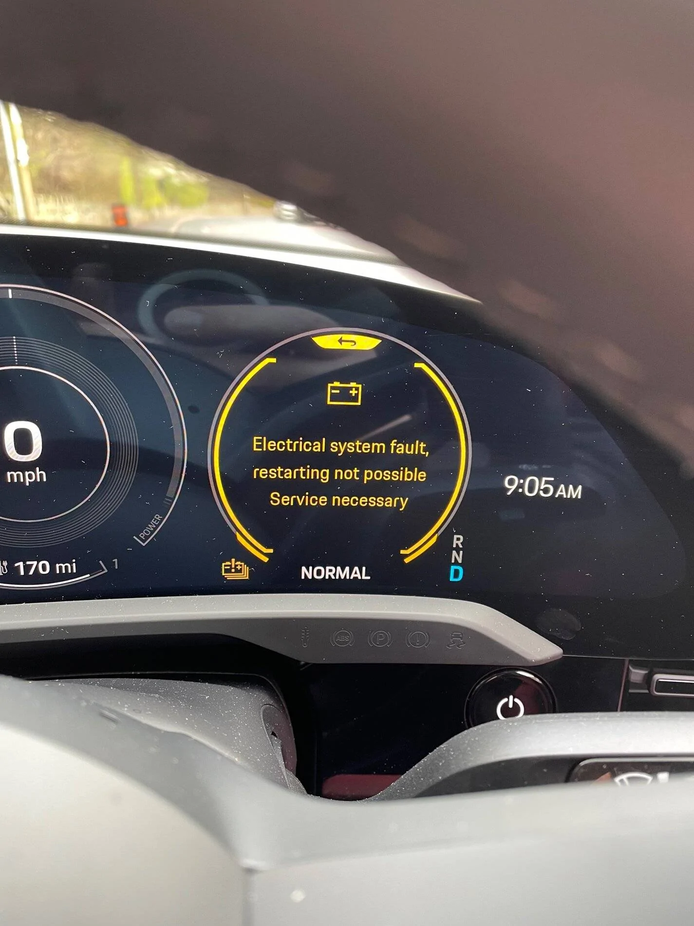

Sorry to hear you also had a similar fault. The first time it happened I had it towed to the local dealership were they found no faults and made me feel like it hadn't happened. I took the car back and it happened a couple of more times, always after it had been on a long charge at home. The last time I had it towed back to the dealership again and they found numerous errors, but to be honest they couldn't dispute it as I took pictures of the warning messages on the car dash at the time of the event.
They said the car was over charging and passing current to places that it shouldn't. I wasn't prepared to drive the car again and after speaking the the dealership I purchased the car from they agreed to buy back the car with some financial assistance from Porsche UK.
