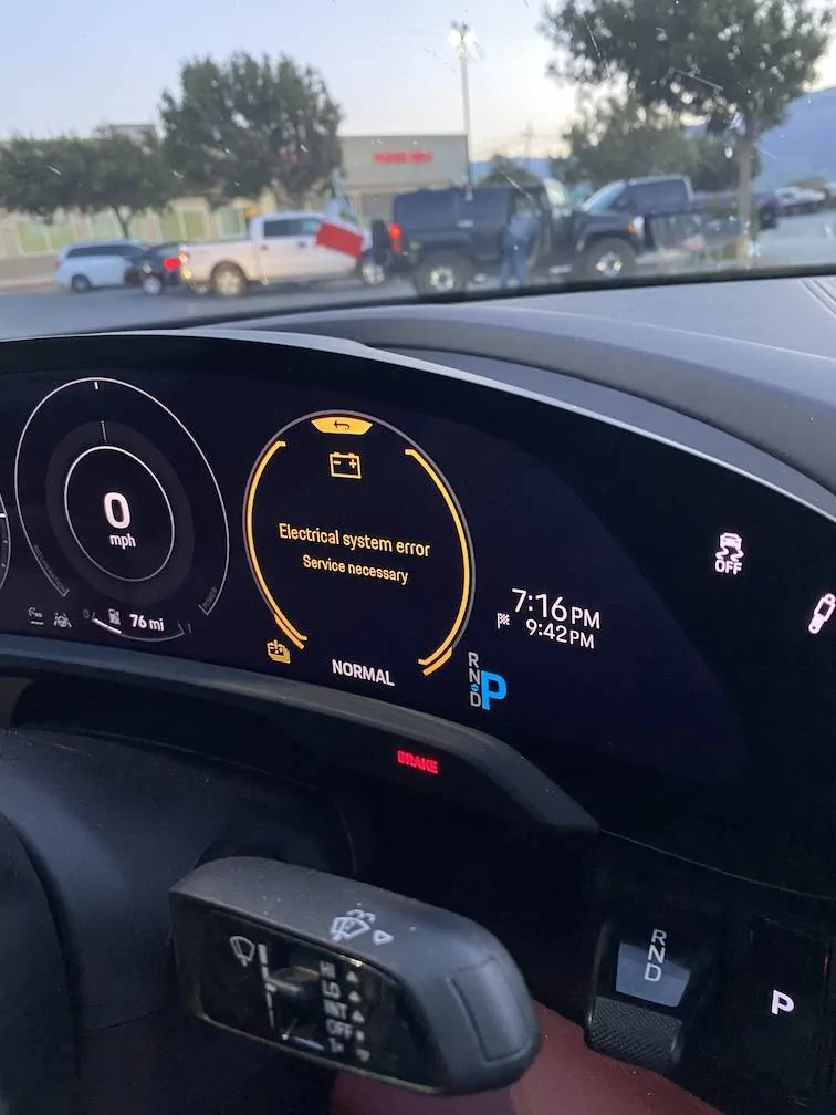

I also had this error 3 times on my 2020 Taycan 4S in 2 years.
The good news is that I have never had to tow for that reason.
Just lock car and let it sit for 30min, do not go near it with the key as the comfort access will "wake" the car. Then return and the error self-clears. I had it happen once in early 2021, then this year during my 5000 mile road trip https://www.taycanforum.com/forum/threads/please-welcome-stealth.3531/page-5#post-181645 and again this weekend.
This is a Software issue (or has been for me) as it can be fixed by having car deep sleep.
Ver sad to hear it can happen with ANA6 as stated above https://www.taycanforum.com/forum/threads/electrical-system-fault-error.11995/post-181752
Porsche needs to find and fix this issue ASAP.
